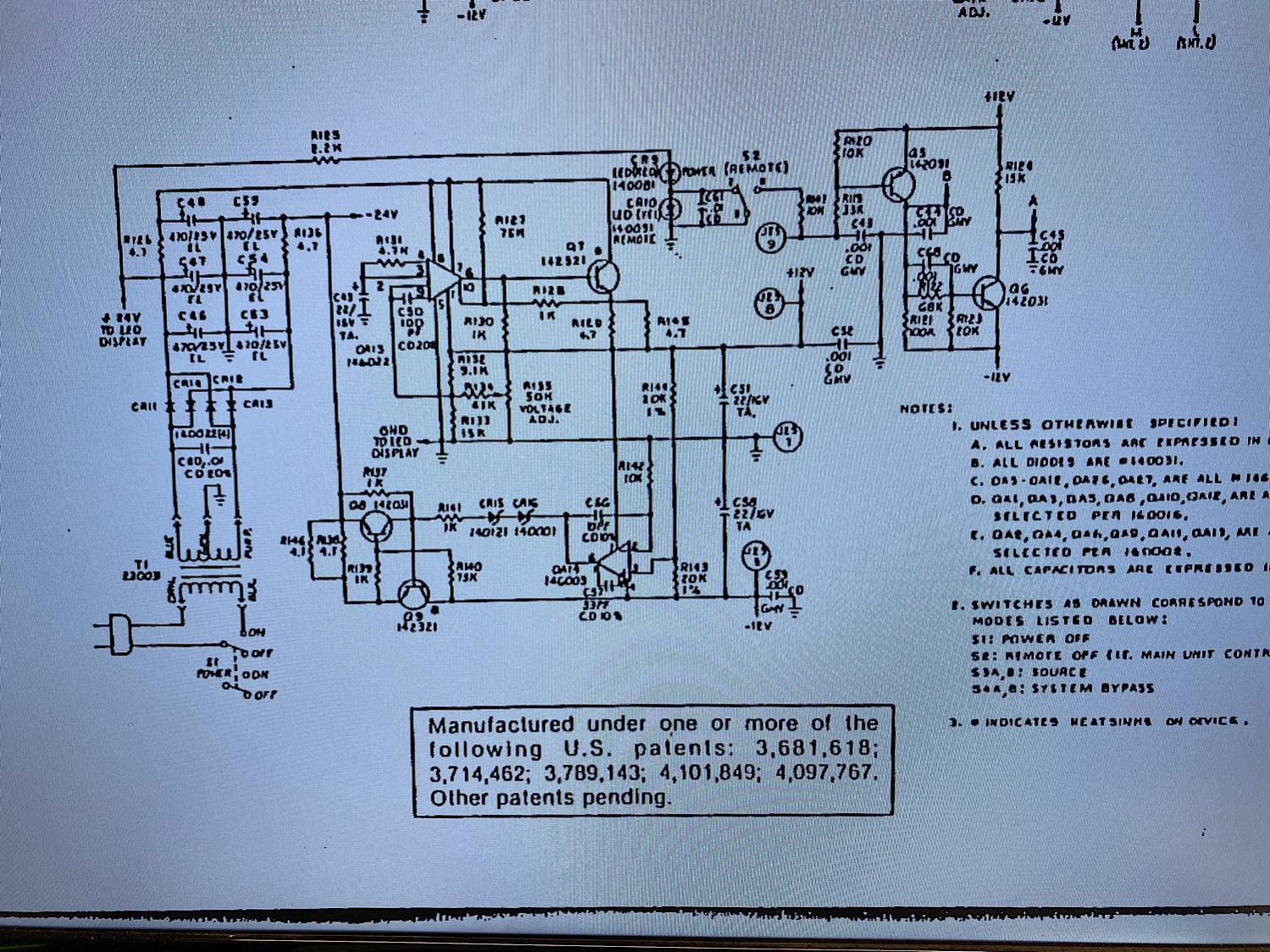

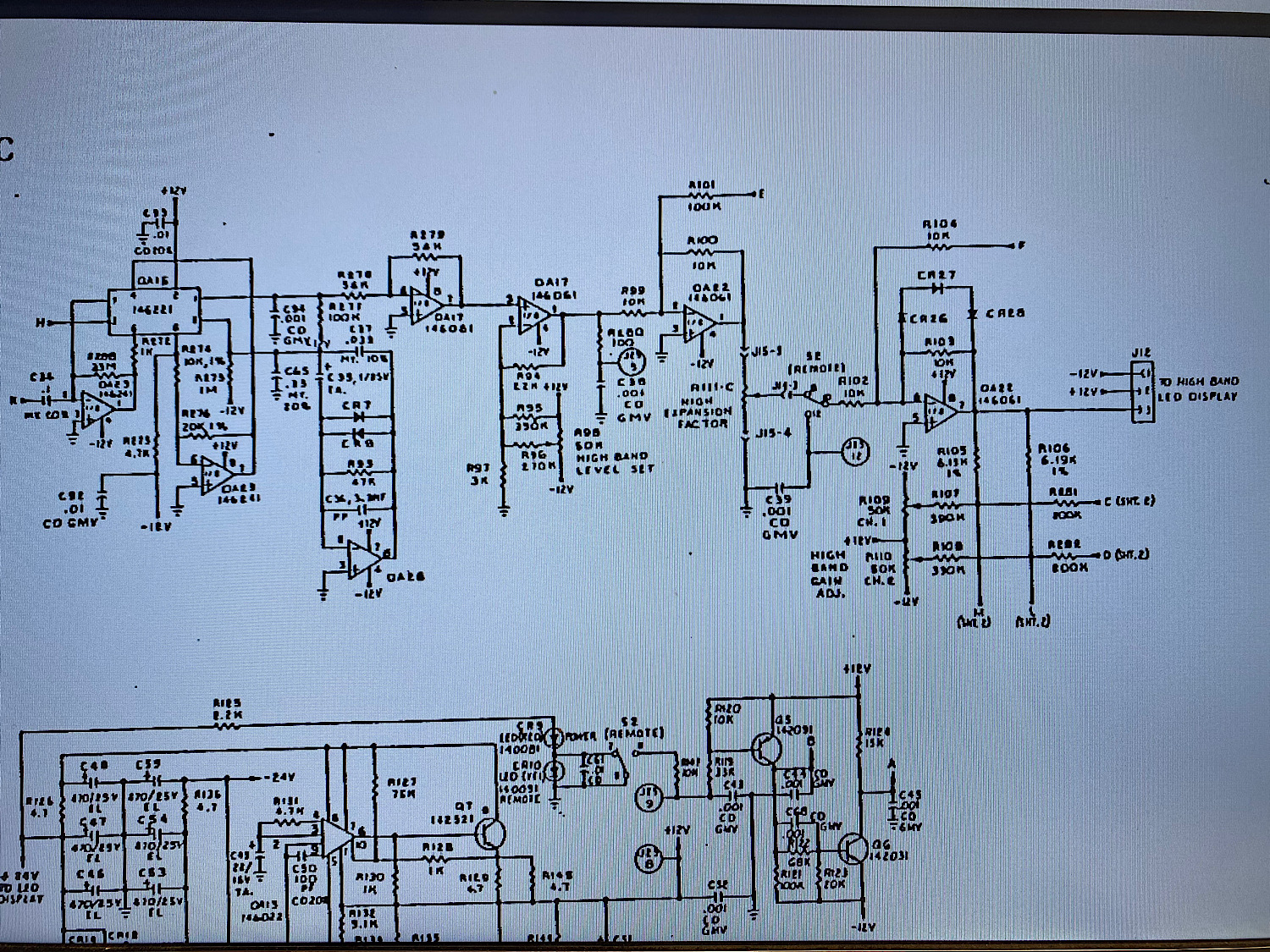

Is link a schematic, but the only one I can find isnt the best quality and needs to be zoomed in on. The images I post get fairly degraded.

The best I thought I could do was to bring the schematics up onto my computer screen and snap of pics of it that way. They’re difficult to read.

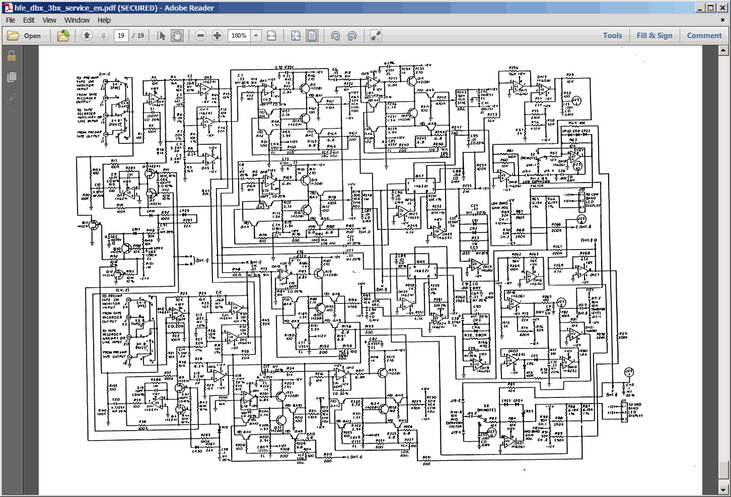

The best I thought I could do was to bring the schematics up onto my computer screen and snap of pics of it that way....
Or post a link:
DBX 3BX Dynamic Range Controller Manual | HiFi Engine
There is a cursor-tool in Adobe Reader which will grab images.
Or use PrintScrn or screen grab:

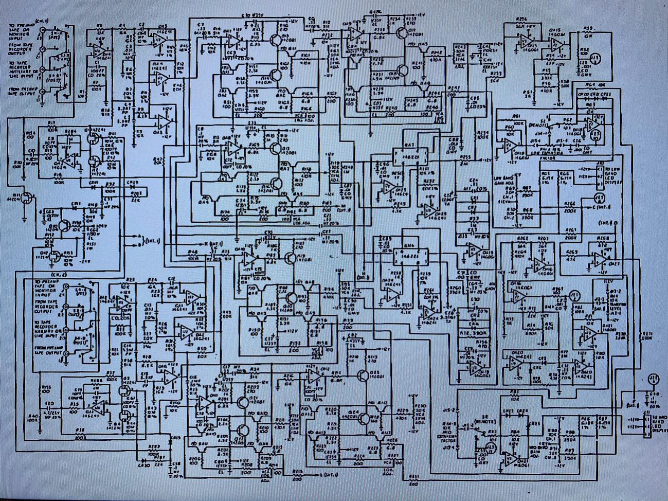

By looking at the schematic, what devices would benefit from being changed? Should I do all of the LF353N? All of the RC4558P? Should I get some OPA134 for the LF351N?

Is anybody able to look at the schematic at determine what device numbers should be the ones replaced?
