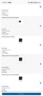

These five from Vishay for example I can get. Perhaps they are similar to IRF510 recommended by Zen Mod. The others I haven't researched yet, but surely where there's a will there's a way. And anyhow, just because a specific transistor is unavailable, does it really mean that no substitute is worthwhile, no substitute is worthy of the amp? I have more or less no JFETs or MOSFETs at the moment except buz90 I bought in a hurry just in case I would need to test some circuit and would find myself without any mosfets. Also, I'm not sure if they are useful, but I can get these JFETs in the picture.
Somehow, I'm pretty confident I will find something. Europe is not Africa and even if so, nowadays global shipping exists.
As for what I actually need, I'm leaning pretty strongly towards F5N right now and will soon probably start looking for parts. If I still find myself obsessed about something after building it and enjoying, I would continue on to try and build something like M2 or Aleph J, something single ended. Perhaps another Aleph, but the J is getting most praise usually and ITT too.
