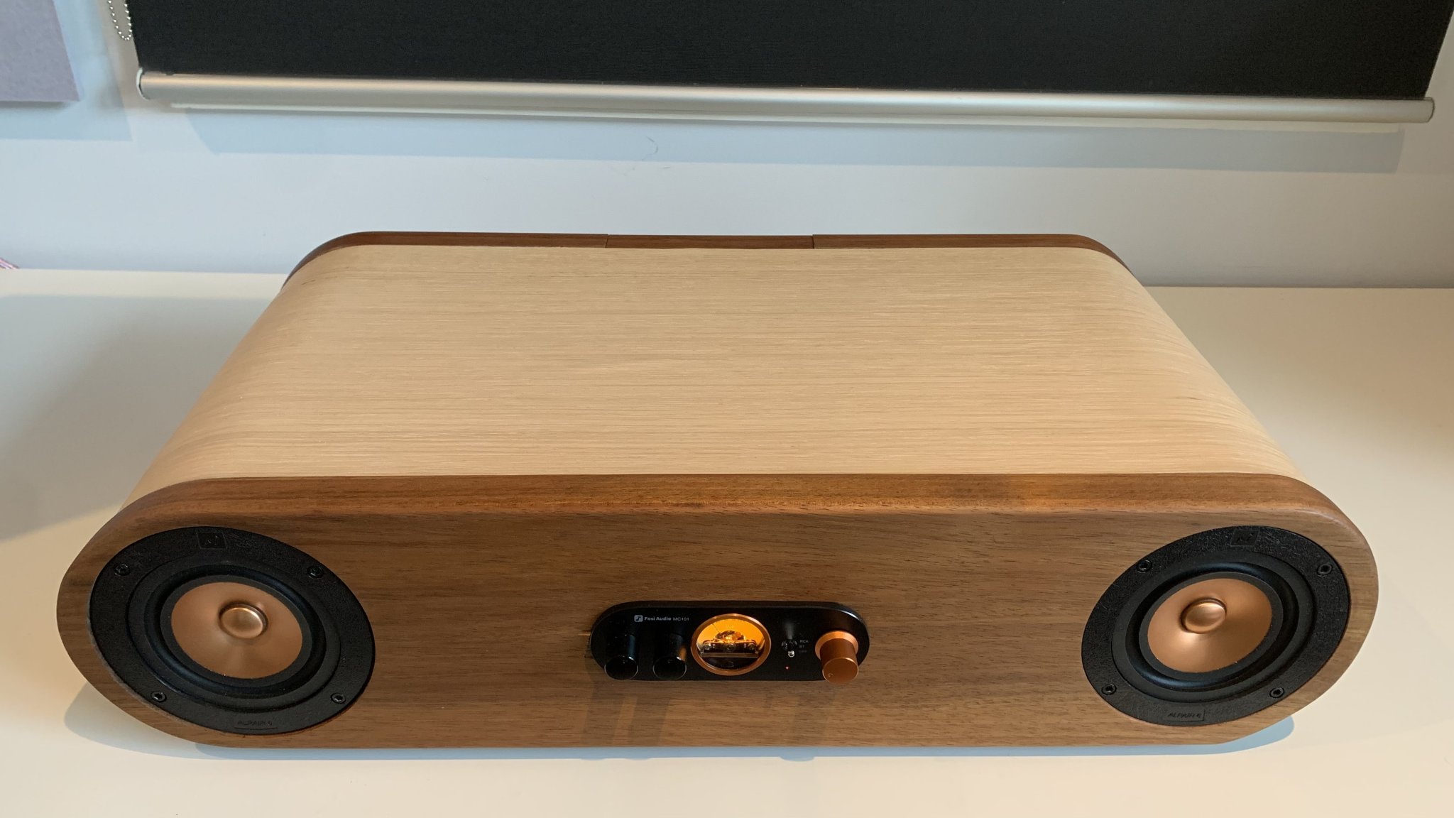

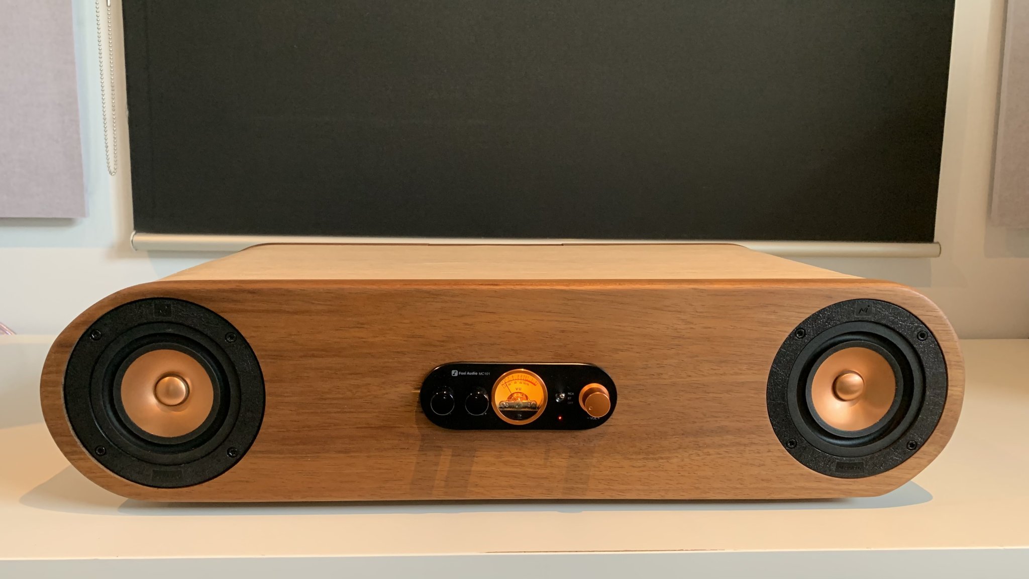

First pics of the finished result - the 'Tassie Devil' home streamer. Named after the well-known and often boisterous Tasmanian devil marsupial, since Tasmanian wood was used for the body (Tasmanian oak veneer) and front and rear panels (25mm Tasmanian blackwood). Both set off the drivers and amp well, I think.

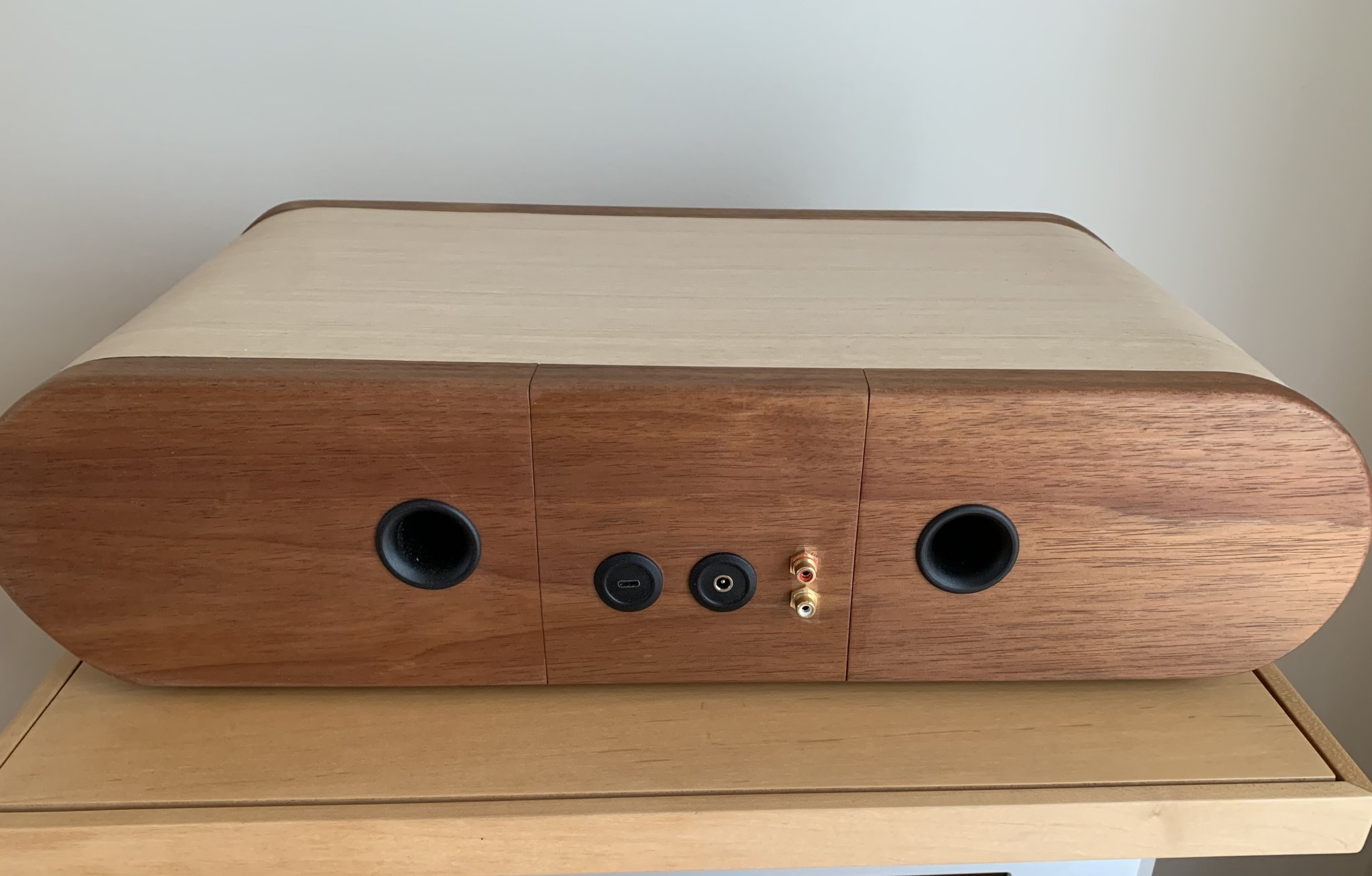

Still breaking in the 6.2s but early results are very encouraging - punchy but warm bass, clear mids and smooth highs. The Fosi amp is driving the 6.2s nicely and the Wiim Mini sits inside the box under the amp. Twin power inlets at rear for amp (24v) and streamer (5v) with rca aux input in case an external source is used. Removable rear panel to amp section held in place by baby round magnets. 9.5mm felt inside, currently experiments with amount and placement of the felt since the curved ends seem to do most of the damping and little extra damping is required on first listenings. No audible downside so far to having the drivers at each end. Will do some more testing in the days ahead.
