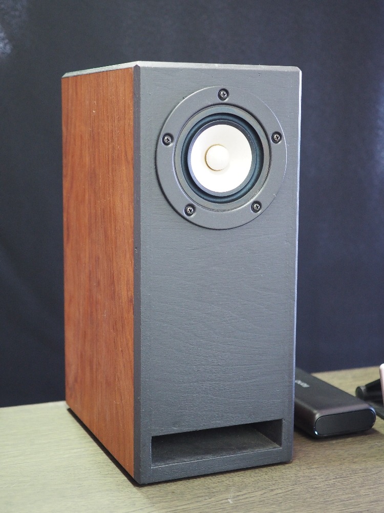

I have played various drivers with the SMSL A50 using the same TPA3116 x2 as the Fosi Audio MC101.
There is nothing wrong with MarkAudio and a Class D amp. In fact, it's so good.
CHN-50P is recommended for making compact integrated models.
I paired the phone (Bluetooth), SMSL A50 (using mobile battery, 20V, 5A), and CHN-50P and it sounded very good.

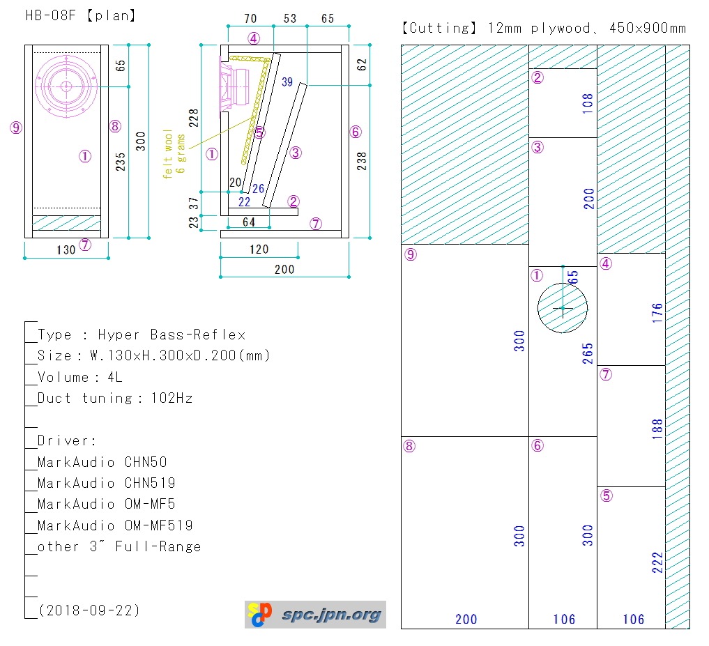

The box is a 4L double bass reflex.

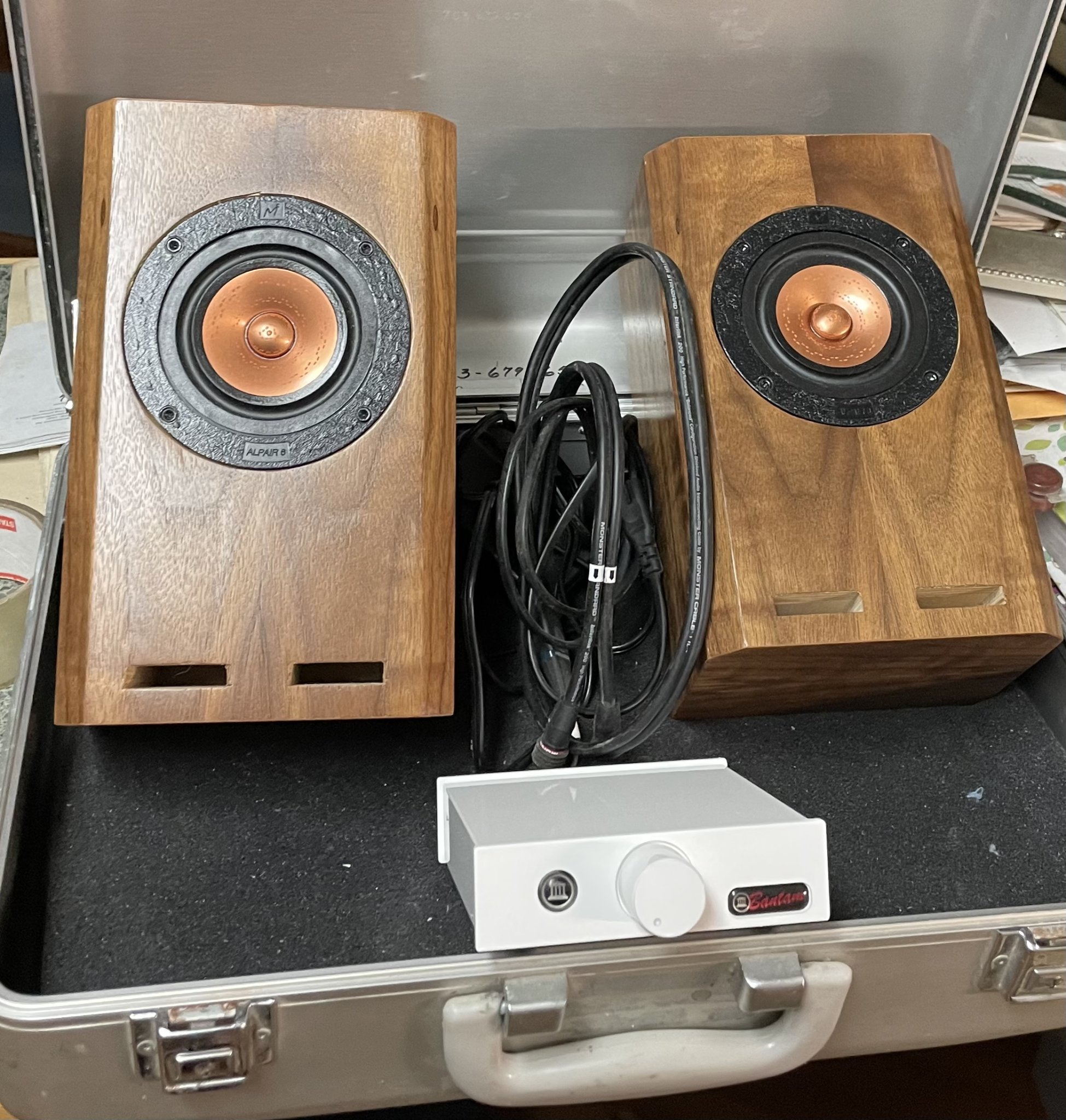

I've got A5.3 in 4.4 liters tuned to 58Hz (with some dsp to fill out the low end) driven by an MA12070 based class D amp for desktop speakers. Phenomenonal sound with surprising bass. They won't bring down the house dB-wise, of course. But they're more than loud enough to fill my home office.

In a reflex, it is the volume, shape doesn’’t play into it until one dimension becomes significantly larger than any of the others.
The second generation Alpair 6s, like the A12pw, were underapprciated and sadly have gone away. A6.2m is sort of a sweet spot between the 3” A5 and the 4” A7.
My miniOnen alignment maxes out at 3.6 litres but also requires a slot vent with high R (we quit using plumbing pipe a long time ago). The alignment doesn’t go the lowest but is noted for its finesse and elegance as low as they go. Mine are in the universal A6.2 2.5 litre enclosure.
Should be noted that materials thickness contributes significantly to gross volume.

With reference to your first post, where you have mentioned that your target dimensions are 600mm x 300mm x 200 mm. With 15 mm ply for cabinet walls, that leaves approx 26 liters of internal volume. Understand that some of the internal volume will be reduced due to cabinet bracing and the space needed for the electronics, but should still leave you with 23-24 liters? May I ask why you are thinking of getting the drivers housed into 4+ liter boxes?
With 9-11 liters for each cabinet, you should be able to use a larger driver capable of more low frequency output vs the Alpair 6.2M. Only worry is that the 2 drivers still be quite close given the 600 mm width limitation...

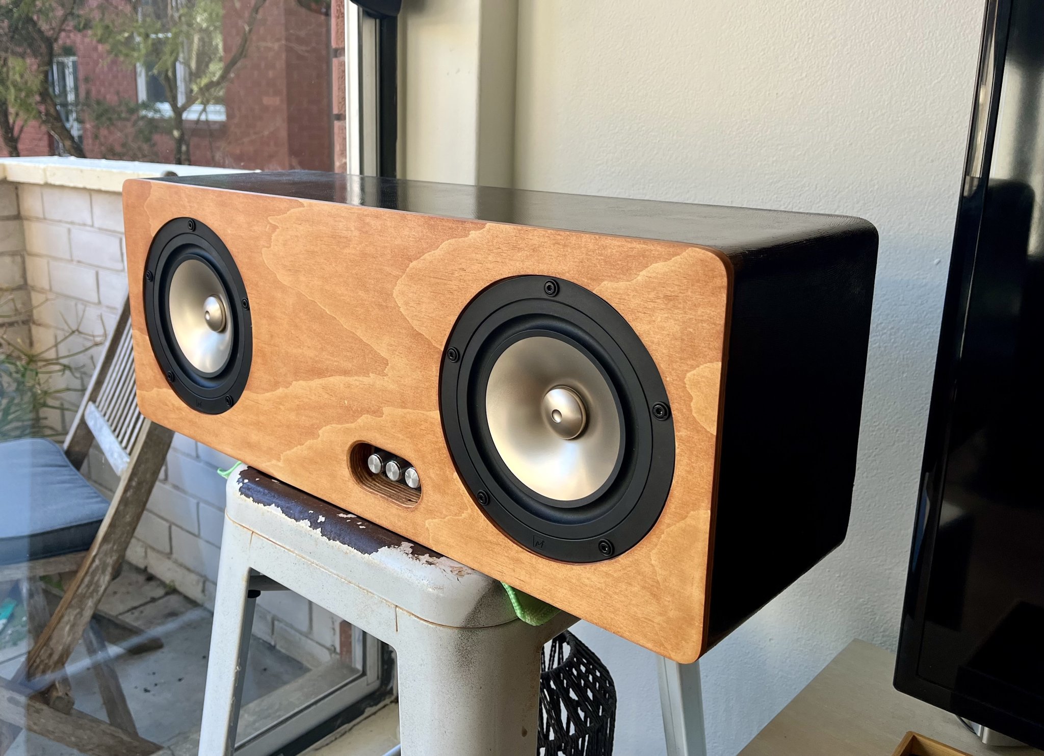

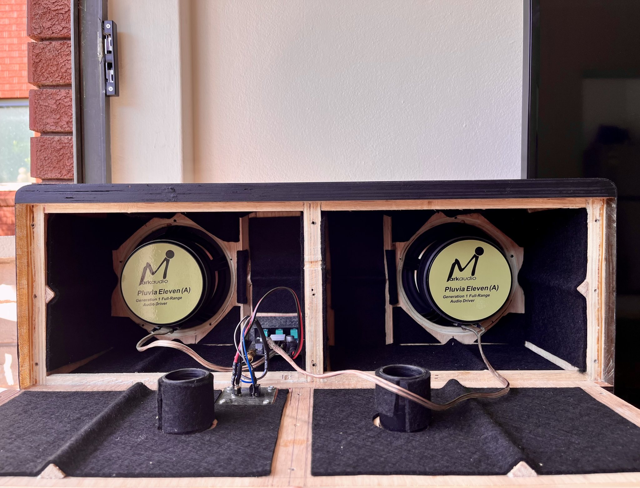

I embarked on a similar project in 2022 and after much deliberating landed on what is pictured below, with success.
This is Pluvia 11s in the Compact Monitor 0v8 enclosure back-to-back (610 x 225 x 185) with a simple TPA3116D2 board (has bluetooth too!). Darcher appears to still stock the P11s locally 🇦🇺 which are available in gold. Perhaps call Dan, his website is a mess.
There's other options that use smaller MA drivers but larger boxes, so... I'd honestly save yourself the hassle and just do what I did, unless you want to go much deeper in to the R&D for this exercise. If you want punch then this is the way to go. Avoid smaller.
Stereo separation is as good as you'll get given the size constraints and using FR driver's also has limitations depending on what genre you're in to. This is a form-factor and design goal that has compromise in it. Don't expect it to blow you away.
Tip: I also added some stuffing and eggshell foam the the rear panel which improved the tone markedly.
