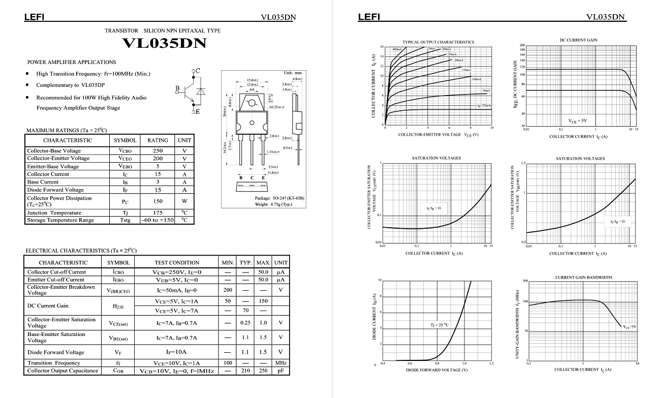

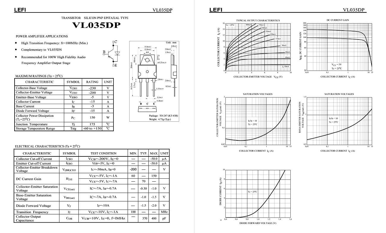

Russian transistors VL035DN & VL035DP with Ft = 100MHz developed quite recently this year.Which is the fastest NPN/PNP pair power transistor for output stage ?

http://forum.vegalab.ru/showthread.php?t=92554
For your experiments with the output stage, it would be interesting to compare with other powerful transistors. And suddenly they will surpass the Japanese counterparts.
There is a comparison of MJW3281D+MJW1302D with VL035DN+VL035DP in terms of switching distortion.
http://forum.vegalab.ru/showthread.php?t=12016&page=53&p=3043881&viewfull=1#post3043881
Also, some people already use them in the output stages of the amplifier.
https://zen.yandex.ru/media/prophet...-202122-gg-vypuska-62f6236e324aad4233e6c02f?&

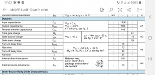

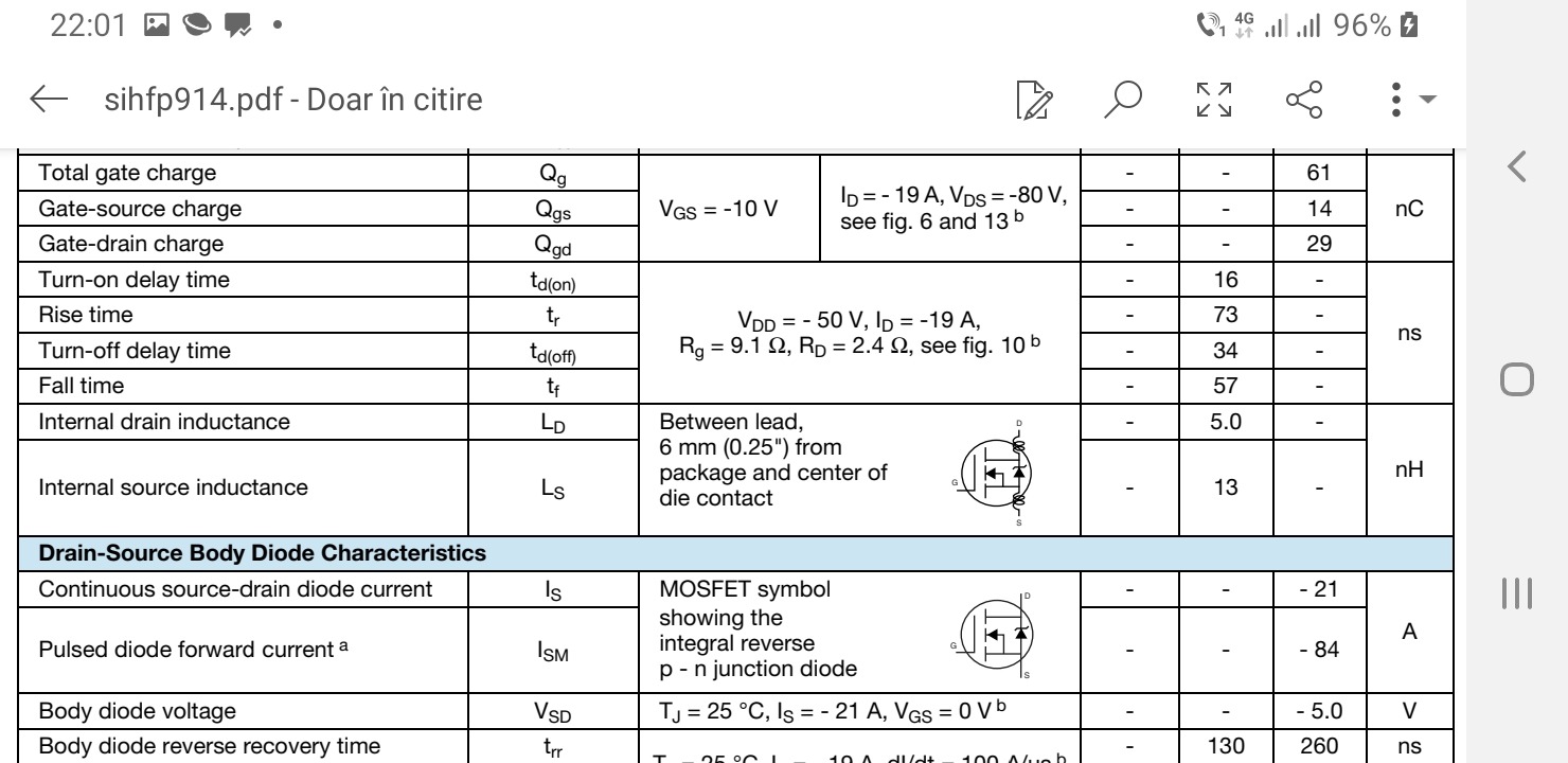

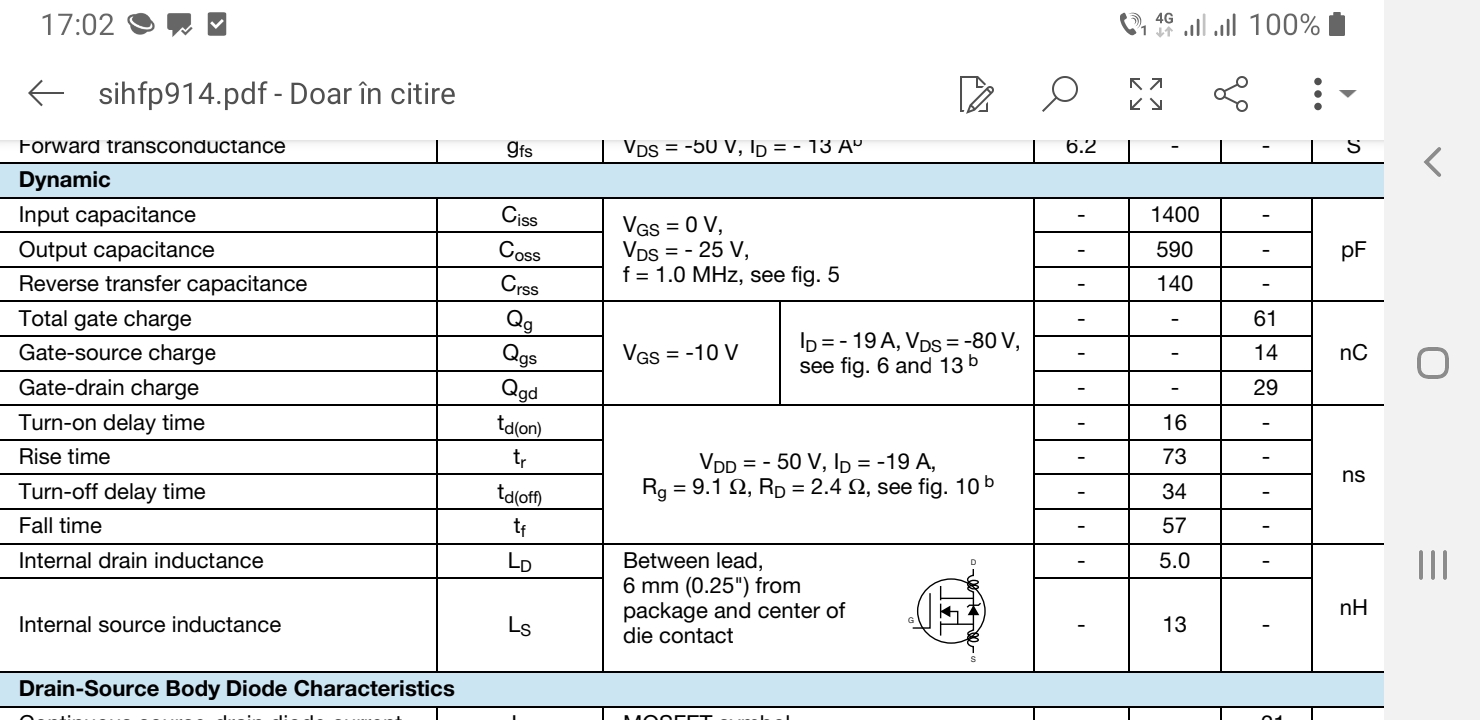

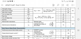

If I remember just older common Mosfets like IRFP140 , IRFP9140 get close to 240/260 Mhz

Good luck with charging and discharging them fast in linear circuits!If I remember just older common Mosfets like IRFP140 , IRFP9140 get close to 240/260 Mhz

Yes, I would like to try them. It would be nice to compare in an identical setup. I sent him a message.For your experiments with the output stage, it would be interesting to compare with other powerful transistors. And suddenly they will surpass the Japanese counterparts.
The pictures by bukvarev in the thread you linked show problems at switching: there should be one spike per crossover, and his scope shows multiple spikes. This looks similar to what happens with inductive emitter resistors. Or perhaps it's the layout, as he says "the layout was the limiting factor". In any case, it's not really possible to draw conclusions about the transistors when this happens.
They will not be useful past 10MHz due to package inductance.If I remember just older common Mosfets like IRFP140 , IRFP9140 get close to 240/260 Mhz

Nice.Yes, I would like to try them. It would be nice to compare in an identical setup. I sent him a message.
