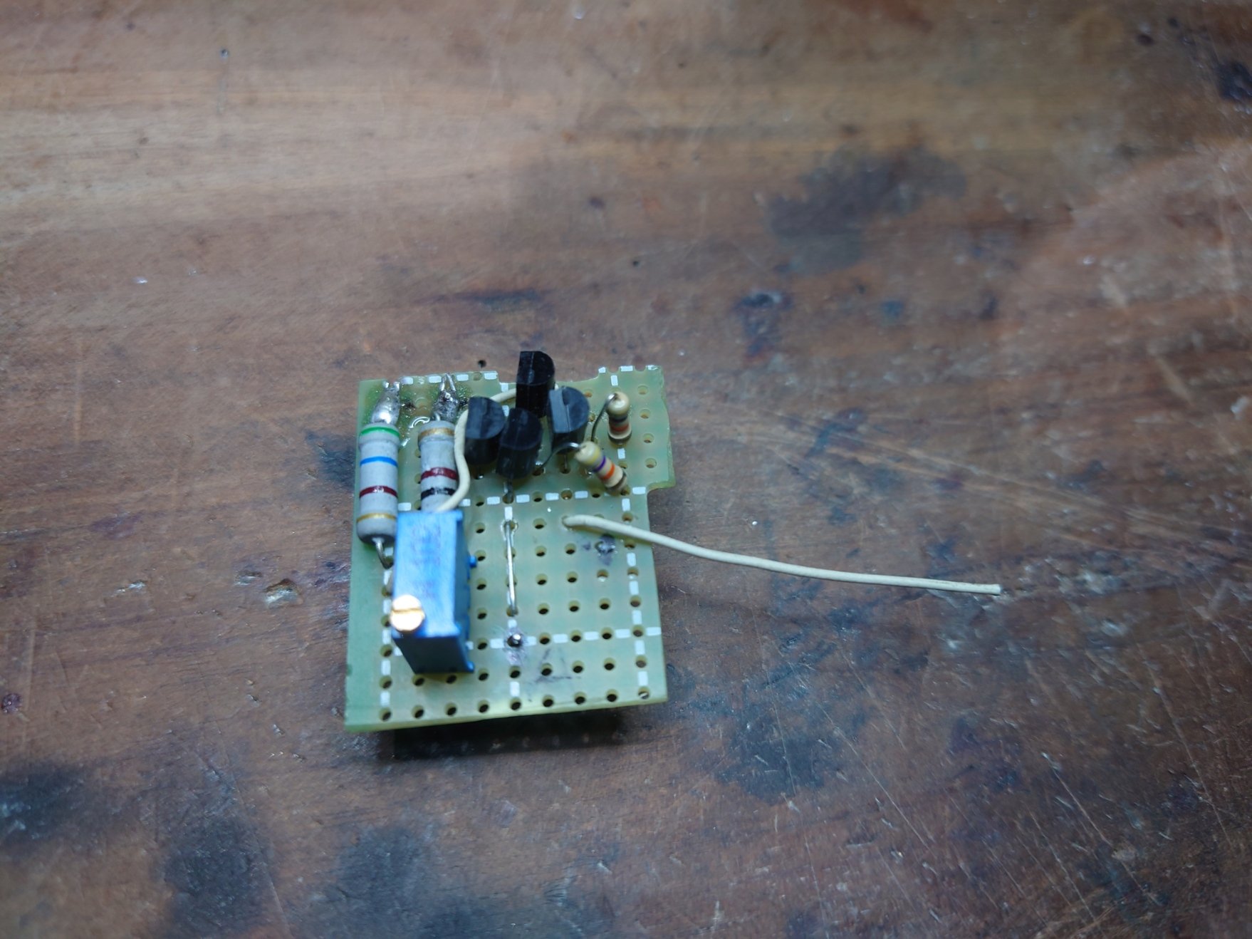

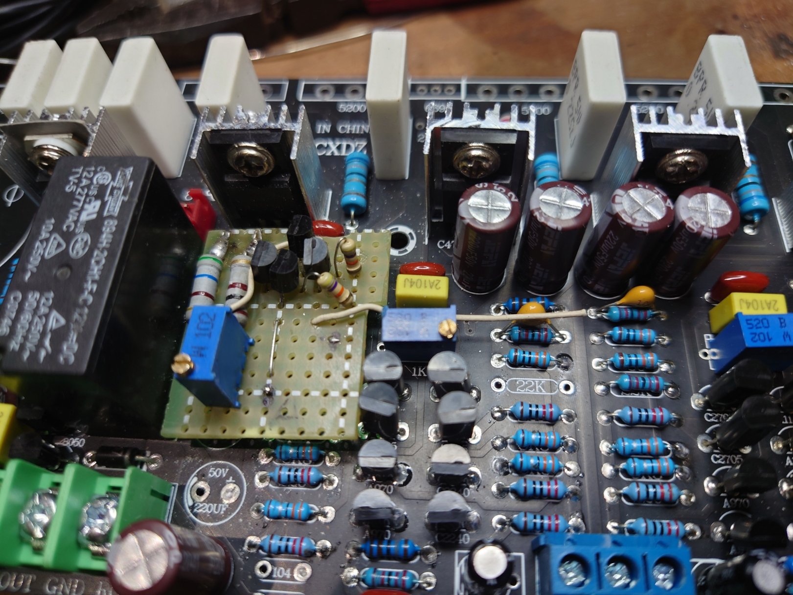

Hello There,
I have just got the result as the diagram... now need to check the sound quality or I will test with oscilloscope, few months ago I bought that toy... but still not use it!! 😀 any way thank for your kind words. 🙂

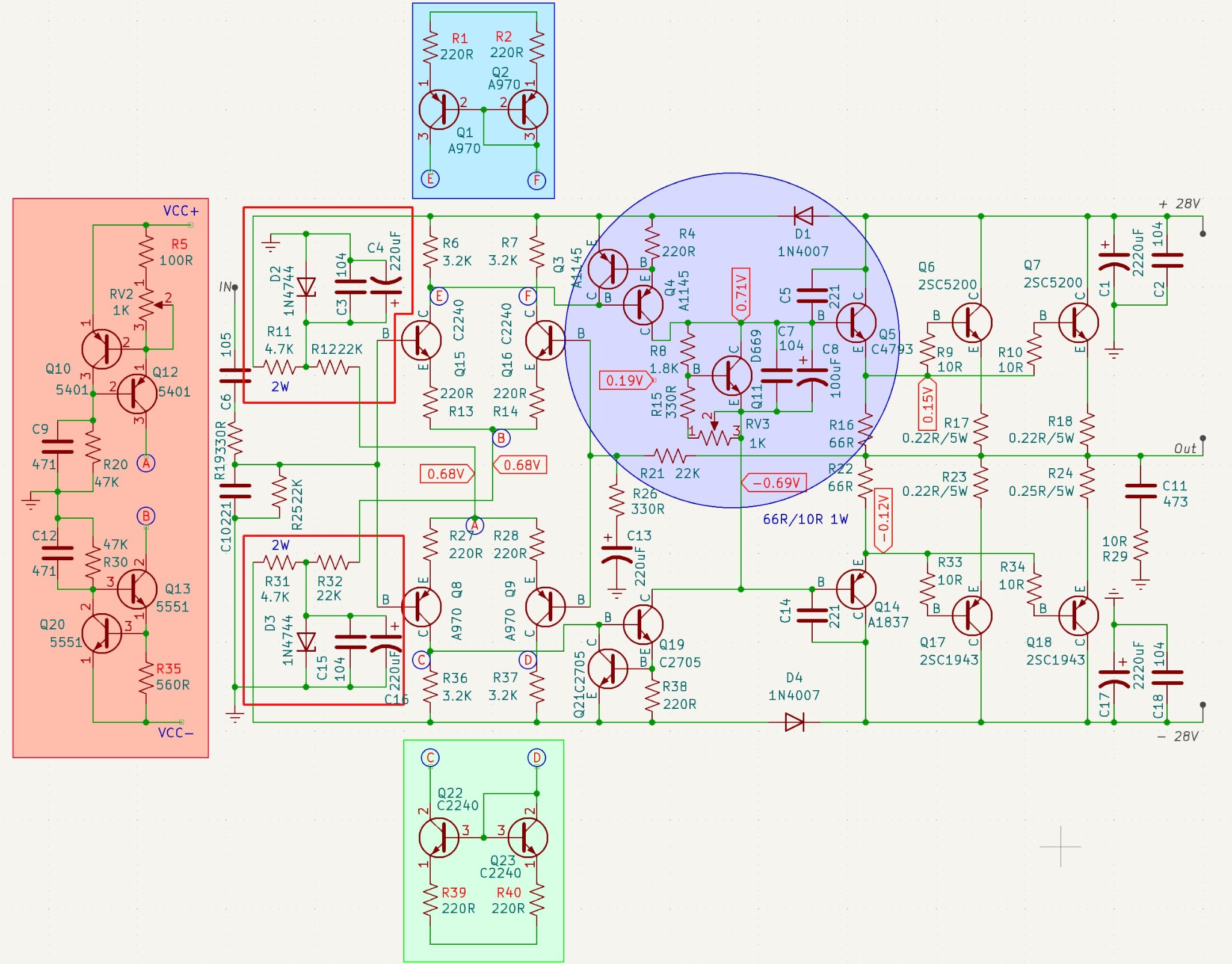

The PSRR of a simple zener plus resistor current source is quite high
I don't really understand this, but perhaps because I'm not referencing the circuit correctly..
From the pic in post 18, there's a 15V zener stabilised circuit above ground, which feeds via a 22k resistor to the lower LTP, sitting on -28V. So the +28V rail is isolated - but when the -28V rail starts flapping about (for whatever reason), doesn't that effect the LTP ?
A CCS of 2 BJTs would be sitting at +28V, but providing a constant current whatever the rails do (subject to speed, the zener is faster of course). But maybe the constant current has issues as the LTP is sitting the -ve rail, so that's following the -28V anyway.. ?
Perhaps the answer is that the LPTs should also be standing on the stabilised zener points? So the LTPs both see a stable +15 / -15V supply, and are therefore isolated from the main rail, both of which will be bouncing around with the music anyway.
Either is plenty fast for audio - this isn't an RF amplifier we're talking about! My immediate comment is that the limiting factor for linearity seems to be that the long-tailed pairs have resistors as loads, rather than current mirrors, so will likely have a lot more even-order distortion than they could have - I believe this might be a larger problem than the long-tailed pair sourcing - it would be interesting to simulate.
Collector- base capacitance (and to a lesser extent collector-emitter) limits the output impedance at high frequency. Which is why you still want to use a good VAS transistor to load the VAS, and a small signal device for the LTP’s tail. No TIPs. Use the appropriate transistor, and it generally pushes the effects out of band.
The PSRR of a simple zener plus resistor current source is quite high and in a practical application as good as a two transistor or diode-transistor CCS, and it is very wide band. I show the sim results in me e-Amp write-up on my website.
Tried and failed to find Bonsai's article so I'm not sure exactly what he tested. In any case, it matters that the CCS transistor has a capacitor decoupling at the base, both for noise and HF impedance.
Could you draw this out please? There are two transistors, and I was under the impression that the transistors had to be free to 'move', to correct for voltage variations affecting the current.
