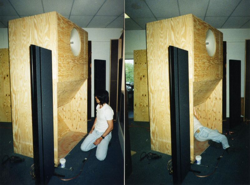

The first pic you posted - That type of horn looks pretty perfect for a home theater app. Just place them wall to wall and put the screen in front.

😎 Those main horns make the screen look small ! How big is it ?

Back then I used a 7' 4:3 screen - now I use narrower speakers and built a 10' screen.
I believe if you build a horn for the deep bass you should use the room to it's full advantage - 1/8th space loading (corner) is a big plus and normally will use up less living space. Eq is fine as long as you don't over drive the driver and expect miracles with too small of a horn. My triple subs use a lowpass single pole lowpass at 30 cycles built into the front end of the bass amps. The JBL 2242's in the three horns have a combined sensitivity of around 112 db/W/M at 20 cycles. They are AWESOME basshorn drivers! I use 220 watt watts/ three channels with a mono input to all three horns, plus use a Paradigm X30 with variable low pass and 0 to 180 degree phase adjustment infront of the amps to fine tune to the main speakers. It will reproduce a thunderstorm with little to no compromise. It can be scary - the air pressure in my room can be overwhelming.
