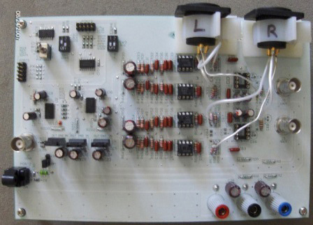

I definately liked the AKM4396! An excellent DAC and easier to implement than the AD1955 since no microcontroller is needed. The AKM4396 is less analytical than the AD1955 and slightly less detailed. Both chips throw a nice sound field and the image wonderful. Depending on the source material, they both imaged beyond the right and left speakers.
For the AKM4396 I tried a number of the commonly used opamps discussed on this site as replacement buffers, but the 5534 still sounded the best that come with the DAC eval board. I did hack the eval board for balanced output. It was a simple mod of unsoldering one side of the resistor legs on the output from the balanced output opamp filters and attach xlr connectors. The remander of test system is all Pass Labs and I'm only interested in balanced interconnections.
There is room to mod the AKM4396 eval board with higher quality passive components. The AD eval board was maxed out with panasonic caps, yageo and vishay/dale resistors. very nice! The I/V circuit consists of 4 AD797 opamps. The AKM board sounded very relaxed to such a negitive degree when AD797's were used for the filters. Again I tried just about everything, and the 5534's sounded the best on the AKM. The usual 5534 complaints were not present inthe sound.
The AD board uses surface mount opamps, but there are also through hole pads for replacement opamps for direct soldering or adding sockets for experimenting. The AKM board comes with millspec sockets from the factory.

Checkout the AKM website. They have the full schematics for the AKM4396 eval board. I tried all the popular opamps as filters, and the NJM5534D is the best sounding opamp for this board. The 5534 makes some folks cringe, but it actually sounds the best with this chip. The eval board is not very expensive, and AKM has done a lot of work getting the ground planes right. I did hack my eval board to for balanced xlr outputs.
Attached is a pic of my modded AKM4396 eval board.

dw8083 said:Checkout the AKM website. They have the full schematics for the AKM4396 eval board. I tried all the popular opamps as filters, and the NJM5534D is the best sounding opamp for this board. The 5534 makes some folks cringe, but it actually sounds the best with this chip. The eval board is not very expensive, and AKM has done a lot of work getting the ground planes right. I did hack my eval board to for balanced xlr outputs.
