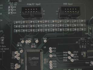

You need to contact Analog Devices salesforce directly. The board is unbelievable. I was better than my Lavry DA-10 and other highend DAC's I've tested. It has the biggest soundstage and detailing I've ever heard.
One other cool aspect about their eval board is that all digital signals are available on header pins - DSS, PCM, I2S, etc. One of the more flexible boards I've evaluated, great for DIYers.
