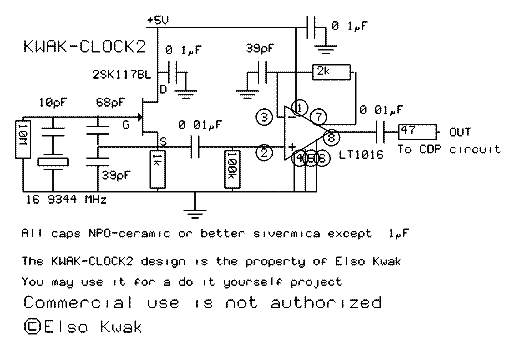

For the DIY, the simplicity of the clock circuit is the most important thing! The accuracy is just as important as the simplicity and second best thing (for me it is)is the price of it.
I've used the Tend clock (€27,= vertion) the LC Audio XO2 and the KC-7. The last one I've build myself with a nice PCB from Elso.
The Tent one, I've lent from a friend in Leiden (Holland), (he wanted to find out if the KC-7 was as good or better than the Tent) was just very simple and O.K! The XO2 LC Audio, came from st. Pete Florida, again a good friend of mine.
My DIY forum members, this is the result.
I'll start with the less good one.
The LC Audio XO2. this one is so nice build that you'll be sure it'll be the best one of all, but the opposite is the case.
The Tent clock is a very simple and good clock (goed zo Guido)!
The best one was, and still is, the KC-7 due to it's building guide, simplicity, accuracy and price. The feedback you get from Elso is just tremendus, (Ga zo door) the KC-7 can be bought in various version. The DIY one with all parts included. The PCB only the Parts only and the complete (build and tested) version.
And that's what I call service. If you are a Pro or a newbee, the KC-7 can be build and installed in your CDP,Transport or DAC.
Guido, I'll order the €130,= version next year and report to all DIYAudio.com members. To bad I didn't have it to compare with the other ones, I'm unemployed at the moment and don't have the $$$$ to buy one.
But I'm sure it's a good one!

The answer is..........42!
Not really, but:
First, the clock has to be able to fit in one's budget.
Second, it has to have low jitter.
Third, it won't have low jitter if you power it with a noisy supply. Ditto for the circuitry that squares it up. Won't matter how good your oscillator is if you stick a lousy PSU on it.
Comparators have been used in telecom clocks for many years. Maybe Lars just got lucky.
Maybe not.
No more design hints for for El-Cheapo Audio.
Jocko
