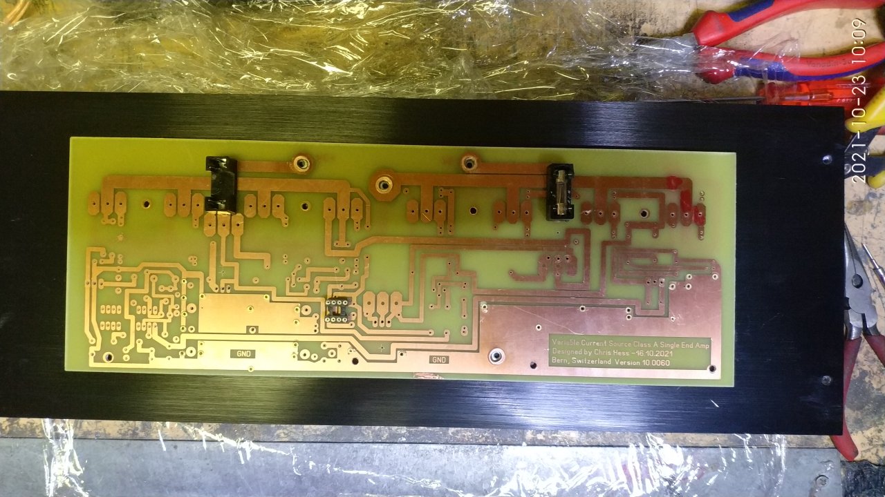

While assembling I leave that Photo positive layer on.
When finish I clean the board with Isopropanol 2, and afterwards I use a protection lacquer spray to keep copper clean.. that way it also protects the solder joints.
When cleaned off I will place the board in the Baking Oven, for 5 minutes @50Degrees Celsius to get the moister out, and only then if the board and all the space between the components are real dry, then I spray the lacquer on..
I do this since 25 years like that, and on my last Thailand Trip, *2019* someone brought me back an PCB I made in 1995, to repair, and all what was broken, Solder got cracks and that's why there was speaker protection going on. So removing the lacquer, re-solder the PCB and then testing it and applying the Lacquer again, I think he was very satisfied with my work.. and everything free of charge. All my sold amplifiers from that time are covered by a Life warranty.. A friend of mine does the repair for me, as I'm not all the time in Thailand. the Lacquer I buy from Reichelt.de..

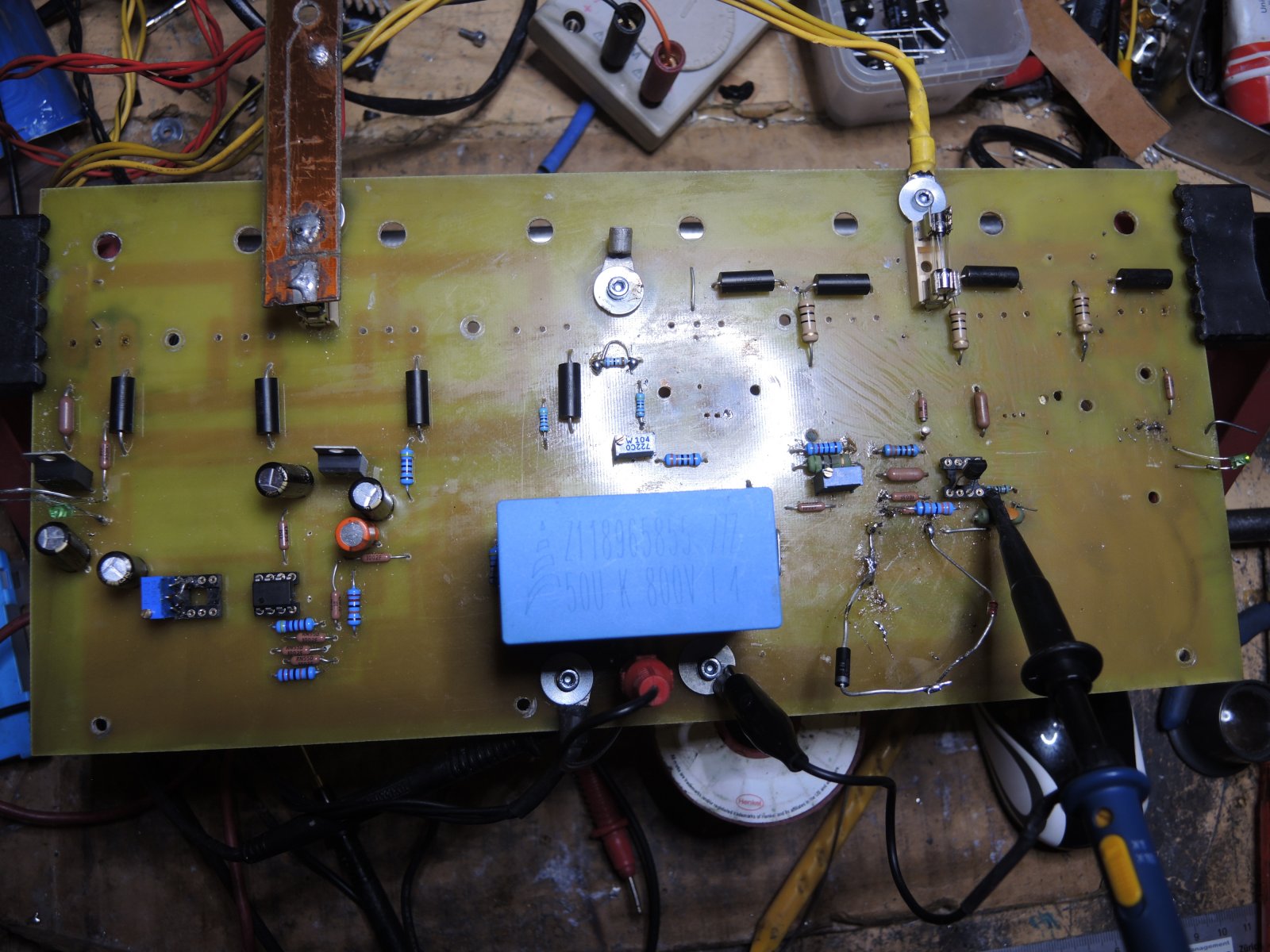

So the Board has been assembled to 90% and the next what will be done is intense testing.
1. Power Connections for rail voltages from 36 Volts to 48 Volts dual Rail
2. Regulator Testing for +- 18 Volts
3. Zener testing for Required Voltage of 30Volts +
4. Adjustment testing if theses work as desinged
5. Inserting the First Transistor, *Socket* and then adjusting the RB DC voltage to - 0.600 - 0.650 volts
6. Apply Signal 1khz Sine Wave to 250 Khz Sine wave and measure the output of the input stage. also same time checking distortion on the input wave form. How linear is the signal and is there any oscillation or noise..
7. Grounding the input and check of abnormalities
7.1 Cleaning the board on the copper side and protect it with some Clear Protective Copper lacquer.
8. Soldering the Power Transistors, applying heat transfer compound and then screwing these to the Heat Sink but not tight yet, first securing the board as well, so there will be no stress on the transistor legs, when actually fastening them with 2.2nm torque.
9. Installing Voltmeter - Oscilloscope, Amp meter and and signal source to GND
10. Switching on and select the lowest Power consumption I have simulated which would be 500Ma
11. Applying signal source and then checking out how much output power I will get with this. then increasing Bias Current to have the max power of 60Watts @8 Ohm (Not 68 as simulated) or before clipping and with less than 0.1% Distortion.
After that testing the last part with 4 Ohms and also 2 ohms..
READY
This all should happen this afternoon..
Get back then..

Hi Guys
Testing the Input stage did not pass. I do not get the expected Values.
As long as this is not solved I will not be able to install the output Transistors..
Because If I do, then I take a big chance that the Smoke doesn't stay inside the Transistors. (Speech Nelson Pass, BAF 2019) he just used it another way but it is definatley his speech,,
Sat quite a few hours but wasn't able to locate the problem.. we will see tomorrow..Voltage divider don't work as expected, it's 4:1 instead of 3:2.. Optimum would be 50:50 % but But it turns out to be 80:20 or as I wrote 4:1 Meaning I will not be able to adjust DC out at the speaker port.

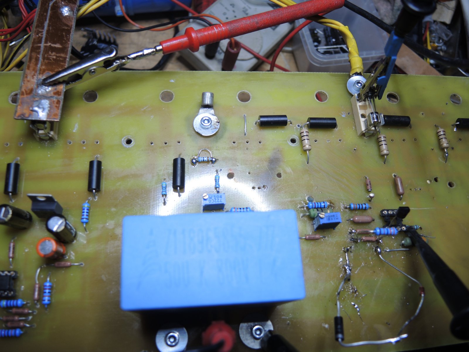

Hi
In the meantime I found the BUGS, which kept the amp from passing tests properly.
The main reason was a 100K Bournes Variable Resistor 25 Turns.. which had a somehow a connection problem on a certain position of the tab where it makes the dividing.
This kept the amplifier from distributing the IDLE current evenly and it was no way to start it proper..
Last night I had solved this problem and now Amp is working I can go over to next step testing. if the rest of testes passing then I should be able to give the amp try..
Thanks for reading.
Thanks for reading.

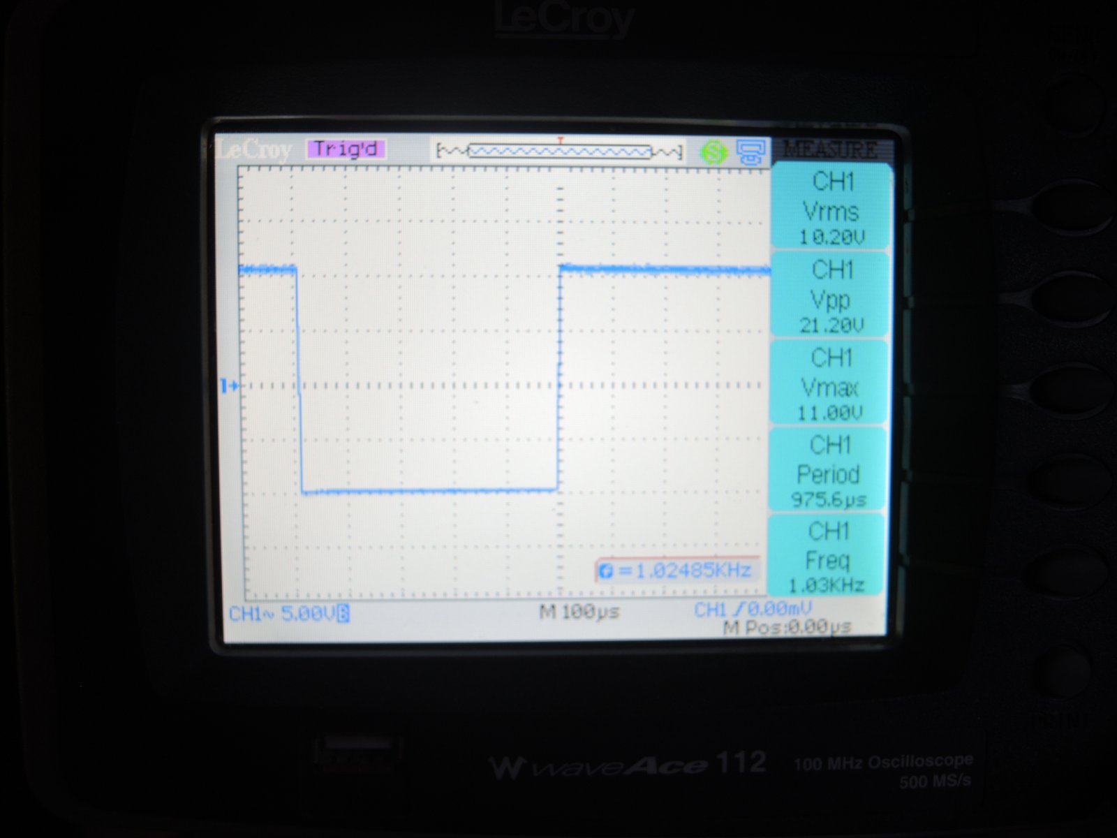

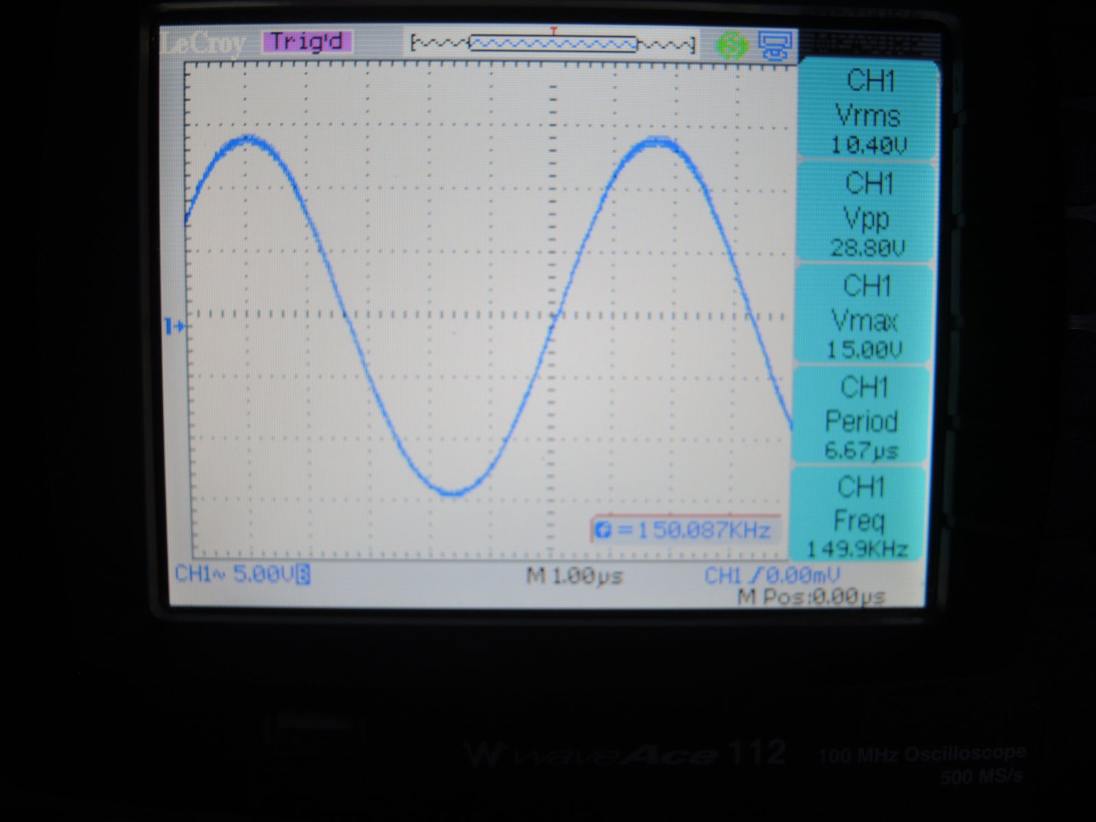

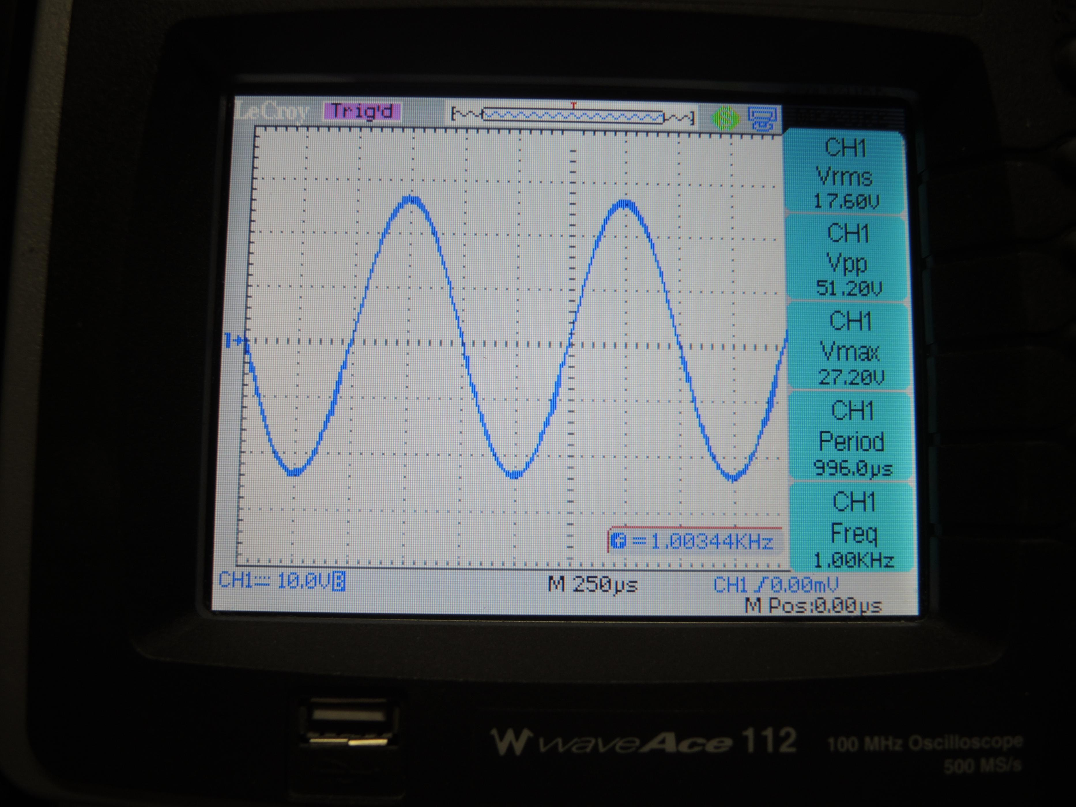

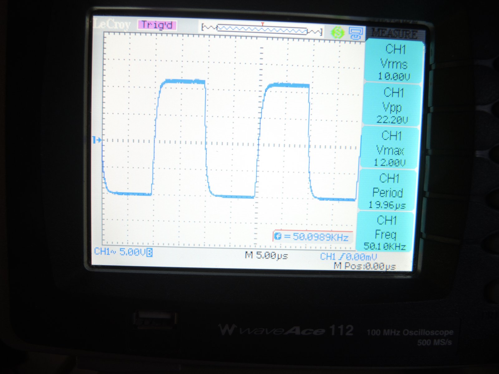

Prototype Variable Current Source Class A Amplifier
First off, just for everybody to understand this is a PROTOTYPE BOARD, to test the Amplifier before it is going to be build, with the real PCB..
And because of that some test haven't passed in the past days it looks how it looks..
There are some important changes since last night:
Test which are listed in Post 22 have all passed up to test Number 6.
Tests have also passed frequency response up to 250KHz. Distortion less than 0.01%
Also tested which is not listed above, is the SERVO CONTROL to make sure that output will be 0.00000Volts all time when amp is running within limits. I know it will be something about 0.05 millivolts up to 5millivolts.. but I can live good with that, because this is something very hard to be detected by human ears.
Now there is some mechanical Work to be done. I do not use conventional Heat sinks for the drive Transistors, so this will DIY heat sinks to have the Drive Transistors all on the same Temp this means one Heat sink for these three Transistors, this is what has to be constructed today.
Pics showing Input Stage, Sine Wave measurements @50 % also Square Wave measurements at 75%, then Rail Voltages a little bit higher than it will be when the AMP has it's output Transistors connected.. then Rail Voltage will be 76Volts or 38+ and 38-Volts.
Be back later as soon heat sink has been done..
Regards Chris

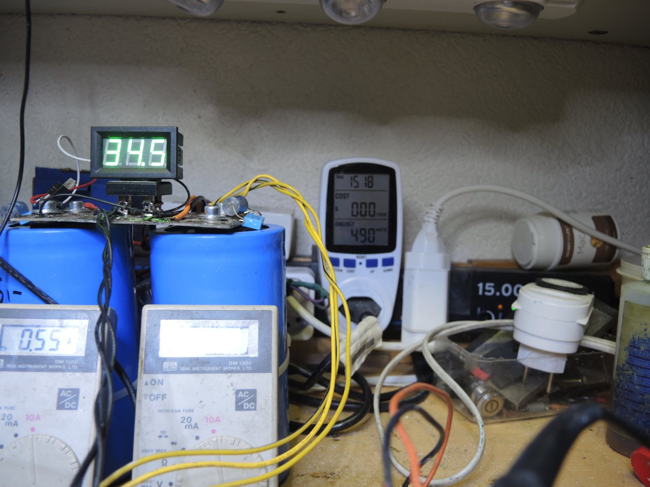

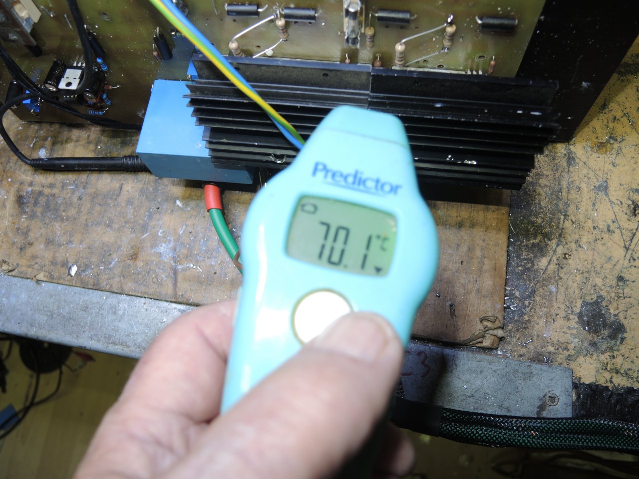

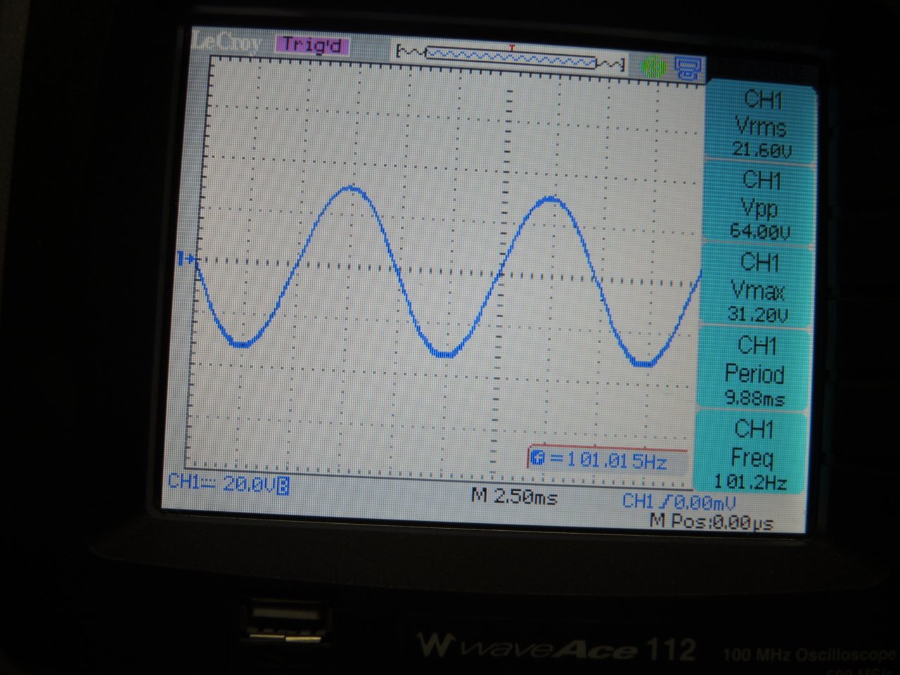

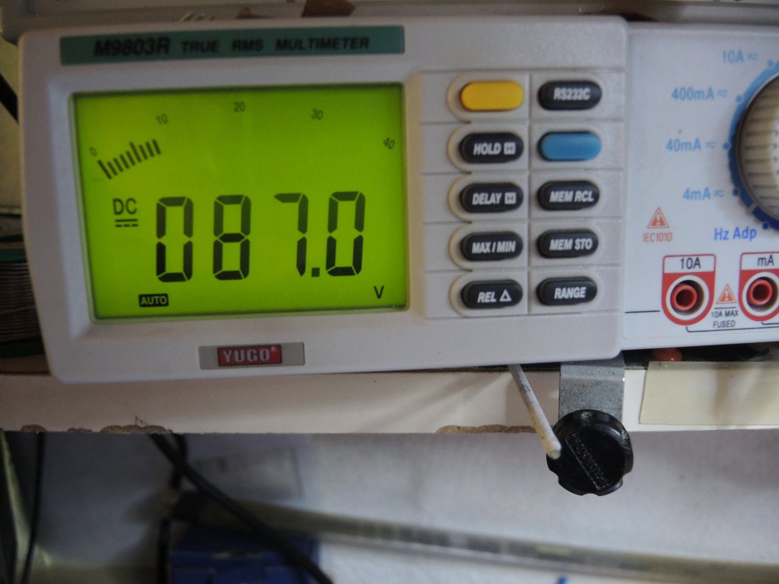

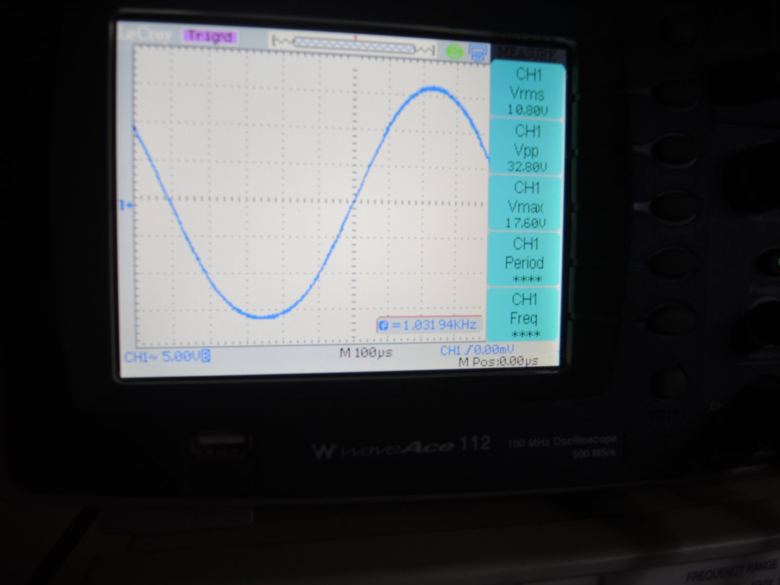

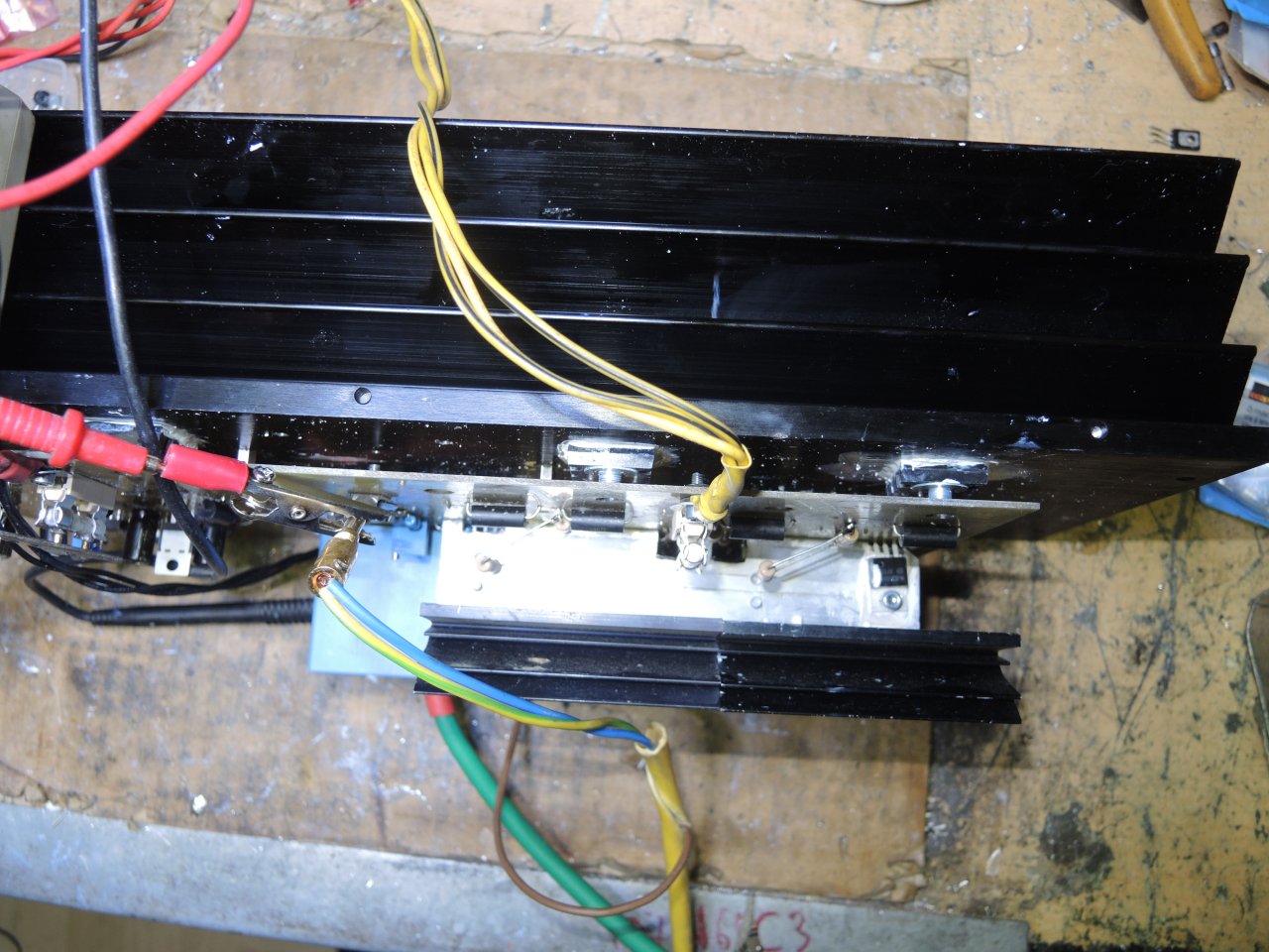

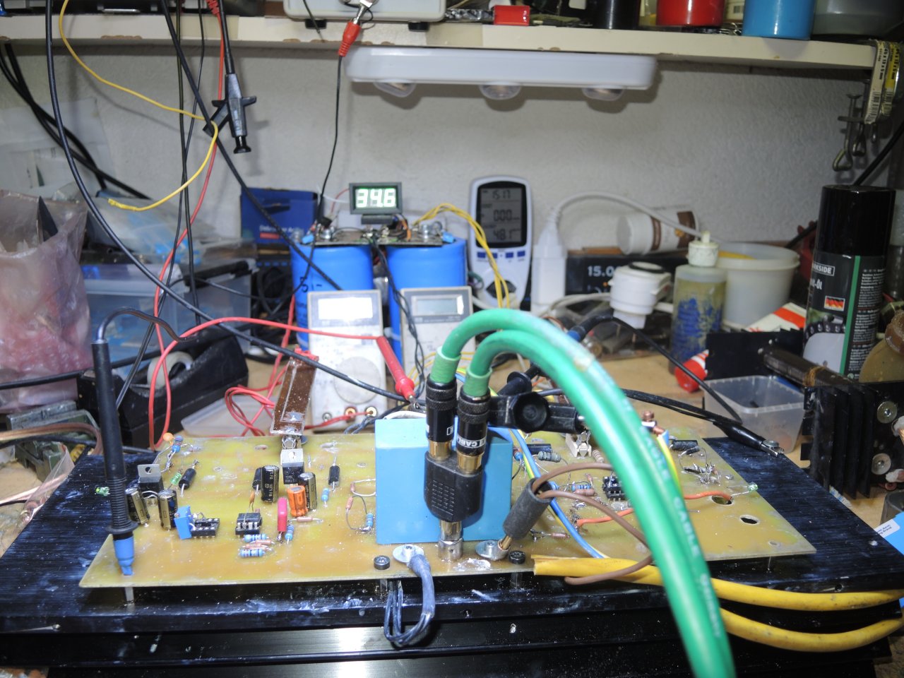

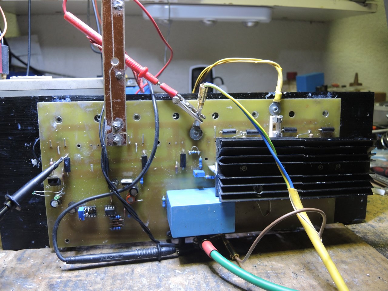

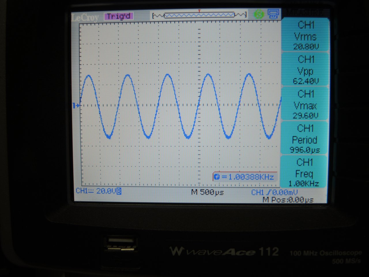

Hi guys
So, the Varaible Current Source Class A AMP is on.
Had a few hickups, but this is a normal thing when doing all DIY.
This is PROTOTYPE..
Here a few pics from today when I had some spare time to work on it..
Present time Max Output into 8 Ohms @ 1khz 20.8 Volts RMS this equals 54. Watts RMS, this also counts for all frequencies above 1KHZ up to 150KHz.
Lower frequenceys the Amp is boosting the signal by 0.8 Volts to 21.6 which would be 58.8 Watts RMS.
This is just a small thing to correct, as the input Cap is rather large with 50uf..
When the final PCB and final Circuit is made, which I'm still testing, then the AMP will be linear like 0.0 db 10 - 100Khz..
this all with a current flow of 2.33 Ampere, and idle is only 580ma.. this by +- 42 volts Railvoltage is 42 * .58 = 24.36 Watts IDLE Heat. not at lot for a CLASS A
Pics also showing some temps of the Drive unit and the output unit which is not fully installed only 4 output Transistors are used to test. Because all these components will be left on that Prototype.

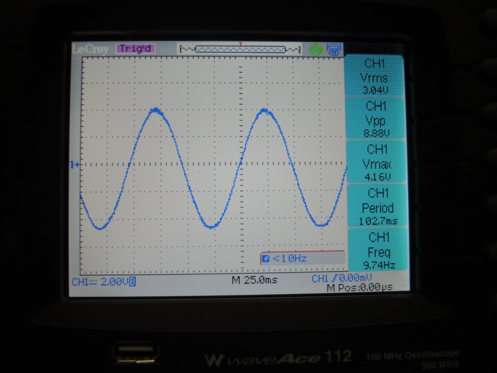

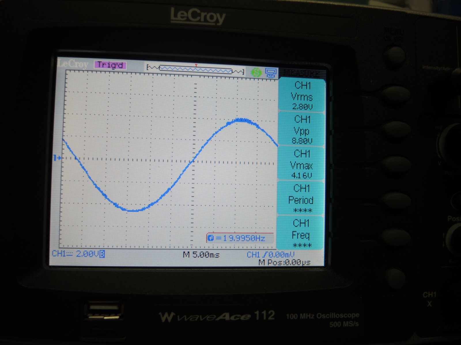

Low Frequency specs

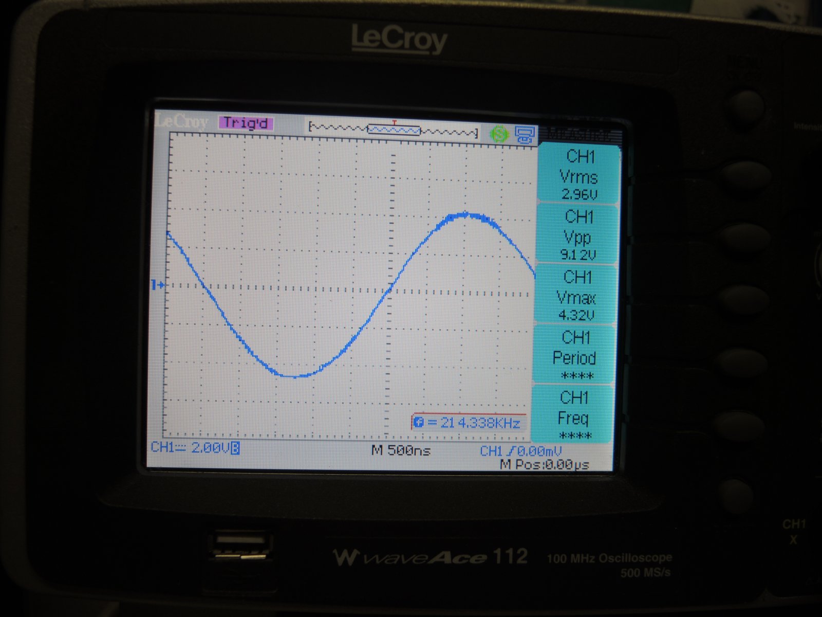

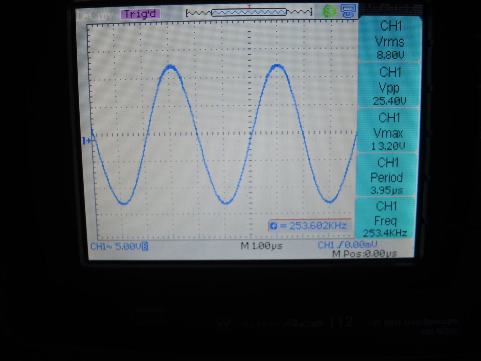

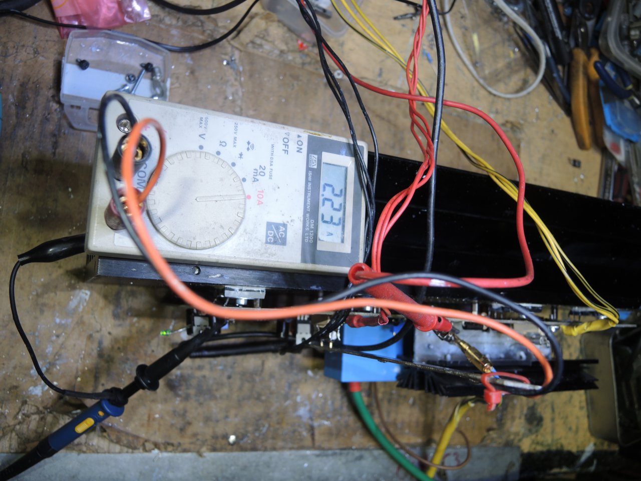

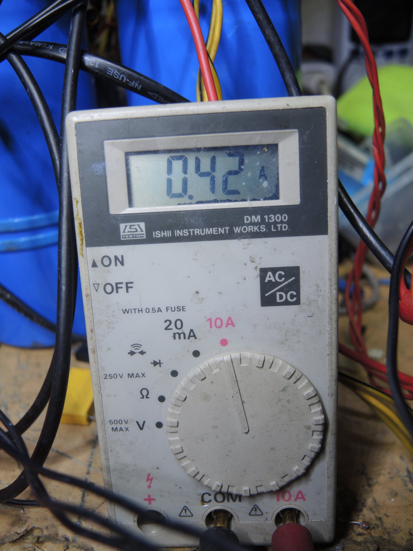

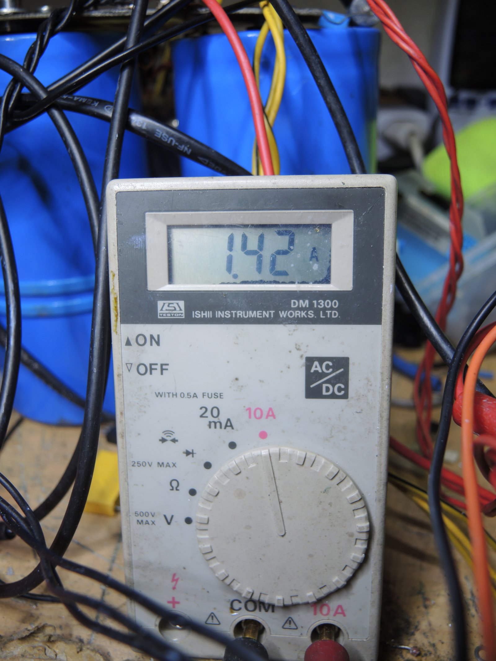

Good Morning everybody
So this morning @7am I sat on my construction table and made some adjustments to that Class A amp.
But first pics shows IDLE CURRENT without signal and second Pic shows Current Flow at 38 Watt @1Khz.

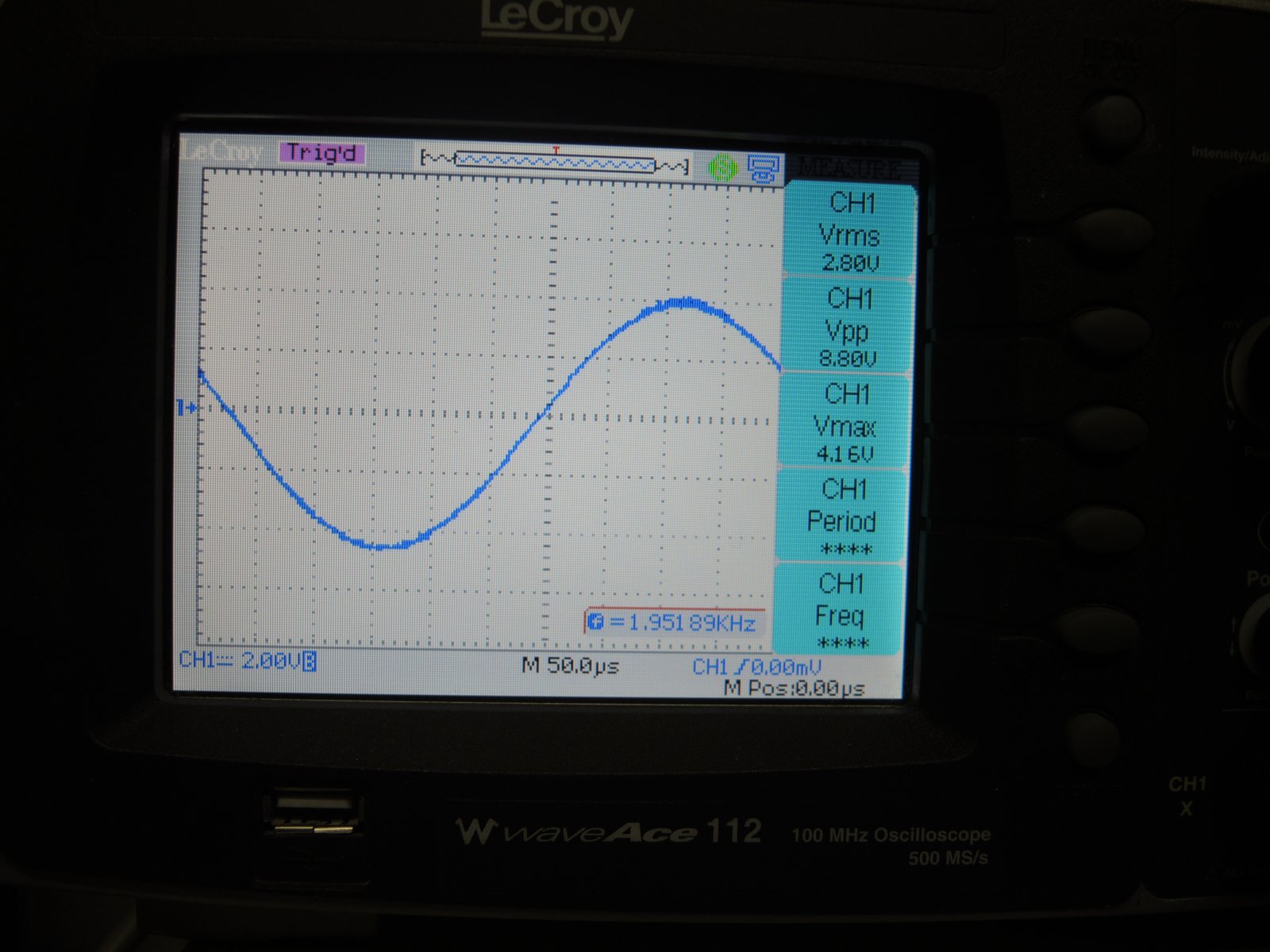

Then also:
I needed to get that Low Frequency boost to a lower spec.
Here are the outcome of that,
Pics are showing Sine Wave 10 (9.74) Hz to 214Khz @approximately 1 WATT RMS..
Steps are 10hz, 20hz , 2k and 214 KHz.
There are other tests to follow as well other adjustments to be made..
Just besides that, Sound is fantastic..
Guys have a nice day

Another step in creating a Variable Current Source Class A Amplifier
Friday morning October 8th 2021 07:47, listening again to that prototype which almost get me out of my mind. We could call it Failure Amplifier.. LOL
Now, after exchanging Transformers from 30 - 0 - 30 AC to 25 - 0 - 25 AC and also exchanging Current Source Transistor the Amp runs stable as pure CLASS A. My Goal is it to run that Amp on 42Volts Rails. not 35
This are facts today, these might change in the next future days--
Measured Values
Vrail +- 34 Volts
Idle 0.35Ampere
Power consumption for one Channel 31.3Watts.
Bandwidth 10Hz - 100Khz @ = -1dbDistortion = 0.1%
@ 60Watts 2 Ohm Loudspeakers NOT DUMMY LOAD RMS
Drawing 2.5 Ampere Current from PSU. Measured RMS
Bandwidth 10Hz - 100Khz = - 1db @ Distortion = 0.01%
@ 1Watt 2 Ohms Loudspeakers NOT DUMMY LOAD RMS
Have not measured 4 and 8 Ohms yet.
This will be measured in the next step
Sound is good
Future tasks to check are, Servo Control does not work as Expected when Load is changing at the output of the Amplifier, between 2 Ohms and Dummy load and 2 ohms Loudspeakers
And I need to create a new PCB one more time, this then will be Number 6.
Be back later with pictures
Gents, enjoy the day and life..
Regards Chris Hess

Completing the Boards
Hi Gents
In the meantime I found the bug, which gave a headache for quite some time.
Last Saturday I made two new boards and right now populating them with everything to get that Amp finished (the boards) by end of month..
It looks good that this happens.
Since heatsinks are somewhat smaller than the ones I usually use, I now must design a Chassis or Box or enclosure.. so this will take some time after design to produce..
So, in a few days I will release the Test and also the final circuit of this Variable Current Source Class A Amplifier. A Class A which does not get hot while on Idle.. Also not getting hot while running in rook level listening mode.
I have to say that Distortion is slightly higher than with a Constant Current Source Class A - but this in not in the hearable range . Far below 0.5%. As idle current is as low as 0.30 Amps instead of 4 Ampere as for the hot Single End Class A.
Regards
Chris Hess
Hi Gents
Regards
Chris Hess
Variable Current Source Class A LOW IDLE NO HEAT
Good Morning Gents
Friday 8:25 22nd October 2021
A few pics from that Amp Variable Current Source Class A - output 1 Watt into 2 Ohms
Line Power consumption in the back
Vrail
And Current
Good Morning Gents
