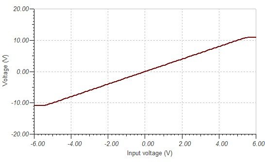

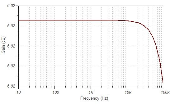

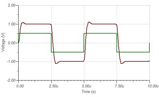

TINA-TI Update: I did a simulation experiment.
TINA has Examples-Test Circuits for the OpAmps. It's usually a non-inverting opamp with a gain of 2. There are 4 steps in the Analysis:
1 ERC .. make sure the circuit is complete after editing
2 DC characteristic (Hybrid1.jpg)
3 AC characteristic (Hybrid2.jpg)
4 Transient (Hybrid3.jpg)
A typical example has Zoom=100%. This makes wiring difficult. Better to use 150 or 200%. And then run ERC because mouse jiggling may leave invisible cruft. Click the ERC dialog to fix it.
So far there is no need to think about SPICE but there is an export tool for the SPICE code, schematics, and graphs. It is a relatively easy start for a beginner.
I crafted (TL072-Hybrid1-TINA.jpg) for my own practice. Note that the DC tests shows clipping with a 300 ohm load but is fine with 600 ohm. I guess the bias resistors need change.
