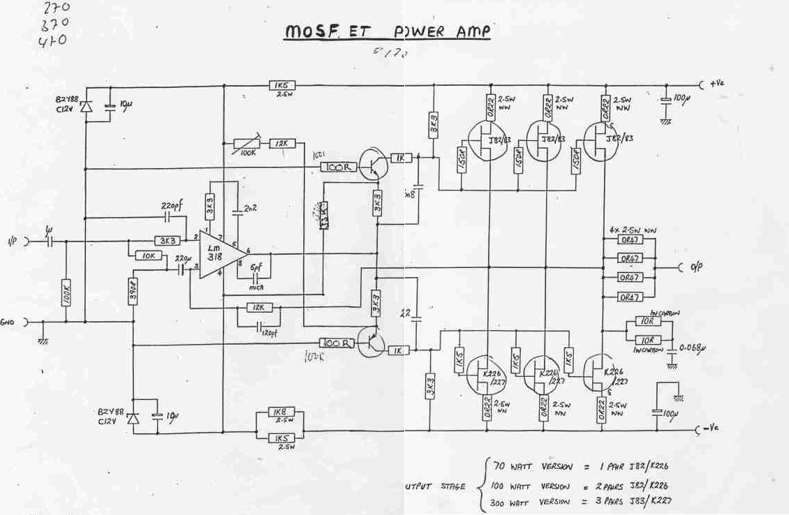

I wonder why people have worked so hard on the MyRef series and still haven't upgraded the project to a high quality driver chip with high end outputs?
Hi Daniel,
simply because a My_Ref with discrete high-end outputs is simply a Musical-Fidelity A370 and no driver chip is necessary... ;)

According Mauro Penasa, first My_Ref versions (not published) were TDA based but only with the LM3886 he found the right chip for his goals.
I was referring to unorthodox use of the TDA7293 with IN+ shorted to IN- so that it cannot amplify anything. The TDA7293 would have its predrive disabled and use the LM318 instead (Connect output of LM318 to TDA7293's Pin#11). The result should resemble the schematic at post #148 except with dMOSfet outputs that are cooler running, higher availability and lower cost than the 2SJ/2SK.
