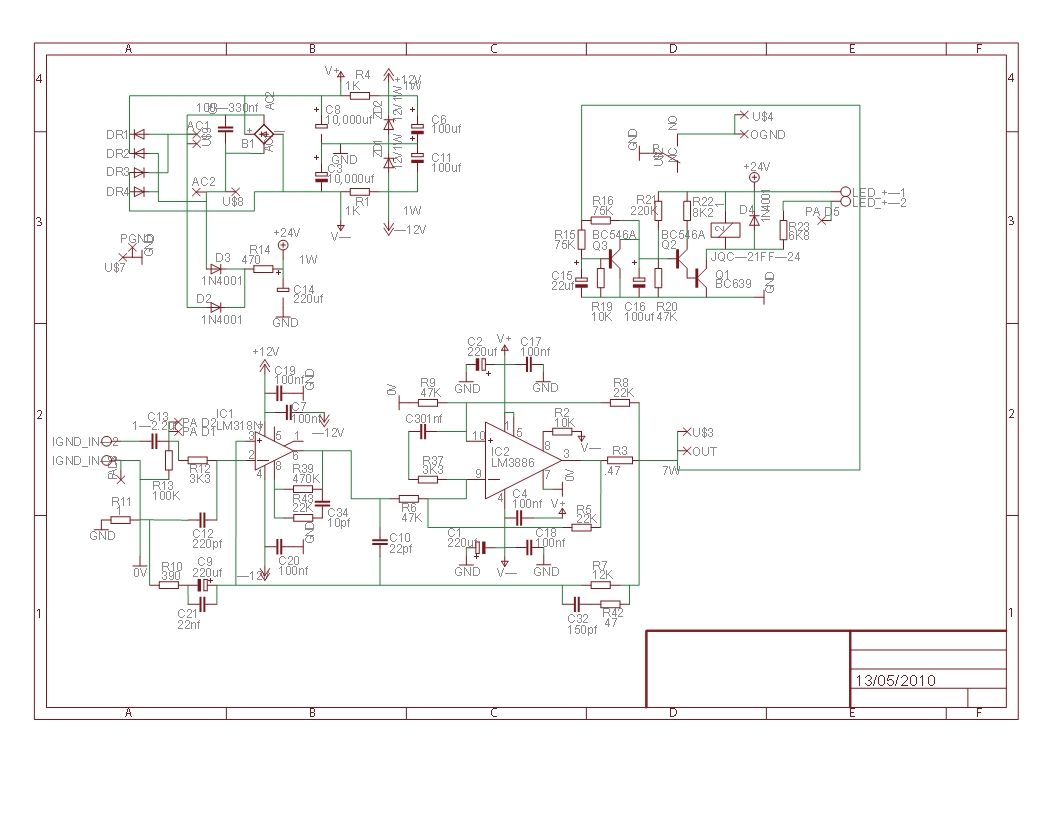

Actually I don't use buffer. It has gain but lower than usual. From practice I observe that the input gain stage is required to sound good.
Options are: high gain power amp, or low gain power amp plus additional input gain stage. I found it was better to set the gain of the power amp lower to lower noise and distortion.

Probably want to use a higher voltage for the LM3886. The LM318 is usable, but you may want to use something with less noise, say a NE5534A, change the compensation as well, if you change the OPAMP. Not sure about putting the OPAMP in the NFB loop with the LM3386, what is the advantage of that?
Rick
Rick
LM3886 and other Overture series contain the Spike system which exacerbates clipping and indeed sounds like a hard clipper to me. This is unkind to outputs and worsens the situation with a slight bit of sticking. Whatever the case may be, just imagine the worst outputs ever. Now, if you enclose this noisy TV power amp chip inside the feedback loop of a small signal op amp (nesting), then the problem is decreased by same proportion of the new global loop. That's automated quality control.
Short answer: Noise reduction (since it is actually predictable, more accurate term is "distortion reduction").

Thanks for your explanation, Daniel. You certainly have more experience than I using these parts. Has the posted ckt has been built and tested?
The TDA7294 circuit? Yes, it has been in service for several years.
AndrewT helped me set the feedback shunt to correct values for good bass.
The clean form is posted; however, mine is accessorized. . .

.........Will someone ............. do some elementary hen scratching showing where the driver chip and/or PCB would be placed and post it here................... just a point of reference or insertion. ................
take out IC2.
Replace that with the Whole {driver chip and output stage and compensation} using the existing feeds from +IN, -IN, Vcc, Vdd, Output.
BUT, the MyRef has been developed around the 3886. There is compensation between the 3886 and the rest of the MyRef circuit.
That compensation will almost certainly need to be changed/adjusted to get stable performance from the assembly.
