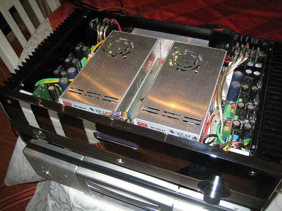

OK Guys, I can tell a bit more about my Chipamp.
In the beginning I used a big 600W transformer, fast diodes, big capacitors and so on. I designed a PCB and started to run some tests. Beside listening to music I tested the noise with a open input. I connected a headphone and spent allot of time by optimising the cabeling and shielding the transformer. But I was not 100% happy with the results because I still did hear some 50Hz hum and noise on the headphone. The next stage was a regulated power supply which was an improvement but not the final design. After several experiments I ended up with switch mode power supplys and a new PCB design.
I agree to what dynabok said : simple is the best
So I changed my first design to a inverting design which saved a cap in the signal path and I removed the pots and used resistors for a fixed gain. I am using a digital x-over inside the amp to get the signal for my 3-way speakers. In the whole path from the digital input (spdif) to the loudspeaker there is only one capacitor.
As a conclusion I would say the same that people here said before: THE DESIGN ARROUND THE CHIP CAN BE MORE IMPORTANT THAN THE CHIP ITSELF.

You are using switching power supply, is it will noise? I also think about to use switching power before, but I am afraid it will pickup a lot of noise? how can you do it?

What kind of noise would you expect? As you can see on the picture the powersupplys are very close to the aplifier PCB's. But from my experiance the results are better than everything I tried before. Even when everything is quiet (by night) and the volume is set to normal values I hear absolutely no noise out of the speakers. ( I hope this has nothing to do with my hearing 😉 )
This kind of powersupplys work with frequencys around 100KHZ which is out of the audio range. So I think it is better than 50 or 60 Hz of an ordenary linear PWS configuration.
Or imagine you would try to filter 100KHz and 50Hz with the same capacitor. The filter effect will be much higher on 100KHz.
