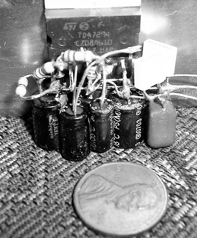

I do enjoy the TDA7294 because its quite powerful and its treble isn't as much challenge as LM3886. Maybe its not right for me to enjoy something because its less of a challenge? Well, the midbass vs power circuit does provide some hours of entertaining puzzle.
A good friend sent me this link: http://www.elecfree.com/electronic/tag/tda2030/ It looks mighty tempting.
And, that reminds me that most of the ST Thompson that I have liked best, were applied bridged or symmetry(ish). One of my first chip amps was TDA2003 bridged and with a 15vdc laptop power supply. That thing is lovely pushing a big 4 ohm aluminum cone driver. 😉
