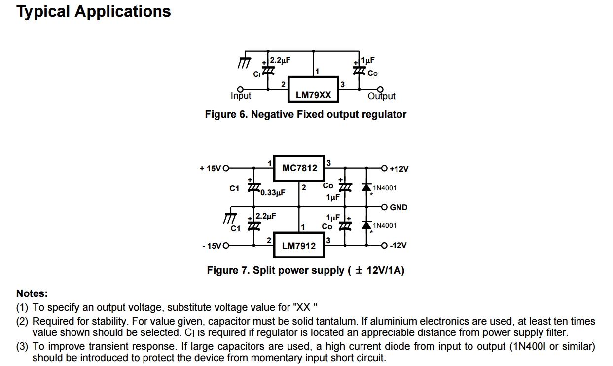

What does the datasheet suggest?
The datasheet shows a whopping 1uF. Sounds too small to me, but I'm no engineer.
Perhaps someone who have used these extensively can comment.

If you are replacing with electro types datasheet suggests 25uf

A capacitance multiplier would not be appropriate to replace the regulator's output capacitor to ground.
Certainly, you could use one after the output capacitor.
The regulator's output capacitor only needs to be large enough to ensure the regulator's stability.
Larger than that slows down the regulator's transient response unnecessarily.

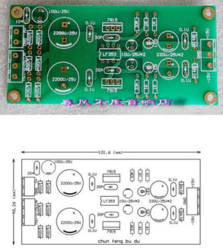

Looking at this 7815/7915 board on eBay, it uses a LF353 op amp. What does the op amp do?
The board uses 10uF caps like you suggested, but I also see 220uF caps near the outputs.
So the large 220uF caps will slow down the regulators' transient response?
It's difficult to tell what the actual circuit is. The op amp power pins do seem to run off the regulator outputs.
Do you have a schematic?

A usual op amp based regulator will have some reference voltage
with which it compares the incoming voltage to, then providing usually a replica
of that reference. Compare the board you have found to the components
used here: References & Regulators | Walt's Blog 2014
My conclusion is the op amp does nothing, other than possibly adding noise.
Cheers / Chris
