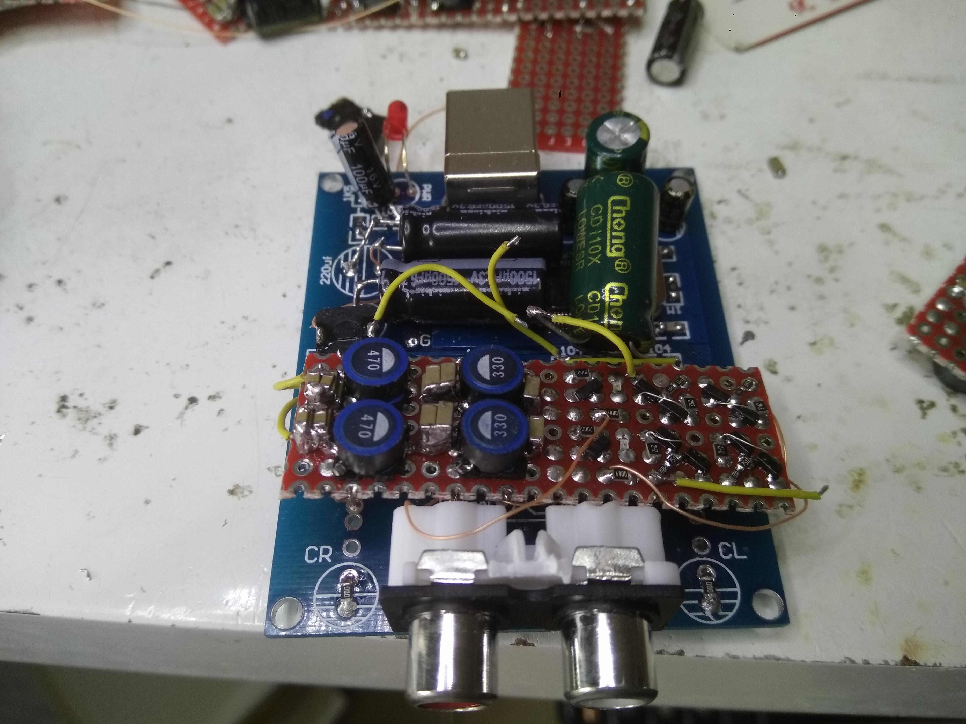

I don't have any recommendations for boards in stock form. However almost any TDA1387 based DAC has bags and bags of potential for being modded to the heavens. The cheapest one (I'm modding half a dozen of these right now) is here : L1387DAC 4X ??TDA1387 ??USB???(??+??),??TDA1543-???
The price of 44rmb (about $7) is for a board and kit of parts you need to assemble yourself. For $15 you get a finished and boxed DAC. The cost of the parts for the mods will probably double that.
Here's one of my boards in process of being modded.
The mod keeps the USB input (CM108) the four TDA1387s and the input and output sockets. Everything else is new - power supply, anti-imaging filter and I/V stage.

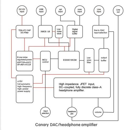

These Weiliang designed DACs are cheap but their design's maturity and stability are not as affirmed as those more established brands. IMHO not worth to take the risk just for a small price difference.
Personally, of all the budget DACs out there, I will choose Yulong Canary DAC above anything else. You can see from the design that it worth every cent.
That does indeed look very nice... It seems like best buy at the price.
It is also a full-blown analog input -> class A discrete headphone amplifier as well (!!)
Reviews are very positive. here's one:
Yulong DAART Canary - The Elitist Journal
...this eBay site has nice photos...
YULONG DAART CANARY DSD SABRE 384kHz DAC DIGITAL ANALOG CONV headphone amplifier | eBay
