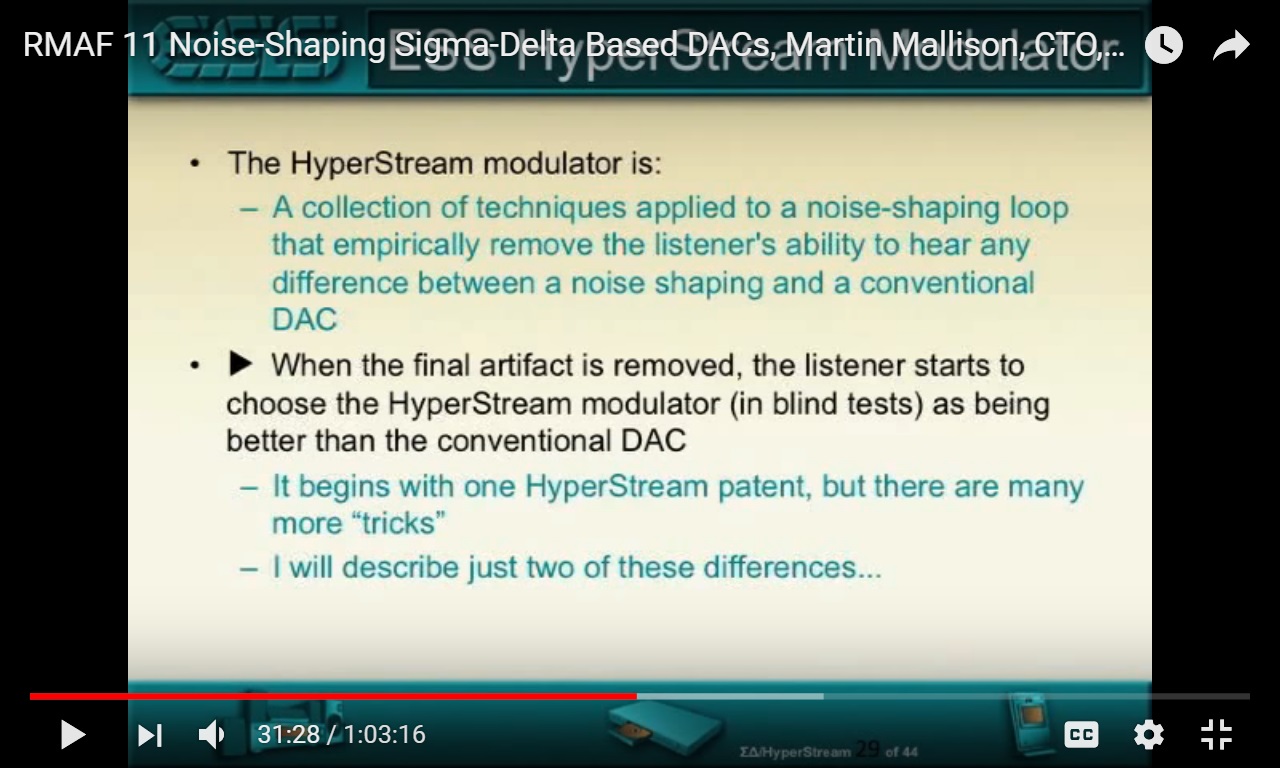

The CTO from ESS gave an interesting talk which is on youtube... 5 years ago, but great content. Search for Martin Mallison. Funny how he describes some listening tests. Apparently his hired ears could hear the flaws with delta sigma even with source material such as New York New York by Frank Sinatra. Their proprietary modulator design fixes it, but he doesn´t claim superiority over true multibit dacs. He hints about state space and how their modulator transitions without the state variables going all over the place.
Agree. The USB receiver chip is as important as the DAC chip itself. M8A has XMOS and the current output ES9028Q2M, board design is top notch too. To be honest none of the DAC in your list is capable challenging it.
I watched that presentation when it first appeared (5 or 6 years ago was it?) and agree its really well done. Pity I don't recall him describing which 'conventional DAC' implementation they used as their reference. Did I miss that?
