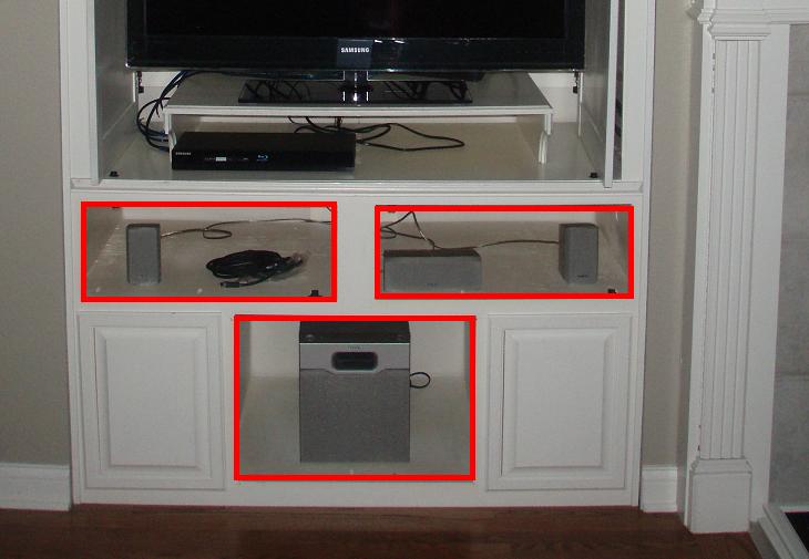

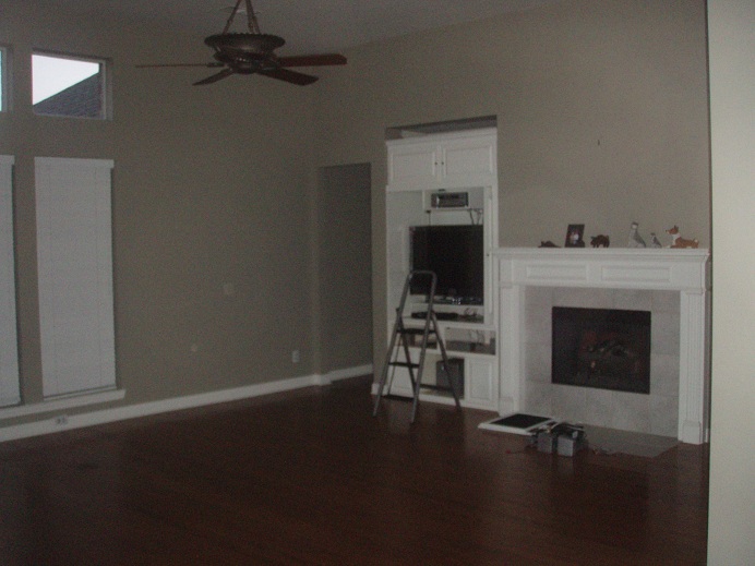

The reason I want off-axis performance is because the entertainment center is set off to the left of the room, so people will be sitting directly in front of it as well as off to the right.

Unless these constraints from the original post have been relaxed
the room volume and system locationThis room is about 3500-4000 cu.ft and leads to a kitchen and dining room, so probably more like close to 7000-8000 cu.ft. Pretty un-ideal. So I'm looking for best dynamics possible. We are NOT allowed to place the speakers anywhere other than the cubby holes.
do present an interesting challenge
I HATE that they will not allow other placement. Especially after seeing how unobtrusive thoriated's killer "line array" looks,
But yes, we are stuck with the cubbyholes. 🙁

Two EL70's will not fit vertically mounted. They are 4 7/8" tall, while my available exterior dimensions are:
8 7/8"H x 23 1/8"W x 25"D
Can two EL70's work side by side, horizontally mounted?
