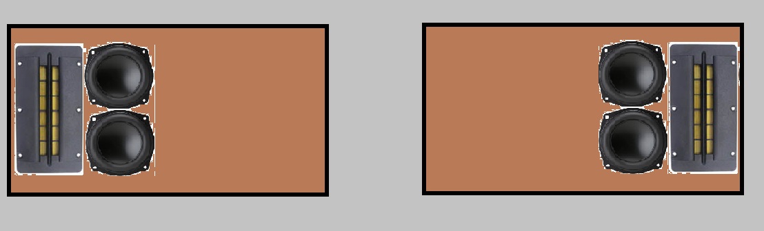

Side by side?
This combo speaks to my inner happiness.
Yeah, I think so...
Have the tweeter on the outer-most end, then the 6" right next to it. A simple 1st order series crossover and you're good. BTW, a simple series crossover helps to preserve dynamics as well due to the use of the least amount of components.

[l]O | O[l]
Kind of like this IF that makes any sense. LOL
Yeah, I am digging this idea.
And it could run without sub for late night listening.

Hmm, how about taking the best of each design and combining them?
Wide dispersion planar tweeters crossed over at 3k hz to a pair of vertical mounted 4" full range with high x-max, low fs and nice off-axis response? Crazy or do-able? 😀

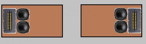

Picture of proposed layout. And feel free to smack me around and say I'm not listening to you. 😛
PLEASE say it won't work - it's killing my budget.

Okay... It won't work ;-)
Off axis response of planar tweeters are far from the best.
Dayton Audio's much cheaper 3/4" tweeter will do even better.
I haven't tried the 4" ones, but I've got the 3" Aurasound drivers. They can be crossed as high as you want to, say 6-8kHz first order. But mind you, the resolution isn't really that great. For background music, they are wonderful, but if you want something "revealing", they won't do the job. Again you would like to take a look at the Scanspeak Discovery full range

What's more, we're in the "Full Range" page and I suspect it's better for us to focus on full range solutions. =]
