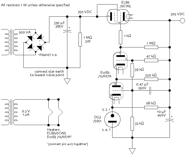

Well, at this point, I am just looking for a good preamp to either buy or build. Frank's preamp is ok, certainly, but I don't need the phono part of things. So just the linestage will do nicely. I wonder if I could just use a single supply, or just one transformer. anyway, thanks for the info.

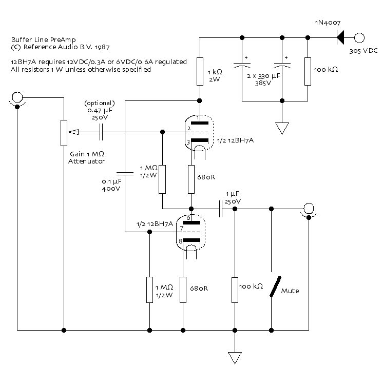

I think if you stick with the linestage version (no phono) and go with the one transformer...you would be pleased. It appears to me that 12AU7 and 12BH7A are interchangable directly...but possibly could be tweeked by a resistor change?

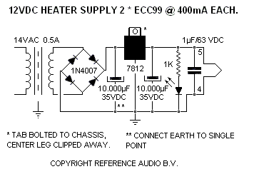

Hi, Well, I'll probably look in to building that line stage. The 12BH7 uses more current than the 12AU7 for the heater. Did you look at the other schematic by Carlos?

Hi, if you read the whole thread, Carlos has this favorite schematic that uses a 12AU7 that he likes versus the 6SN7 or the 6CG7 tube.
Now, gotta ask you because I can't see your pics because I am blind. So in some respects building this preamp won't be as hard to do as it would if it were a PCB. Anyhow, what did you end up doing as far as the supply and transformer. There's just the 12BH7/12AU7 tube and that's it. I saw the parts list, and some of it didn't understand what the stuff was. I'll go back and look at the parts list again. What did you do concerning the volume control? If memmory serves me right, he is using an Attenuator of 1 Meg. Don't think I can get a volume pot that big.

I used left over 3/4 inch cherry hardwood flooring for the case. The top is two pieces of aluminum separated by a piece of cherry wood. I used several pieces of terminal strips with posts to do the p2p wiring. Transformers and big caps are mounted on top, except for the 14v filament transformers are mounted underneath. I tried to place the components such that the other parts would reach. The star ground is a sheet of copper that I mounted to a board located under the transformers. The pictures in the thread show the guts well. Maybe you could get someone to describe them to you. I am using a Goldpoint 500k attenuator. I thought it was a "make before break" type...but it must not be, because I have to mute the circuit to avoid the annoying pops when adjusting it.
