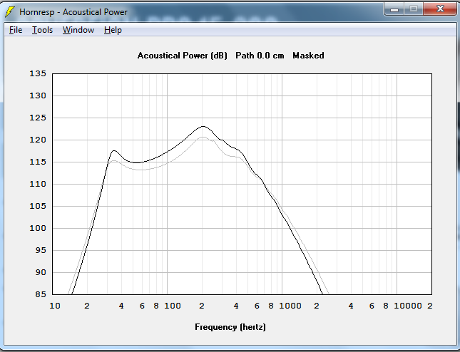

Regardless, at a glance, I don't see anything technically correct,
are you referring to the HR input page of post #13 in this thread?
Horn is a 110 Hz expo with a 128"^2 x 5/8" [baffle depth] conical throat.
i assumed the driver cutout forms the throat, hence I used a value of 640. Apparently the correct value would be simply the whole 20"x40" baffle area at the start of the horn?
At least mouth size, horn length and expansion (exp) should be correct? 😕
Sorry you lost me there, what does "CR" stand for?Vtc, Atc is irrelevant and can be left blank since it's a 1:1 CR and the driver is pistonic over the horn's gain BW.
now if i knew how to model all that.... 😱Rear chamber is technically a two segment BLH with conical, then parabolic inverse taped TQWT and of course vented [mass loaded]. Note that the 825's open back horn cavities function as a crude band stop filter.

Yes.
Sorry, no; between the wrong throat and not factoring in that its axial length is sloped down some, the 110 Hz flare couldn't be made.
Compression ratio, i.e. horn throat [St] = driver effective piston area [Sd].
Yeah, though judging by some sims I've seen posted recently it may be possible in HR now, but a very low priority for me, and none for you since tuning will be done empirically.

Yes.
thank you for posting that screencapture GM, I see now what you mean. The flare cutoff frequency is shown in the rightmost column. I am still a hornresp noob. I will adjust accordingly. I'm running an old version of hornresp on my wifes old windows laptop, which doesn't help..... 🙄
You're welcome! Understood, I happen to be intimately familiar with this cab alignment, having used it as an example when being taught horn design basics way back when, so knowing the flare frequency, etc., makes it easy in HR, though if you know it you can juggle mouth area Vs length till it calcs the correct one.
HR can be confusing WRT truncated horns in that the pioneers designed a full size horn [this one was originally described as a 1/2 size 55 Hz expo], then cut a 'slice' out of it at the desired throat area and further down as required to meet the needs of the app.

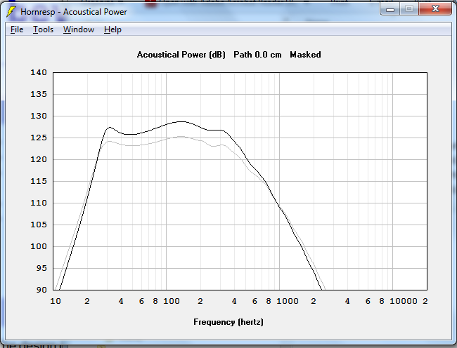

I corrected the input parameters, now I have the correct flare frequency of 110 Hz. Marginal differences. I did 0.5PI and 2PI, comparing the Beyma SM115N to Fane Sovereign Pro 15-600. Due to a bit higher xmax and higher tuning, the Fane would take a few watts more and be 2-3 dB louder, but with an uneven response. The beyma still comes out with a smoother curve in 0.5 PI.
125 dB with 40 Watts 😀
Any thoughts on these response curves?
(Couldn't resist setting S1 to 640 cmsq, since that is the actual baffle cutout 😛)

Actually, I don't, just the 803A I did to show you the horn inputs. As for measurements, we had no need way back when as all Altec designs were well documented by them, though sadly, EV destroyed any paperwork they didn't need, so limited to a relative few plus whatever DIYers have posted.
Note too that available drivers were for the most part all of a 'sameness' for max interchangeability for each genre of speaker types with W.E./Lansing/Altec being the most copied. Haven't paid much attention to current production, but from what little I've noticed, nothing's really changed in prosound, cinema, M.I. apps beyond the usual improvements in CAD, etc., materials, manufacturing.
As for choosing drivers, the horn 'rings' at ~220 Hz, the mean of its 110-440 Hz BW, so in T/S parlance we ideally want the driver mass corner [Fhm = 2*Fs/Qes'] to be ~220 Hz and ~440 Hz like the average 803A if driven with a period correct matching impedance to drop it back down.
Later Altec drivers don't spec too close until one factors in thermal power distortion, so somewhat misaligned for HIFI/HT apps, ergo ideally one would dial in a bit of some form of series resistance to smooth it out, though few do, or use whatever Fs, Qes driver that meets the 'magic' ~220 Hz Fhm spec and of course there's still the issue of having the right amount of breakup modes BW to fill in above the horn's upper roll-off.
The sims are fine for comparing basic horn response for comparison, but that's it as there's not enough there to have any real correlation with how they sound, though if we can properly sim the back box we might can get an idea of how it sounds, though frankly, it's been so many decades since I've been exposed to them, especially in a HIFI app, that I wonder if I would recognize it if blindfolded since they don't sound like horns at all when properly 'voiced', damped, just very open, efficient, dynamic speakers with excellent [projected] vocals combined with a rolled off bass if not hard in a corner.
