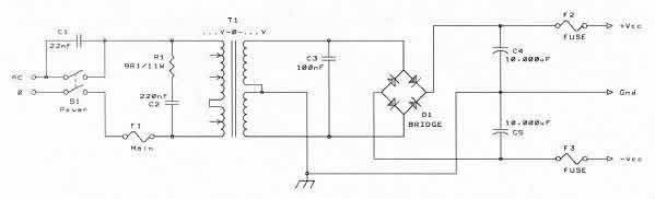

Is there a more laymans wiring diagram from, toroid->rectifier->amp?

The theoretical rectified voltage using 35V secondaries is just over 42V DC but there will be some losses to the rectifier and caps.
A 35-0-35 power supply is theoretically capable of producing around 150W into 8 ohms even if the amp is rated at 60-70W this is essentially dynamic power (always worth having 😀)
The other thing to watch out for is the transformer regulation, the specified secondary voltage is usually with the transformer under load so at low powers it will be up to 5% higher, with a 300VA transformer up to 37V
I'd recommend using supply voltages 10% less than the maximum specified so as the amp isn't stressed for the sake of a few extra watts, the ability to deliver lots of amps is every bit as important as volts.

25A or 35A 200V or 400V or 600V bridge rectifier.
Post18 shows the Main Audio Ground (MAG) soldered onto the wire connecting the smoothing capacitors.
DO NOT copy this.
Locate the MAG near the power amplifiers and the Speaker Terminals. Bring single wire connections from all the various parts of the circuit to this MAG. Bring the PSU Zero Volts to the MAG.
DO NOT copy this.
