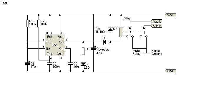

Hi Ray,
So I built the timer as per the suggested link and somehow the output is always low. I expect it to go high as soon as I turn on the supply so that the relay is de-energised. Any idea on where to look into?
I would suspect C1, the timing capacitor. It must be a low leakage type,
or it will never charge to a high enough voltage due to its leakage.
Monitor the C1 voltage with a high impedance dvm, and see if its
voltage goes high enough to switch the timer.
Hi Ray,
If I understand correctly C1 is supposed to slowly charge, independently of Vout.
I looked into Vtrig (C2) and that follows the same profile of Vcc by turn-on.
According to the instructions that is supposed to stay low for a while in order to start the timing and trigget Vout high.
I wonder if C2 is the actual reason and how I can make it hold Vtrig down long enough.

The 555 is a terrific device but it does need care in implementation. The old (original) 555 which is still available behaves a little differently in practice compared to the later low power and CMOS versions.
So the first question is what type of 555 are you using.
Other issues concern the way the rail rises from power on... does it rise quickly or does it ramp up a little more slowly.
I've used the 555 very succesfully for muting circuits but you end up with something a little different to the text book implementations. A good circuit will also go into mute if the power drops out briefly and will then go on to give the full mute delay time before re-energising the relay.

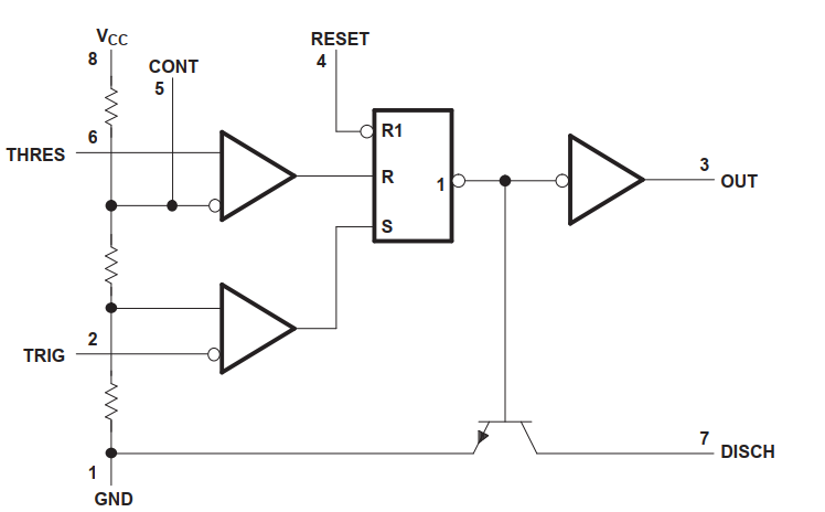

I discovered that in the first couple on/off cycles, the circuit above with the timer (NA555p from TI) works fine. After that, pin 7 (disch) is permanently shorted to ground. So it seems that the internal transistor (see pic) is fried...no idea what happens.
Mooly, your elegant delay circuit looks like a very good alterntive. My available Vdc is around 12V: can I use a voltage divider to get to the 5V? Or maybe just put a resistor in series to the relay to limit the current?

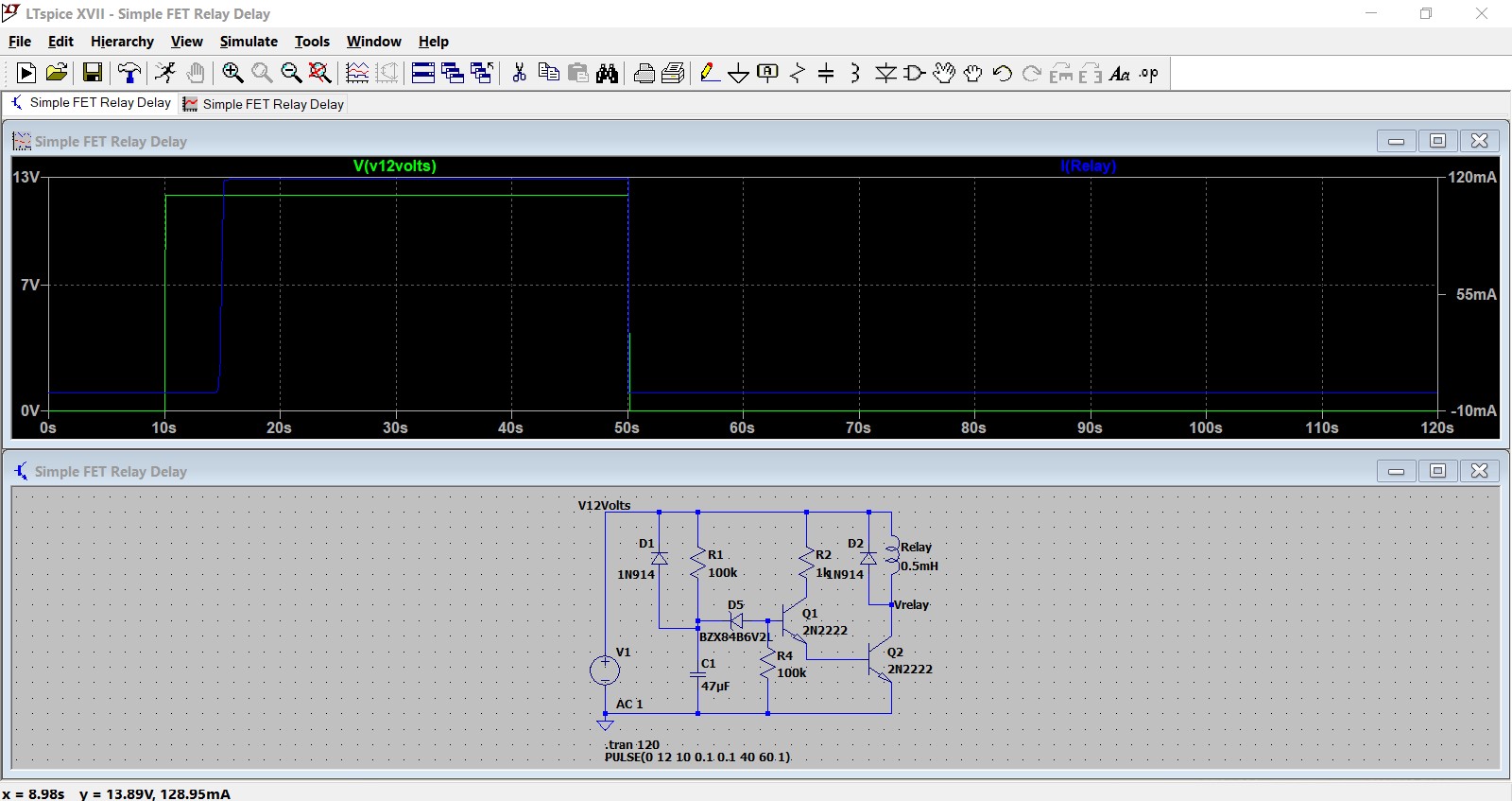

So a couple of alterations. The zener (anything around 4.7 to 6.8v in value) allows the timing cap to climb to a higher voltage before turning on the transistors. This allows a smaller cap to be used.

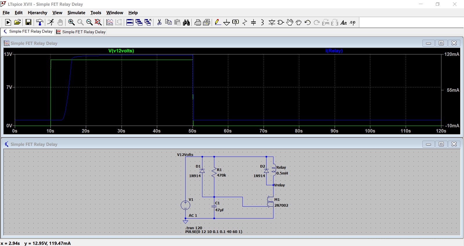

And here is one using a single N channel power FET. As long as you use a low leakage cap then you can go small in value for the cap and high for the resistor. Even a film cap and 10meg is an option.
In the transistor version, perhaps make R4 somewhat bigger such as 470k. It only serves to stop the base of the transistor from 'floating' as the cap initially charges and the zener is only passing leakage current.
It is simple. Any N type power FET should do although the 2N7000 types are physically small (which is good).
As the FET needs around 4 volts across the gate/source to begin to conduct, that means we can do away with the zener. So yes, simple.

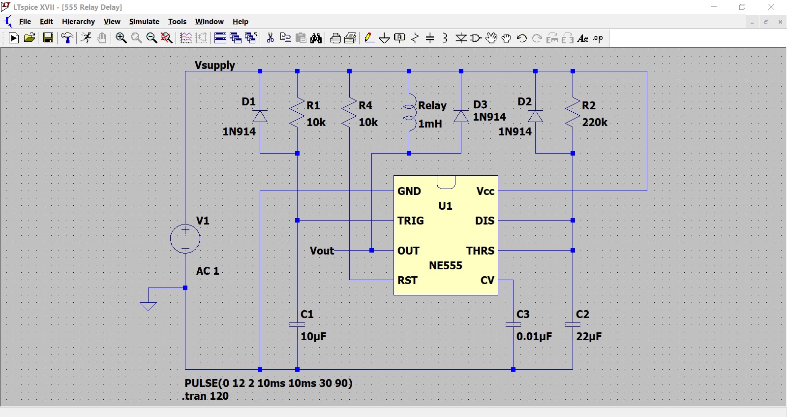

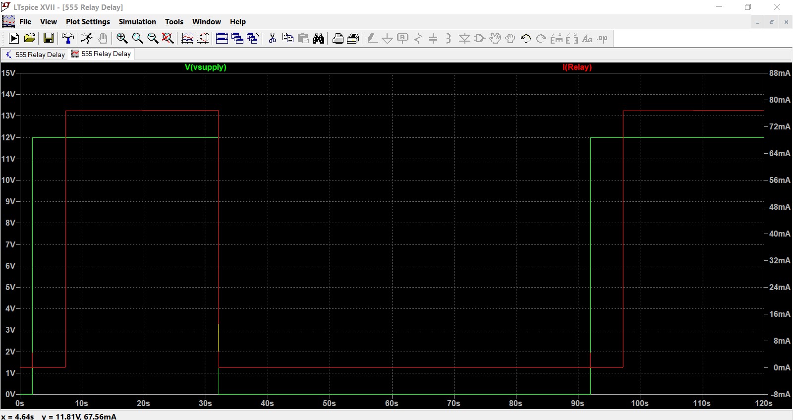

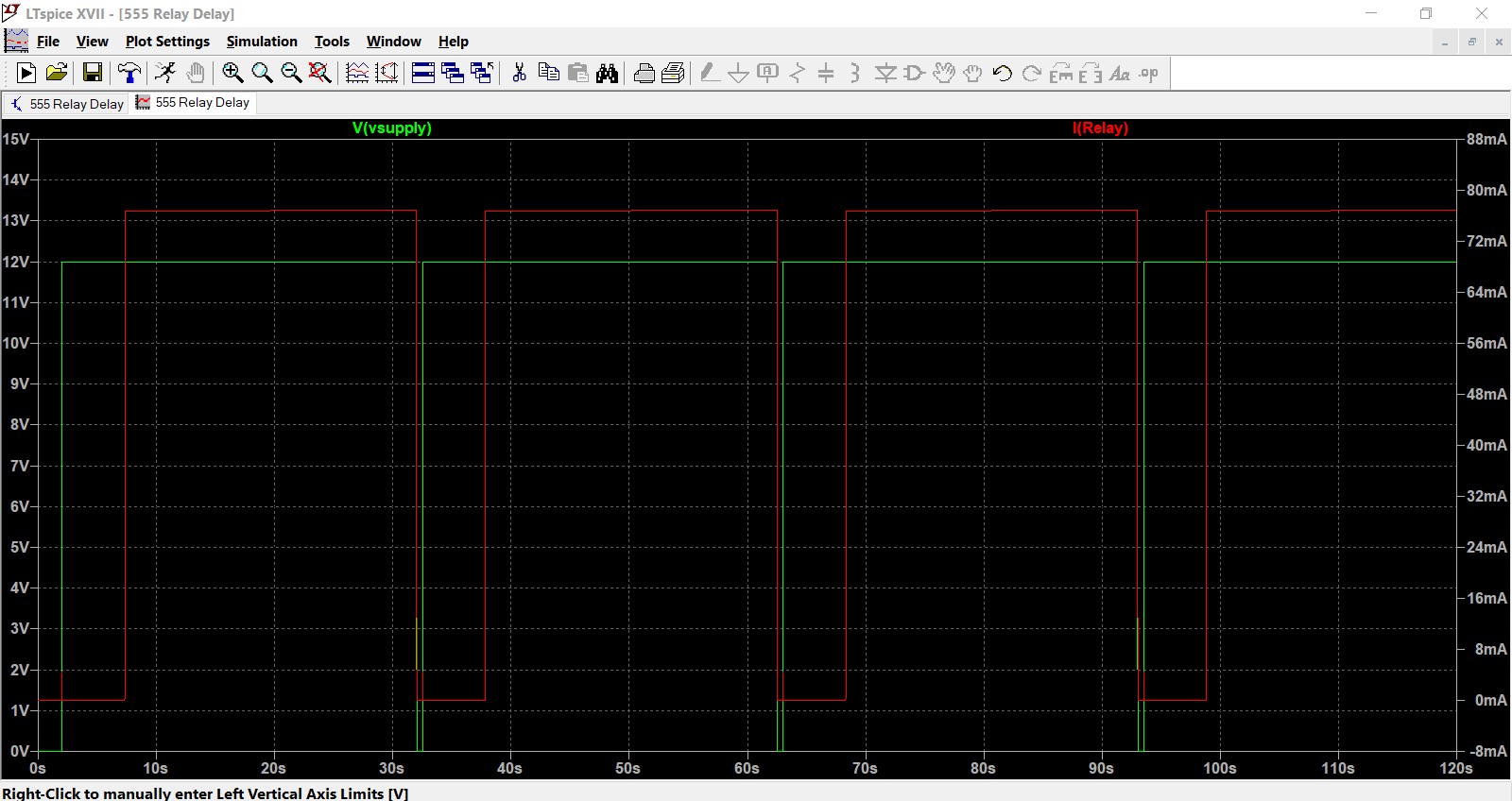

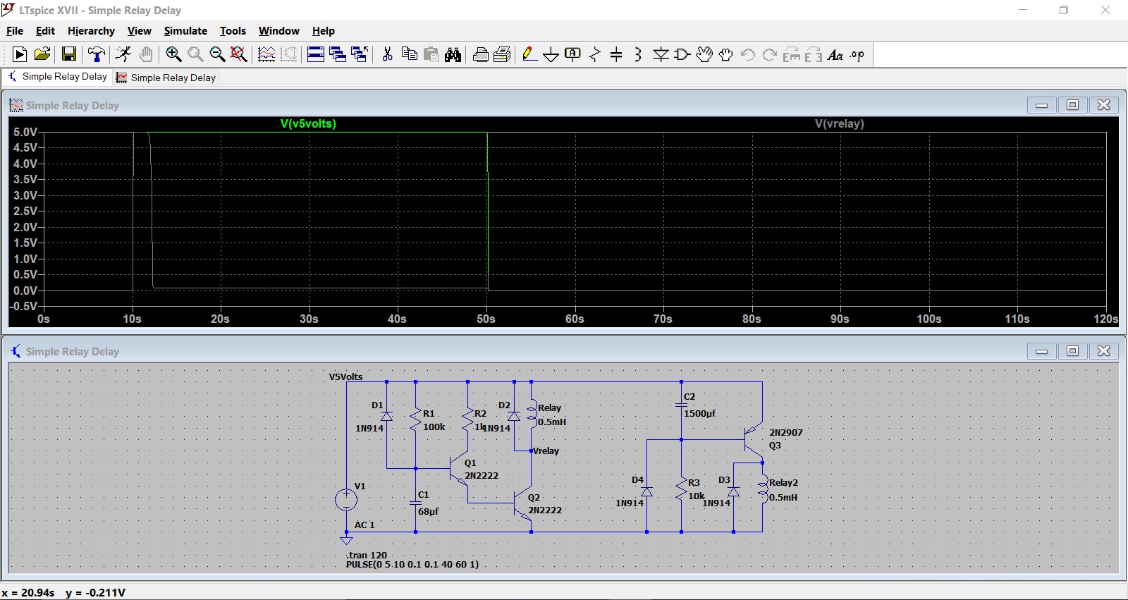

I just copied my 555 delay circuit (this is using an original LM/NE 555) into LTspice. The two timing diagrams show how the relay energises reliably on each power up cycle.
The last image shows the supply interuption down to just 100ms. The circuit still gives a correct on delay each time this interupt occurs.
For this circut to work reliably the 555 must be decoupled across the supply pins with a suitable cap... I always used a small electrolytic and never had issues.
