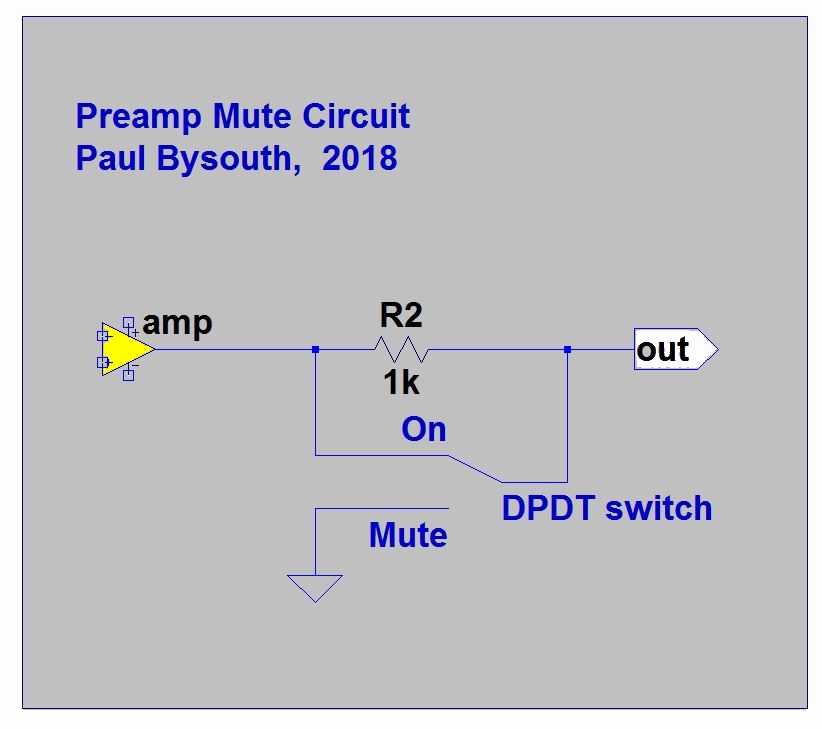

Why such a low series resistor value? When in mute, the op amp will be driving a screamingly low value, which will surely send the op amp into current limit, dumping hash-like signal related junk into the power supply rails and testing the thermal capabilities of the IC. It seems a lot safer to use some 10kΩ tackdown resistors on either side of an SPST series switch between the amp and the output jack. That way, no DC pops will happen during switching, and the load can always be driven cleanly.
Here is a better way to mute a preamp output.
Choose a value of resistor to suit the amplifier in use.

Looks good! No unnecessary loading of the output amplifier, and only one resistor vs. my suggestion for two. The DC 'thump' will happen regardless of any of these muting schemes if the output amplifier has a significant DC fault - that is a problem that needs to be solved outside of the mute circuit. A truly minimal circuit - thanks!

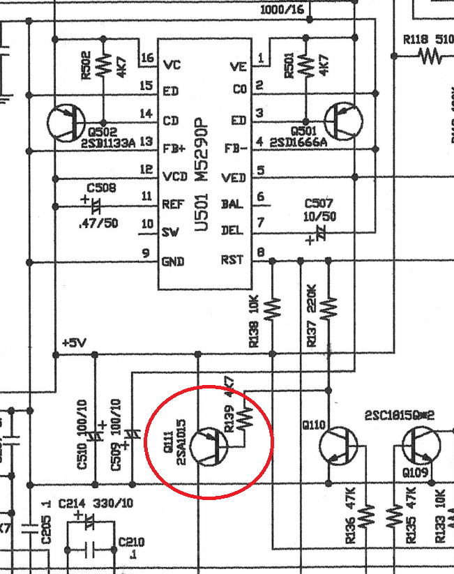

I am planning to reuse the muting driver (2SA1015 PNP BJT) as in the picture attached so I hope that will work. It's rated upt to 150mA although the available voltage at the collector would be slightly lower than 5V.
One more question: are you aware of any problem in shorting the audio signal at the output of a tube stage?
Thanks again
Fabrizio

The 2SA1015 is fine as a relay driver (remember to add a damper diode across the coil) and also make sure the transistor saturates when on by checking that there is only a few millivolts across E and C. The 4k7 base resistor could be lowered if needed to get a bit more drive current.
Can't see any issue shorting a valve stage because the output will be AC coupled anyway.

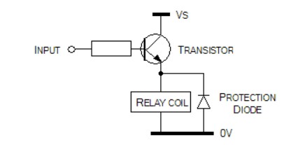

Joined 2007
When current in a coil is interrupted suddenly, the magnetic field collapses and induces a back emf which needs to be damped to prevent damage.
A diode (such as a 1N4148 for a small relay coil) is placed across the coil so that it is reverse biased.
