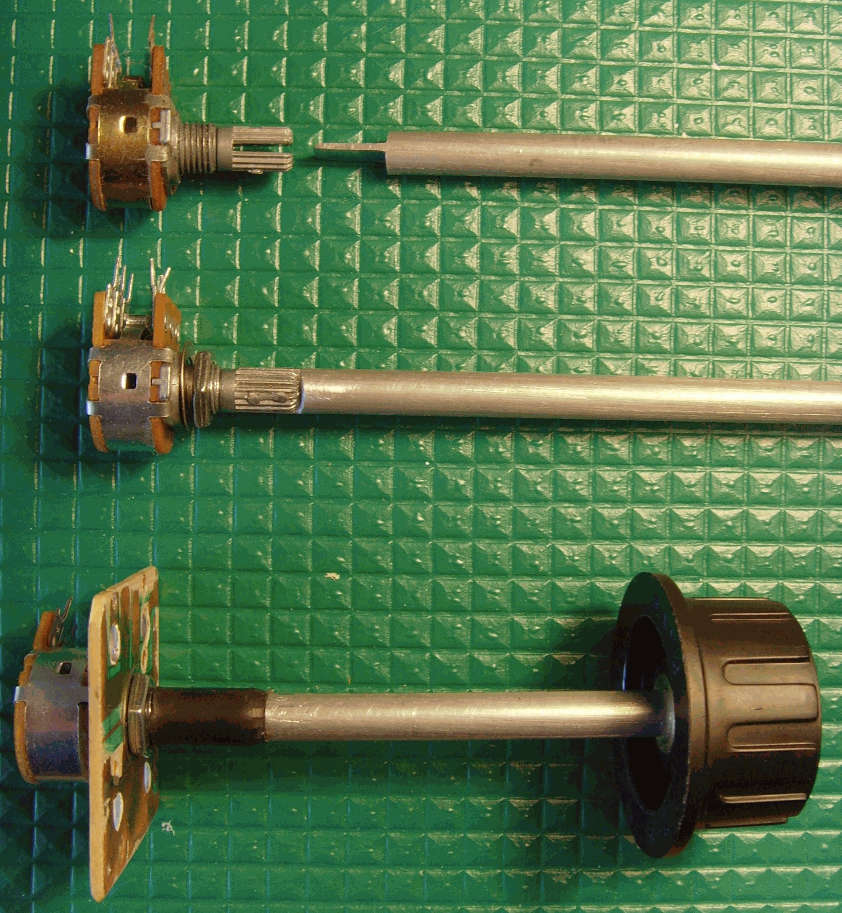

Home made extension.
I just made some extensions out of 6mm aluminium rod which is filed down on both sides to fit the slot in the pot shaft. Two small holes are drilled and the extension is riveted to the pot shaft using small nails or pieces of wire as rivets. Heat- shrink covers the finished joint. It is a bit tricky to get it straight, but the finished product seems to be worth the effort. Please enjoy!
Thank you Andrew, the filing of the shaft is the tricky part. It needs to be fairly symmetrical, otherwise the whole thing will wobble. It would be easier if you used a small mill.
