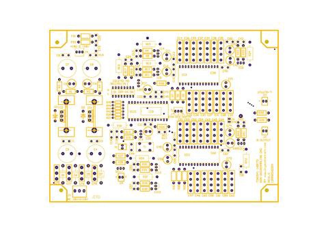

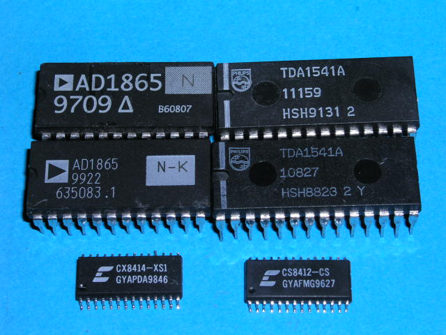

If U like to buy TDA1541A, 1989 data~1991. This parts still made in Europe. Not the Date code from 1996~( some was remark). All the TDA1541A had Philips logo on the left side. Not the end product produce from Taiwan. If U had CD880. U will know the Europe made TDa1541A had less digital sound than taiwan made.
Pls email to me. I prepare to make a kit for Parallel TDA1541a non-oversampling lits with CS8412/8414. So I directly buy lot stock ( remain) from Philips. If U had interest. pls email to me.
The price was good. AD1865 N or N~K
Pls see my tda 1541a parallel kits PCB.
Can run with I2S.
thanks
thomas
www.diyaudiocraft.com

This PCB seems to me a pcb for a tda1541?? 2 in parallel ??

Hi dddac,
U right, this is my design PCB which I use parallel TDA1541A X 2
chips.
I also reference several germany website & test them.
TDA1543 I also made to test already. But looks the TDA1541A parallel schematic was better.
this is all the website I reference.
http://users.podolsk.ru/boga/DAC.html
http://hjem.get2net.dk/torbenk/dualdactube.htm
http://www.ndh.net/home/kboehm/T-DAC-P2.htm
I only want to design a good PCB/DAC to more diyers to play.

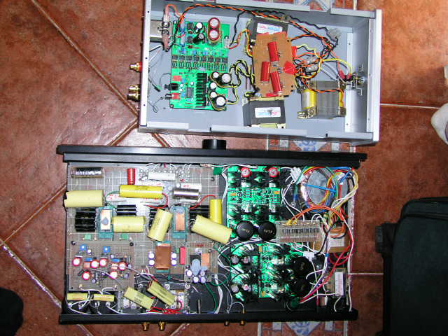

Photos show was I compare the test one 8 X TDA1543 & TDA1541A X 2.
thanks
thomas

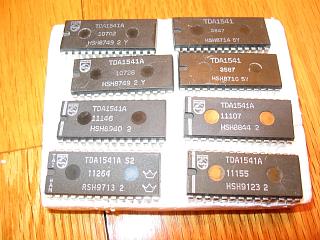

hi Berhard,
How you know where the chips were made, most of them don't tell that.
this is sales told me.
The last period of the production line was send to Taiwan.
The outlook was different. Hadn't any philips logo on the chips surface looks the QC was worst as the previous.
Pls see the different production period of TDA1541a.
The last production in taiwan show taiwan on the left side.
thanks
thomas
On your pic the ols 1541 have no logo, same with mine.
The famous S2 was made in Taiwan ?
Hi Bernard,
At first the production line of TDA1541a was in Europe factory.
But on the middle of 199X. The production line was transfered to Taiwan. The outlook different U can see is the the europe type had philips logo & white line on the left side. The Taiwan product had Taiwan on the left side. But someone say that on 1996~1997 the Taiwan re-open the TDA1541A & produce S2 Crown supply to marantz. But nobody can prove for this message.
The OLD TDA1541A Had several grade, TDA1541A is standard, Then R1, N1, the different of old S2 & New S2 easy to see on the difference of the crown. The OLD 1541A Double Crown was select from S1. The line of the selection is 1541A>>>>select>>>S1( print one crown)>>> selectS1 grade>>>>S2(then print the second crown). Due to the two crown was print in different time, There will had a little different.
Hope can help U.
Bernard, the data PDF file show the path of selection already.
The data was from Philips semi-conductor hand Book.
thanks
thomas
