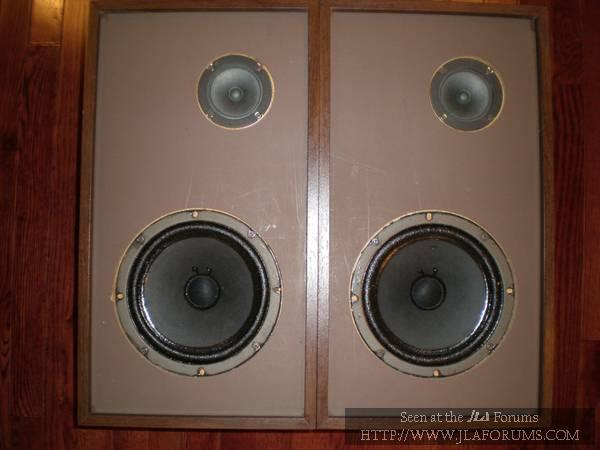

...and my vintage speakers are decent speakers (Gramps loved his opera)
If the picture is accurate, a paper cone 8 crossed to a 3" cone tweeter, XO likely a single bipolar cap. Lots of ways to tweak those for better performance.
