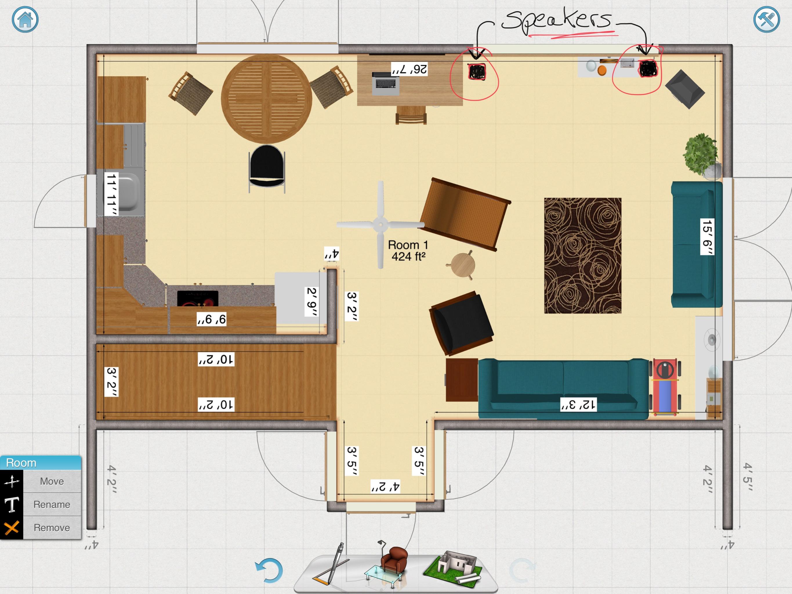

Help! I have no idea how to start looking for a speaker design to build. My budget is under $600, I’ll be driving them with an F5 (but I have the parts for an F6 when I want to change it up). I have a full woodworking shop and the knowledge of how to use it so I can build any baffle. I think I’d like to try an open baffle design but I’m not sure. My “listening room“ (living room) is an open room 30’x18’ with a 12’ vaulted ceiling that has a kitchen at one end and lots of furniture. Did I mention space is a premium? Also I have a toddler. Currently I’m using a pair of vintage fisher XP-56S speakers that I re-foamed. I’ve tried coming through archives here and elsewhere but barely know enough to understand half of what I read. Truly any suggestions or advice would be welcome.
I guess OB is out of the question as they need space to breathe, and with everything exposed, it would be a baby's playground.
Maybe a bookshelf system that won't take up any more room. You could post the furniture layout.

A small floorstander would be my choice in that kind of space. The amp choice says 25w at 8R, so you need a farily efficient design to go loud in your space. Maybe a Frugel-Horn XL with a Mark Audio Alpair 10 series driver could be what you want. Or something similar. That avoids also the need for a crossover (although the driver may benefit from some little notch filter, but it's not essential).
Well I can say that I am intrigued by active crossovers, especially after pouring over SL’s site and the LX Mini (I’m pretty sure I could build one out of wood...) but I think that will be a rabbit hole for another time. I’m also unclear why you can’t use a standard amp with a DSP or other type of active crossover. Do you need to bi-amp?
Anyway, I’ve sketched up the layout of the room including furniture in a cheap iPad app. I currently have the speakers framing the sliding door next to the wood stove. They definitely sound better when pulled away from the wall and elevated. I think Frugal Horns would fit there. I could also do some smaller wall-mounted speakers. The wall behind the couch could be opened up to be an OB speaker, but then the sound would be coming from behind or to the side of where we usually sit. Sometimes I wonder if it might be better to sit in the chairs and listen to speakers coming from the wall opposite the kitchen.

I would try your present speakers on the right wall on either side of the couch,
before you decide on what kind of new speakers. Sit them on a box a foot or so high.
There's room for either floor standing or stand mounted speakers there. Of course,
the chairs would be the best listening position then, but the sound would then also be
better back in the kitchen.

Trying it now. Sounds better everywhere but the couches. Was worried about the couch arms, but is still better than where they were.
