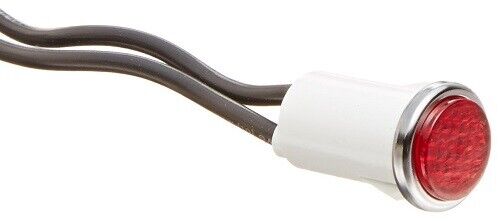

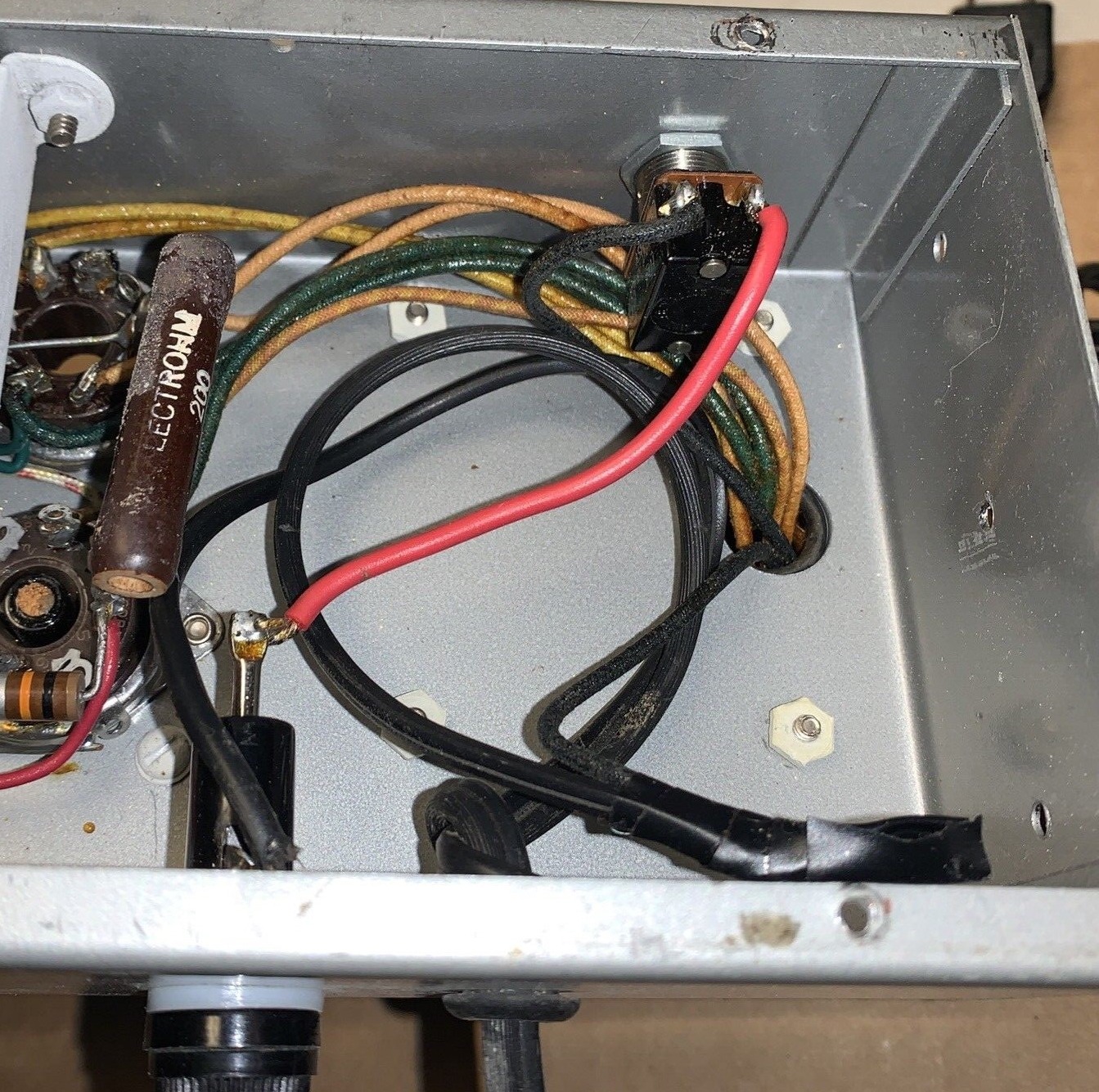

where should i wire in a power indicator lamp on my Bell Air project amp
trying to figure out where is the correct way to go about wiring in a power indicator lamp on my project Bell Air amp.

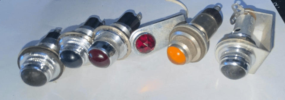

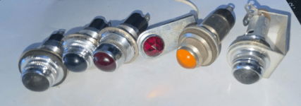

I use different styles of pilot lights. Some LED and some incandescent. LEDs go across the transformer primary and small incandescents across a 6.3v filament line.
