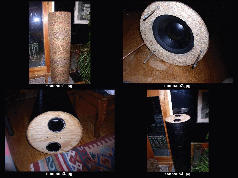

weikertball said:Good, now I just need to get to work. Anybody have any pics of downfiring subwoofers?
All Rel ST series
REL
Sonosub
Built this in 2002 with partsexpress 12" Titanic II I think... ~19 Hz -3dB @ pretty ^&%* loud!
Still pounding away
auplater
weikertball said:oh, I meant some DIY setups. Just curious to see some.
Still pounding away
auplater
