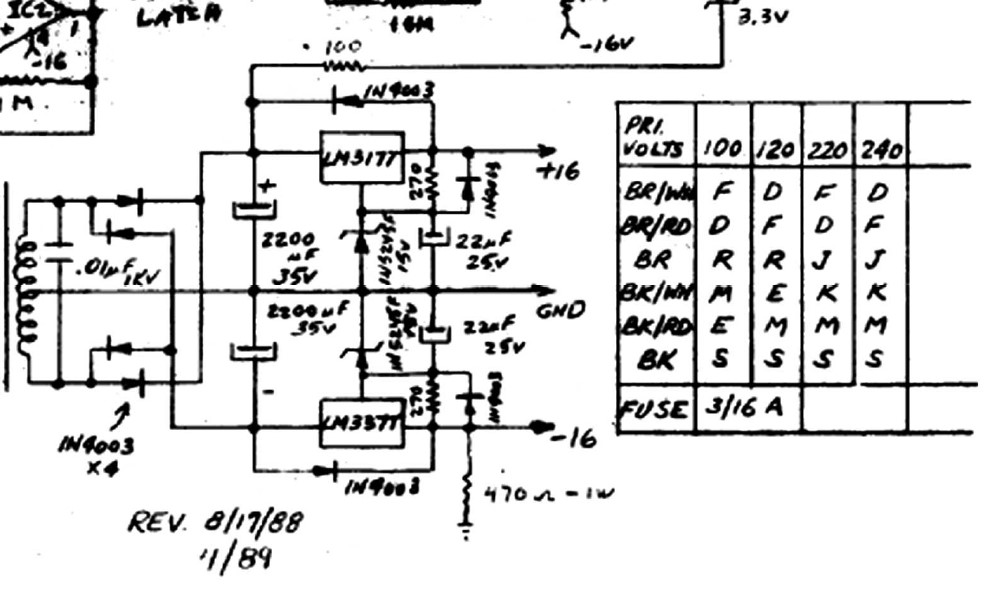

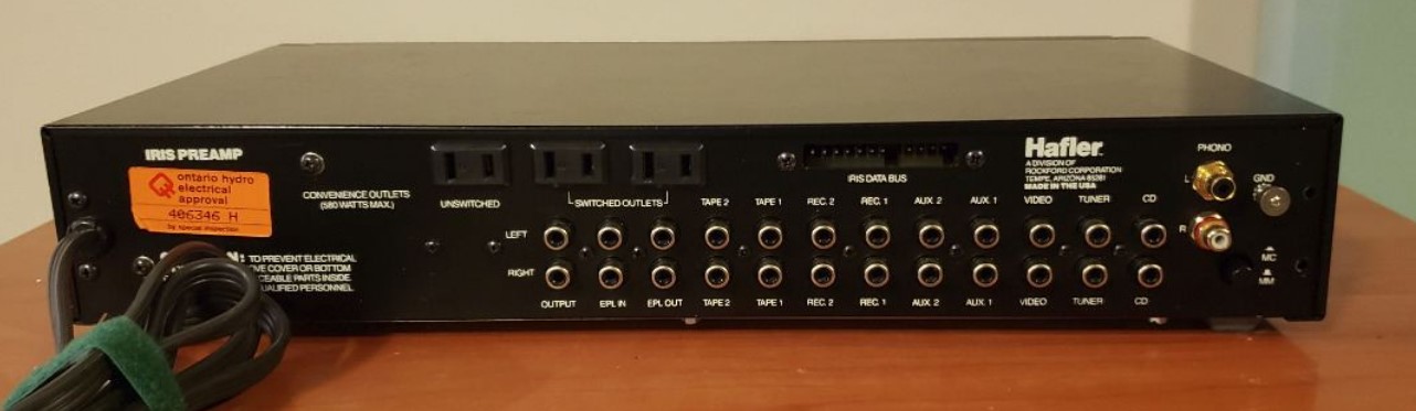

If I'm looking at the right equipment then I found an image of the rear panel that seems to say 580 watts total loading for the three outlets.
A very poor res diagram of the PSU seems to show that none of these outlets are fused internally.
So that leaves the fuse in the unit as really only supplying the preamp transformer... and so if that failed while being suitably rated then there has to be a problem with the unit itself.
My advice would be to isolate the secondary winding and power up just the transformer to make sure it is wired correctly. The power supply is simple and so we can 'guess' that the DC voltage across the reservoir caps will be around 25 volts. The 35 volt cap rating puts an upper limit on things in any case. That would suggest each winding should be giving around 17 or 18 volts AC give or take.

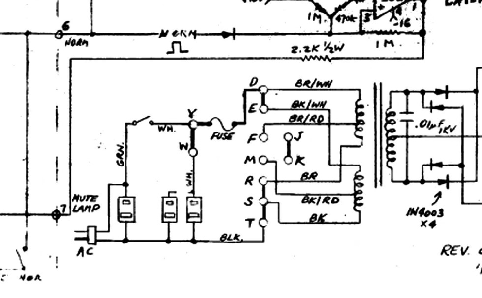

I think I should try to clarify this.
The fuse that was in the unit I'm working on now was properly rated, but it was for UK current. It was 1/10 amp.
The fuse that was donated from my other IRIS preamp was properly rated, but for USA current, at 3/16 amp.
The UK fuse was fine in the USA unit for over an hour and then it blew. Since the fuse was one-half of the rated amperage that should have been in there, I would look at that as a weak spot that would be subject to failure, even during normal use. (As a further bit of info: the fuse pop happened when I was hooking the tuner up. There were three connections to make: power, signal, and remote cable. I believe I did them in that order and it was either when I plugged the patch cords in or the remote cable that the preamp went dead. And since I was adding the tuner while the preamp was hot, I'd think its safe to say that one of those connections could have caused a slight surge in current.)
The USA fuse was taken from a dead IRIS preamp, and it was most likely blown when I put it in, since that preamp went dead while I was doing chip swaps to try to fix lightning damage. I should have checked the fuse with a DMM prior to the install but I just did a visual check. Anytime I've seen a blown fuse, it blows somewhere near the center. This fuse is the first one I've seen that has no obvious open.

Wild... how can that thing survive? Its on the primary side of the transformer, according to the schematic. Can this preamp really be drawing such a little bit of current?
We won't live long enough to back-engineer that blurry schematic. But the actual audio could well be under 30V 20mA. There's LEDs, not all on at once, but some in a devious gain-control scheme. Say another 30V 30mA. And that 30V is regulated from about 50V. So 2.5 Watts of DC. Which tends to be like 5VA of AC.
5VA/120V = 0.04166 Amps
_I_ would not take this at face value. I have seen a 4VA transformer which would not hold on a 0.25A fuse. Teeny transformers can have large losses, even in excess of their rated output. However if neo-Hafler says 3/16A 0.188A then I'll go with their number.
