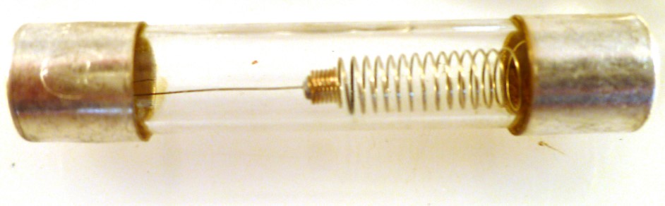

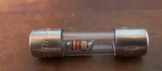

(not all open fuses are obvious and very occasionally they can pass a full visual inspection and still be open. Typically in that case the wire has just parted company with the end cap. That failure can sometimes result in an 'intermittent fuse, something I have encountered just once)
OK 🙂 That is a valid approach under the circumstances, and thanks for the details as well...
It works until it doesn't. Then you pull the fuse to check, and by handling it the wire falls back into place and the continuity returns, so you get a proper reading on the DMM. You think "ok its not the fuse", then you put it back in and everything works. Until it doesn't. And the whole time, you'd be thinking its an intermittent fault in the equipment itself.
I'd probably lose my sanity if I ever encountered a fuse like that. If anyone ever asks you what causes us to anthropomorphize non-living things, I bet you could point them to a story with one of those fuses.
"I swear it was just working! That thing has it in for me!"
And that was how Clark Griswold lost his mind.
