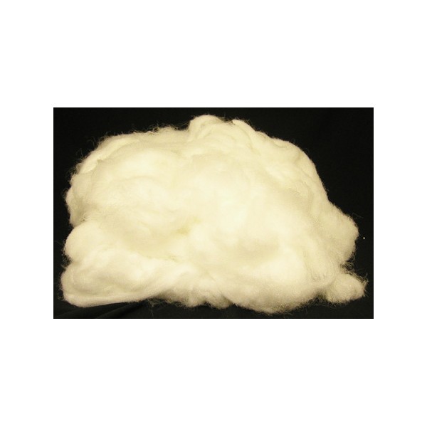

No idea what exactly Bailey's longhair wool is, I've ended up buying white Massam tops with an individual fibre length of 18-38cm. It is the longest they had back then and I wasn't the first to buy from them to stuff speakers.
It was the cheapest source I could find by a margin.

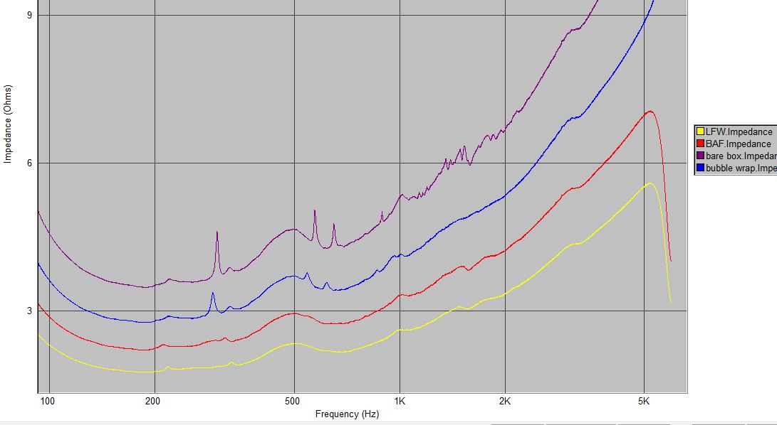

Bailey's long hair wool appears to have obtained mythical signifiance, particularly in Europe, for no good reason. It has no significant advantage over rather more commonly available materials; Monacor's MDM3, fiberglass, ultratouch insulation, acoustastuff, BAF wadding or similar all do a perfectly good job. There are minor differences in the damping behaviour of all materials of course, and more or less subtly different quantities are required (see Augspurger's AES paper 'Loudspeakers on Damped Pipes' for some examples), which isn't a big deal.

If you are determined to get wool as a stuffing material, may I suggest Marino wool. That's not a brand name, but instead, a type of wool that is the finest denier (i.e. diameter) and most expensive wool. Merino - Wikipedia, the free encyclopedia. It looks like they carry it at the site linked in post #2.
Mine and other stuffing studies have shown finer fibers yield lower Fc and flatter impedance plots in closed box systems.

Merino is 21-25microns, vicuña 12.8 microns thick. A bit pricey though.
