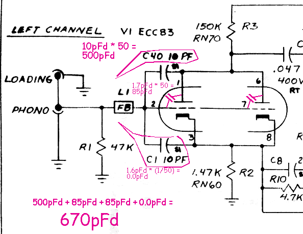

My objective here is to lower the capacitance load my MM phono cartridge sees. According to its specs, it likes 100pF. As things are right now, the 1.2 meter cable and the tone arm wiring are 200pF. Additionally my preamp’s (MFA Magus) phono section has 200pF shunted by 47K according to the manual. So total it’s 400uF not including any Miller Capacitance. I can swap out or shorten the cable as i don’t need 1.2 meters and knock off 100pF.

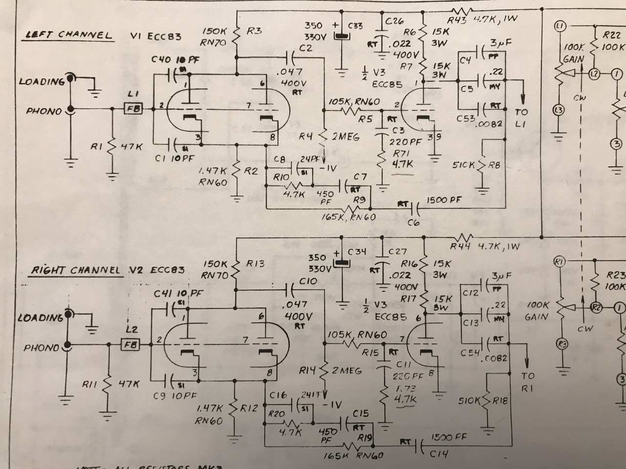

My issue is the caps in the phono section. I’d like to remove them or replace them with a lower value. Only trouble is i can seem to locate them, either by looking at the board or the schematic. The closest i’ve seen is a pair of .22k caps (C3 & C 11). I’m attaching the schematic hoping someone can take a look and advise. I’d appreciate any guidance. Thanks

No. According to your schematic there should be 2 additional RCA jacks labeled as 'LOADING'. That is where additional load resistors and the capacitors would be connected. Do you see the jacks? Is there anything plugged into them? If there's nothing connected then you already have NO additional loading capacitance. If there is then unplug them to remove the extra capacitance.

I suspect the stated input capacitance is the internal capacitance of the circuit/tubes. It's inherent to the devices. You can't lower it, only add to it. You can't remove any other caps from the circuit either. They are all needed either for coupling, compensation or RIAA filtering. I wouldn't fret too much over a few pF, it won't make that much difference. Changing the resistance slightly will make a much bigger change in sound, if that's what you're after. Or a different pre.

Capacitance is everywhere. There's some inside the input tube. This is multiplied by stage gain, "Miller". We expect about 90pFd from this cause alone. We expect another 90pFd from 3 feet of cable. And a few dozen pFd of "stray". That's why "most... 200-300pf".
BUT. Never trust the data sheet. The guy who writes these may not be talking to the guy who built or designed the electronics. Here we have C40, a stunning 10pFd of added capacitance, Miller-ed. That may be 500pFd right there. Each unit of 12AX7 has 1.7pFd, Miller-ed.... and they put both sections in parallel!
IF this much is true (don't trust the schematics either), then you have over 600pFd before you add the cable. Even an old Grado may be dulled by that much capacitance.
Why not cut-out those 10pFd? Typically such caps are added ad-hoc to reduce oscillation or radio interference. (Note the high part-number, 40 may be that last part added when it squealed in use.) You could be sorry.

Thanks for taking the time to illustrate. Just curious, how does 10pF become 500pF?
