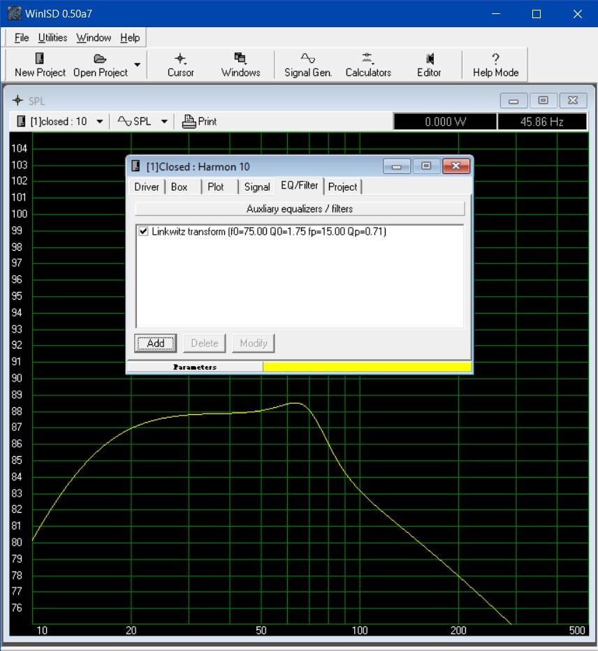

Those woofer should work fine. Look at using the Linkwitz transform. WinISD can model a Linkwitz transform so you can predict the end response. This filter will simply cancel out the high Q of the driver in the box and substitute in the low frequency response you desire with a low Q. If the drivers have sufficient Xmax to produce the bass you desire the other parameters really don't matter that much. I would build a half cube shaped box segment for each driver. Maybe go with 1 to 1.5 cu ft for each 10" driver. You can use a series parallel combination to get an impedance that is easy for an amplifier to drive.
Here I modeled a single woofer in a 1.5 cu ft box with the Linkwitz transform parameters shown in the window. I wasn't sure what the Xmax was so the maximum SPL is not known.
I think the EQ is accomplishing the same thing. The previous calculation indicated using 80V to drive an individual woofer (if that was 80V RMS that would be 533 Watts) That seemed high to me. The maxSPL calculation in WinISD fails with this woofer. The SPL plot shows it hitting X max at 16 Hz at very low power levels. In any case, a typical 10" woofer can handle 100 - 200 Watts and in a 1.5 cu foot box I expect such power will easily drive these woofers past the Xmax at low frequency, in this case 15 or 20 Hz. So that's all the SPL you can get out. You don't get more than Xmax. So it takes 150 or 200 watts per woofer. That's exactly how every small volume sealed subwoofer works. Go find an amp that can supply 150 - 200 Watts for each woofer and you have a good solution as far as I can tell. Building a single 1.5 cu ft box could verify the design at low expense.
