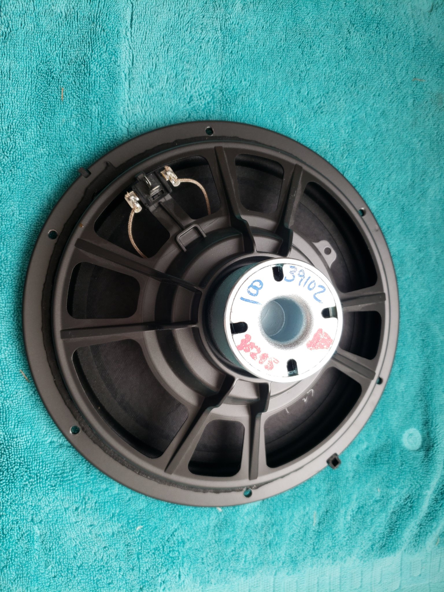

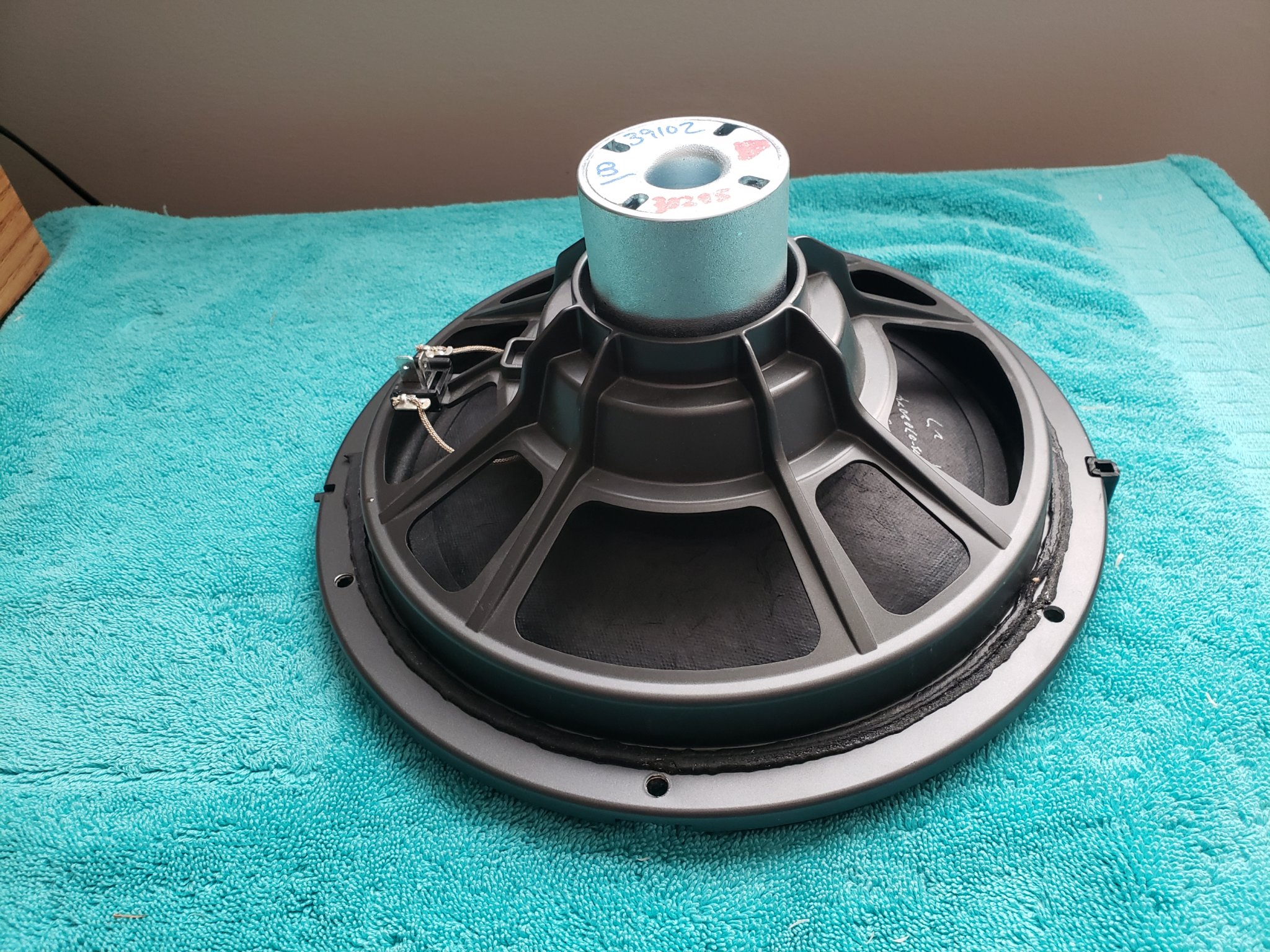

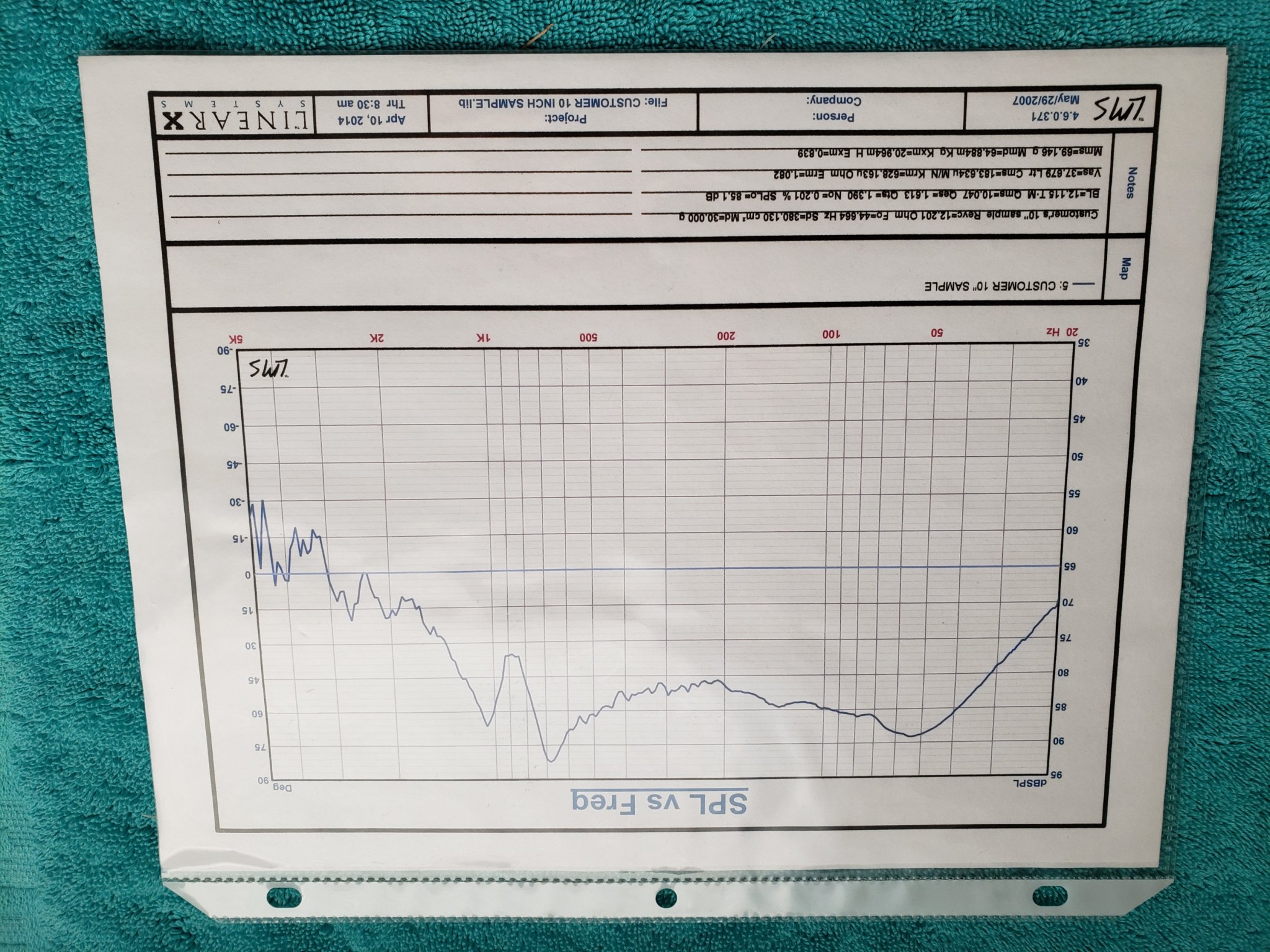

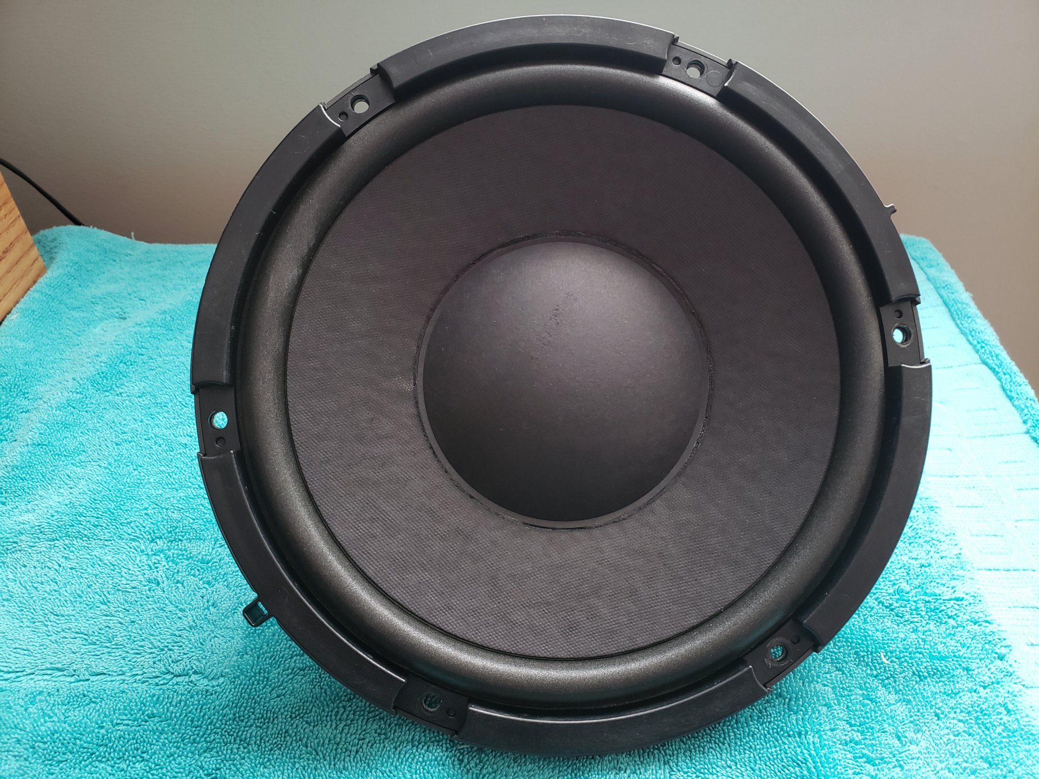

I have quite a few of these interesting drivers. these were Subwoofers for the Mark Levinson audio system in Lincolns i believe. I got these from an Audio Society member that used to work for Harmon I think it was, that did the design work on the high end audio systems. These are a 10" Neo driver with a 12ohm Impedance. I was told they wanted to minimize the current draw on the electrical system so they designed an amplifier with plenty of voltage swing and a 12 ohm driver to minimize the current draw from the vehicles electric system. apparently the exec's did not like it when the bass would hit and the lights would dim.

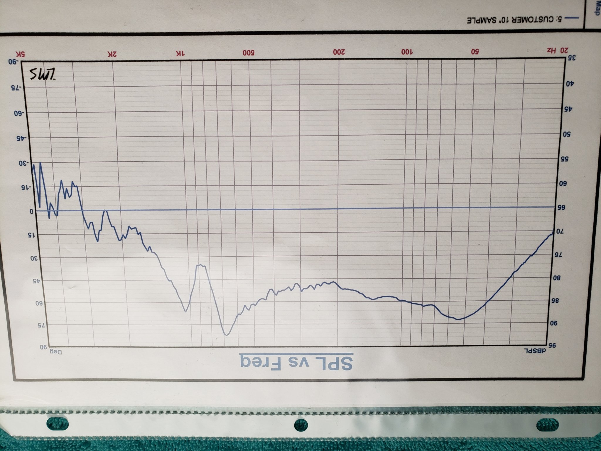

I had a friend of mine at MISCO (Minneapolis Speaker Company) test these and they were quite impressed with the Klippel linearity on these. My Thought was to use 12 of them, 6 per 7' tall column wired for 8ohms (Three in parallel = 4 ohms, then series wired with another Three for 8 ohms), Or possibly depending on what amp i use, wired for 2 ohms per column...
As these will be used for home use. the large amount of cone area, should limit cone excursions under normal listening levels and hopefully reduce distortion. at least in theory was my thinking. Not sure of the specs of these drivers are really suitable, but i figured i would give them a try. just need to figure out how to design a cabinet for them. an ELF type system seemed to make the most sense to match the design athetics of my Duntech Speakers

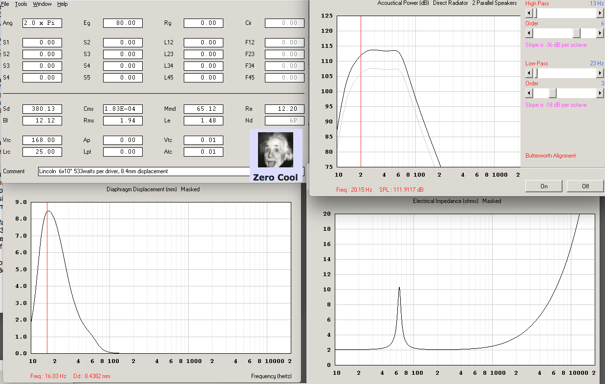

I was hoping that in a small sealed enclosure and then EQ'd flat, they would work. they were designed for subwoofer duty, but albeit not as low as i want them to go. 12 of them in a room would not have to do much work i would think. I just dont like big flabby sloppy woofers which are all the rage these days. i want fast, clean and articulate infra bass. and...I have more than a dozen of these already and want to do SOMETHING with them.
They will make a fair amount of LF in a small enclosure EQ'd flat, but will require a lot of power to do so.I was hoping that in a small sealed enclosure and then EQ'd flat, they would work. I have more than a dozen of these already and want to do SOMETHING with them.
The EQ in the sim is just for illustration of what is possible.
The impedance is 2 ohms 10 Hz to 40 Hz for 6 drivers in parallel.
80 volts into the 12 drivers (533 watts per driver) would do about 112 dB at 20Hz at 8mm excursion in one cubic foot (28liter) per driver half space. Increasing the cabinet volume to the size of the Duntechs or a bit larger would make little difference in output. Room gain and wall proximity could increase LF considerably.
The 12 drivers should have no problem supporting the four 9" 5.5mm Xmax Dynaudio 24W75 for clean and articulate bass lines.

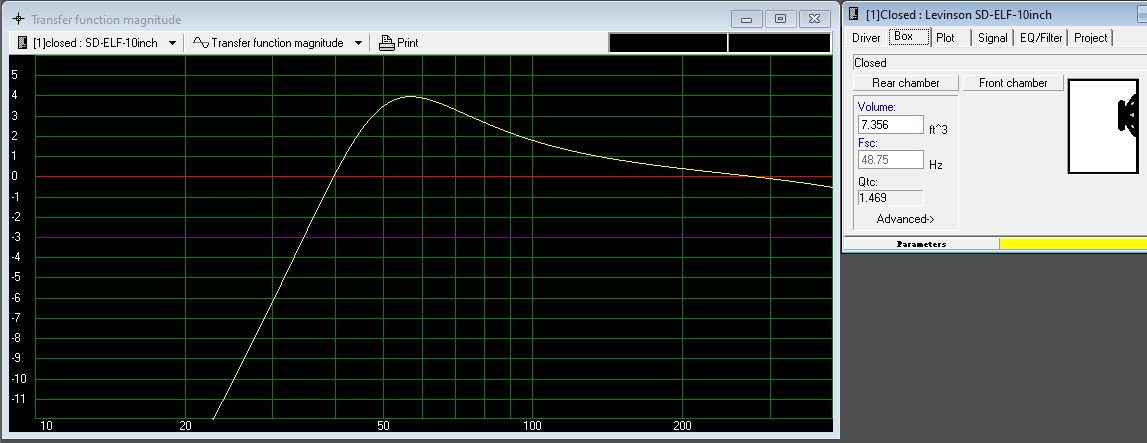

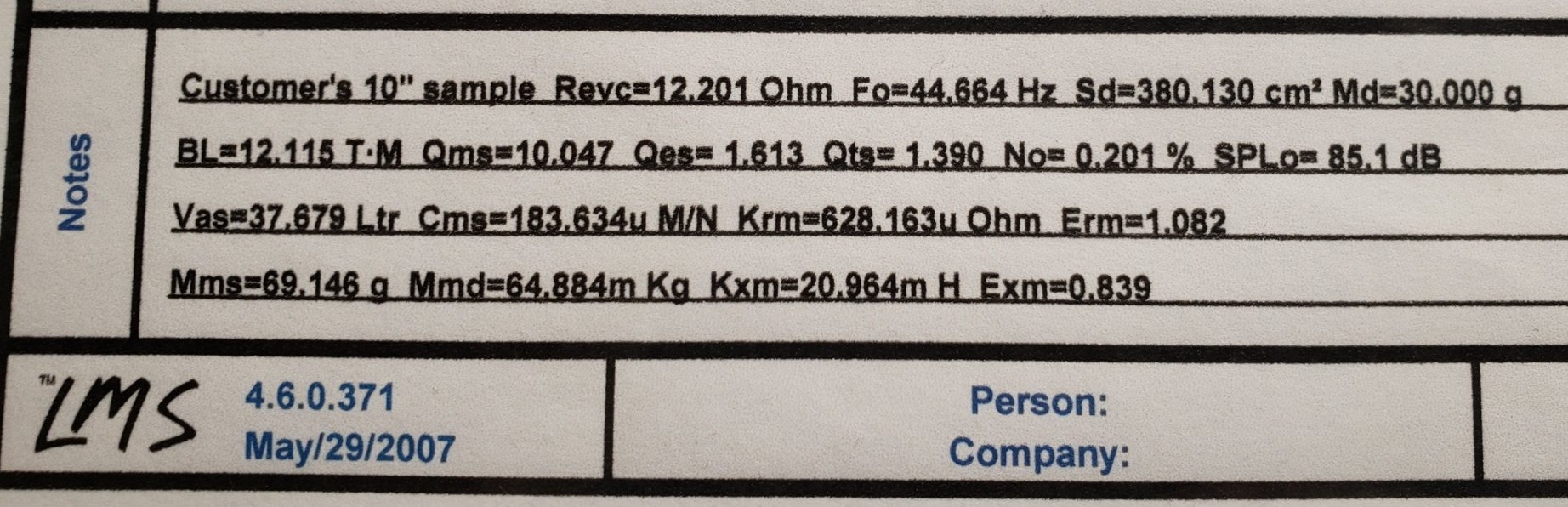

All of the box calculators i have tried don't like the Qts numbers of these drivers??
Depends on modeler.
Most are looking to calculate at .5 .577 or .707 Qtc
.577 being " flat" driver response or equal ripple
The overall mechanical properties of this driver don't allow
Qtc to be much lower than 1.5
Which is very high, so the modeler is basically saying
it is impossible to get equal ripple response.
So response will never ever be flat.
Being a " special design" driver
it is not even designed to be flat.
To even achieve very very high Q response
at 1.5
The driver needs about 7 cubic feet.
To me this basically smells like a " custom designed"
speaker to achieve a big 50 Hz boost in a car application.
like a lot of typical car subs.
Most 10" mechanically designed to work in a " enclosure"
1 to 2 cubic feet.
This case it seems more designed to be mounted on, or near a 'rear deck'
where there is no enclosure. The enclosure is the trunk or car cabin itself.
And average trunk 5 to 9 cubic feet.
So no this speaker does not like a tiny box.
and definitely wont like being in a tiny box then over Equalized.
more suited for a car trunk with no enclosure.
providing 5 to 9 cubic feet of trunk space.
Otherwise in HiFi might make a good woofer
not sub woofer in open baffle.
either way its designed to be a subwoofer
that makes a dominant 50 Hz " knock"
or not a flat response. And to even achieve
a very un flat peak. needs at minimum 7 cubic feet

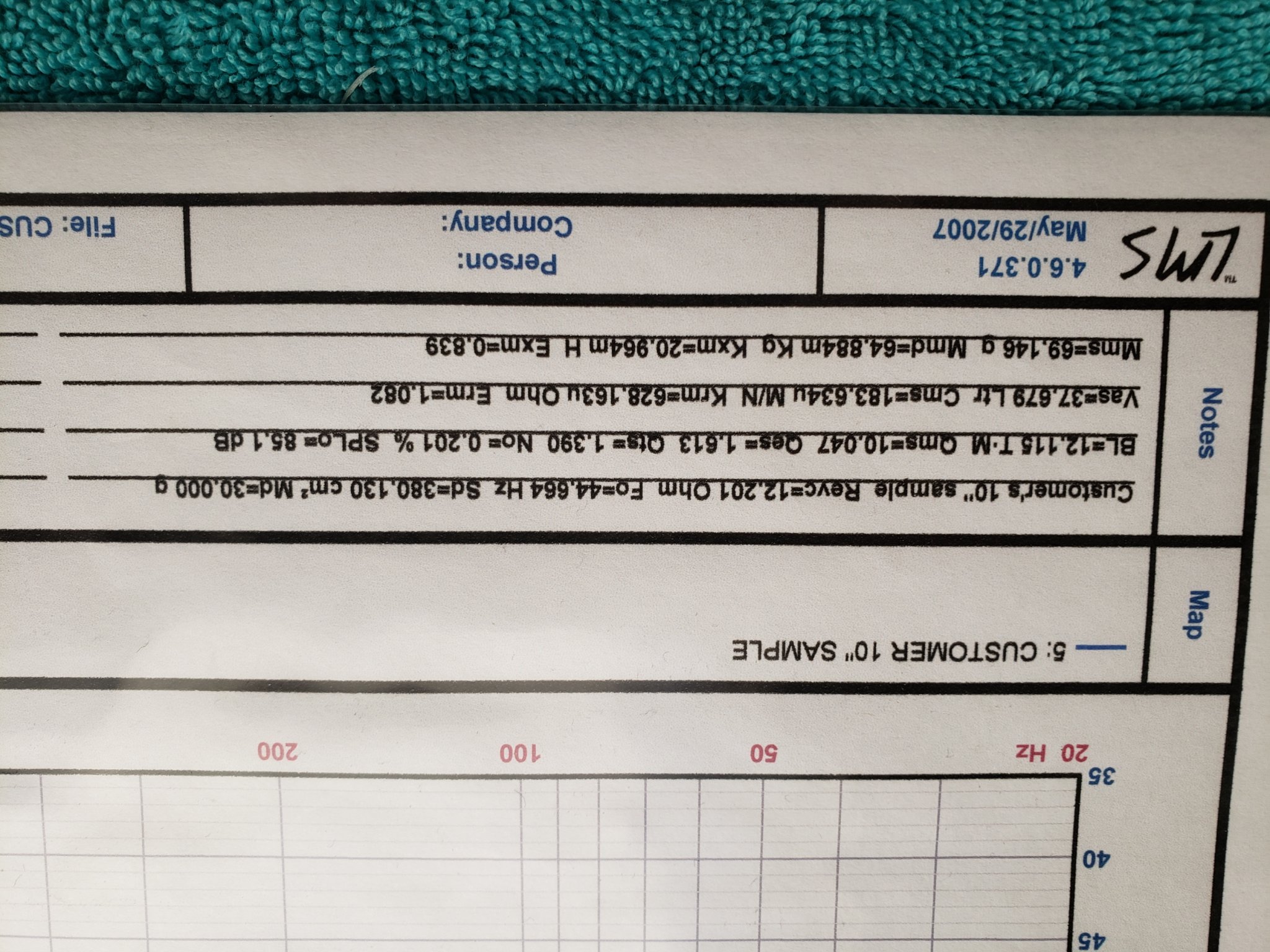

Getting back to the thread question. In reading the ELF whitepaper which I posted, it indicates that the box size does matter. It should be sized to provide an acoustic suspension resonance frequency which is at, or just above the signal pass-band. Which, then, necessitates that the subwoofer driver fs support enabling that high resonance frequency. The design example discussed in the whitepaper has a box/driver resonance of about 90Hz. Which is at the upper limit of the sub's intended signal band. This is done to obtain the predictable 2nd order high-pass acoustic response roll-off which A.S. systems provide below resonance. The resulting relatively small ELF box is only an incidental benefit. You don't, however, want the box/driver system resonance to be much higher than the signal's pass-band either. Although the box then becomes even smaller, the sub's power amplifier is more greatly tasked than is necessary.
Most box modelers attempt to give you the box volume for a Q = 0.707 (maximually flat). That is impossible with this driver because the driver's own Qts is higher than this value and the only possibility when you put a driver in a box is for Q>Qts.All of the box calculators i have tried don't like the Qts numbers of these drivers??
