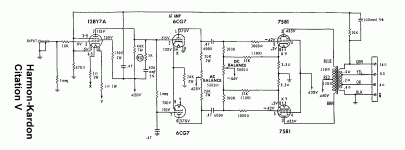

Hello everyone,
Looking at the 12BY7A, how is it that the screen can be higher than the plate? My understanding has always been the plate is higher.
Thanks,
Ray

Typically, receiving tubes are safe with plate voltage higher than 30-100V, or 1/4 to 1/2 of Vg2. Transmitting tubes are typically higher, of course.
As shown, the tube can never draw excessive screen current due to the large series resistance. However, this affects distortion and makes the input impedance particularly bizarre, because as the tube goes into saturation, screen current shoots up, screen voltage falls and miller effect comes into play on Cg1g2. Effectively, the amplifier slows down as it goes into saturation, which is undesirable.

Considering the designer was Stu Hegeman, you can be certain he had good reason. An obvious fact is the high gm of the 12BY7. That high gm provides resistance against slew limiting. The Cit. 5 employs Mullard style circuitry and a good deal of GNFB is present. Slew limiting is always a concern under those conditions. A possible tweak to the Cit. 5 is employing an ECC99, instead of a 6CG7/6FQ7, as the LTP. Stu didn't have access to the '99, with its high gm, back in the 1960s.
IIRC, the graphic is not error free. Check Jim McShane's site out for info. on tubed H/K Cit. units. Jim's expertise in this area is unrivaled.
I believe your schematic in incorrect. Here is a partial scan of an original HK document. Notice the voltage chart in the lower left. It calls for 145v on the plate and 140v on the screen. And the screen bypass capacitor is in the wrong place on yours as well.

The 6AV6 is a real pipsqueak with a Pd= 500mW. Not much drive capability there, and the 6CG7 LTP probably isn't gonna present a 6AV6 with a very friendly load.
The 12BY7A is a real beast, having ratings more like a power pentode, as it was intended as a color TV video amp. As such, it likes high voltages (no shortage of that in a color TV) and the plate characteristics in the spec sheet are plotted against a screen voltage of 180Vdc, though it has a nice looking plate characteristic down around the -6.0V region (where this seems to be operating: Ip= 6.0mA). Dropping screen voltage and bias would keep the plate current the same, and get the screen voltage under the plate voltage where you want it.
6AU6's seem to be at their best with Ip= ~3.0mA, so may have been lacking a bit in the drive department, and perhaps y(f) too, despite working the 12BY7A at such a low plate current?
Could you briefly explain why?
Almost every text on hollow state tells you that tubes not driven into grid current require just voltage, not current. That isn't just an over simplification: it's just plain wrong. Even if Vgk never goes positive, the grid still had capacitance associated with it: Cgk + Cmiller + Cstray. The grid won't see the true signal level until that capacitance is fully charged, and it takes current to charge a capacitor. The faser you want that capacitor to charge, the more current you need to pump into it.
Take a look at this loadline. The driven stage will be demanding the most current when the 12BY7A is least able to supply it. When the plate voltage comes up, the potential difference across the plate resistor goes down. The ability to supply current to the load is:
I= (Vpp - Vplate) / Rp
That's why it's a good idea to make sure the Q-Point current is at least five times the peak current at the highest frequency of interest, and why the 12BY7A was designed in the first place: as a color TV video amp. Even though you try to make CRTs in such a manner to minimize internal capacitance, you can't completely eliminate it. Since you need to drive the cathodes of the color CRT at a max rate of 4MHz, it takes a pretty stiff current to charge that capacitance, even if it's held to picofarads.
If you use a tube with a high y(f) -- like the 12BY7A -- you can get the gain and the linearity with a much smaller plate load. The smaller plate load, the more current reserve.
This is something that gets overlooked a lot in audio designs. No way can something like a 12AX7 drive the grids of an audio power final, and keep up with the current demand. If there isn't enough current, the control grid(s) of the final(s) won't track the signal. That's the slew rate problem.

The problem with that Cit V design is that it uses an extremely high level of gNFB. That would explain the 12BY7A: needed to drive up the open loop gain to get that gNFB and maintain reasonable input sensitivity.
"However, it has a large capacitor at the pentode anode (430pF) which creates the problem I thought we were trying to avoid".
That 430pF capacitor is part of a Zobel paralleling the plate resistor. This is necessary to improve the phase margin at high frequencies so that you can run up the gNFB even more. Crowhurst's book, High Fidelity Design devotes four chapters to that very thing: phase corrections at both ends of the audio band for running up gNFB. That, too, just doesn't fit with my design philosophy, and excessive gNFB makes for a very solid statey sound. I don't need much more than 6db of gNFB, and 20db made a hollow state design sound as bad, if not worse, than any solid state design from the Big Box store.
. Cutting that back to about 7db was right.

I find this unlikely. Three reasons:
1. To be perfectly pedantic, tubes rarely go into slew rate limiting per se, due to their relative linearity and the simplicity of circuitry they are found in. Slew rate limiting is a nonlinear (current saturation) phenomenon, typical of differential solid state amplifiers with current sources and mirrors. That said, larger tubes have lower output impedances (or drive lower impedance loads), achieving higher GBW, so the effect is similar, but it's the result of a linear process.
2. The 6CG7 is hardly a difficult load to drive. With Cin totaling under 100pF, this circuit is a good start for a wideband RF amplifier. Except that,
3. The designer rolled off high-frequency response intentionally with a pole-zero network across the 6CG7 grid.
I'm not sure what you mean by this. The goal of NFB, properly implemented, is to reduce gain, which reduces HF gain necessarily. The only condition that comes to mind where slew rate limiting would be a concern is a dead band in the output, such as a class C (unbiased) complementary emitter follower exhibits (similar circuits can be built from tubes, though they usually aren't, for obvious reasons).
