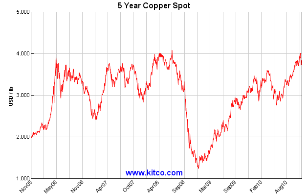

Take a look at the chart. It shows the 5 years copper prices, base material for all XO's. Despite the down-turn, the current price is now over pre-crash levels. Price hikes, thin margins, it's not lazyness or apathy Drew, it's more serious than those characteristics. Welcome to the dog-eat-dog world of the high street consumer brand, (hence my check-list for high street shoppers in previous post). Don't expect many nice XO's anytime soon, unless you want to write a nice big fat cheque or kill your credit card. Even then, there's no guarantee the speaks will be acoustically good.
Cheers
Mark.
