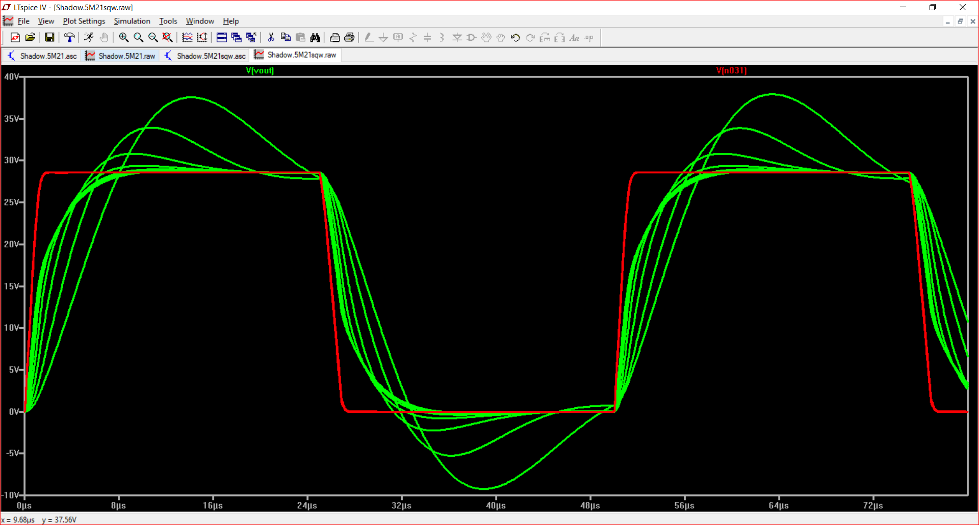

This wish prompted me to look a bit deeper into your circuit I had assumed from the fact it was stable at high power with 2uF//8R it would be satisfactory at all signal input levels with 10kHz square wave with a variety of capacitor values - smaller ones excite higher hf resonances.
As your actual hardware stands you have C212 in place but not the 270 pF capacitors I found a patch of oscillation at the bottom of the falling wave at lower outputs - so you are not quite in the clear with this.
If you leave C212 and fit the 270 pF capacitors what should be the flat tops and bottoms of the square wave are warped.
The situation is not improved if C212 is removed and the 270 pF capacitors are fitted either.
C212 leads feedback from the Vas back to the inverting input bypassing the inevitable delays in the output stage while C203 leads the delayed signal from the output back to the same inverting input which sums the two together. The best analogy to describe this is like the echo from a public address system in a hall - hard to understand.
My answer to the problem is to delete C203 and double C212 in value to 4.7 pF.
My modified simulation and a screen shot of the square wave with various parallel caps are attached.

If only one point of the circuit is displayed the multiple plots show in one shot distinguished by different colours - first screen shot.
The second shot shows that the waveform at the feedback take-off point is not disrupted by the load with the various parallel capacitors - more on this later.
If you look at the rising slope in this shot it is possible to get an indication of slew rate at various points.
Settling time is that from zero volts to flat at the top of the square wave - there are no overshoots or ripple at top or bottom in this simulation.
There is a little rounding on the corner near the top. Laying the cursor across the flat part of the top the reading shows on the y scale at the left in the bar at the bottom of the screen as 28.6 volts.
Moving the cursor to the point near the rising corner at the top avoiding the rounded portion shows the x time scale as 1.83 us. Dividing this into 28.6 volts gives 15.6 V/us - a a bit rough but close enough.

The 10 kHz square wave test is to check loop stability.
The natural increase of a coil impedance with increasing frequency in combination with a load including any capacitor will generate more resonance. The displays in the first screen shot represent frequencies outside the audio range - they are not to be taken as signs of any problem therein.

The first step would be to do a square wave test on your prototype as built with a few of the lowest value capacitors used in the simulation// 8R test load with a level input signal - it was at low level that I saw the signs of instability in my simulations.
Next photo the screen shot and compare the image with that of your .raw file result for the same test conditions.
When making changes do this one step at a time and with each step compare the channel that has been modified with it's unmodified partner.
You can step left or right with either channel as you go forward and backward in direction if you meet a with a problem.
With regard to increasing C212 to 4.7pf that was the lowest effective value than served as a cure.
There could be a need to experiment to find the needed value due to the properties of circuit board material wiring and layout etc.
You might find one channel needs a different capacitor value from it's partner.

I think it's time to update on further developments this project could get to, thanks to Michael Jonassen (Mjona) from New Zealand and Giancarlo Foli from Italy.
Intensive LTSpice modelling was applied to the original version particularly using Tian Probe sims to look at stabilization margins.
If there's anyone around interested, I can upload the different asc files for you to see, sim and comment.
The project seems now ready for prototype building, with what seem to be better specs and stability.
The 5M21 proved better than the L10 in the simulations, much more stable too. The 5M21 also simulates with much better results than all the family of "brothers", like the L10, M12 or B12.

Here are the latest asc files for Shadow 5M21, the clone that is not a clone.
My major concern was to keep the original architecture as much as possible, so no major changes there.
The simulation specs seem even better than the original design, but real life parts may probably shatter that finding in the actual prototype.
The three major areas that were worked were THD, square wave and Tian Probe. Please feel free to play with the simulations to get other results.
The original gain ratio of x32 was kept, but the resistors pair was changed, from 47K/1K5 to 32K/1K. Using the latter improves the gain margin from 12dB to 16dB, and the phase margins from 58 degrees to 62dB.
THD gets a little bit worst with this new pair, but the difference is too small to care about.
