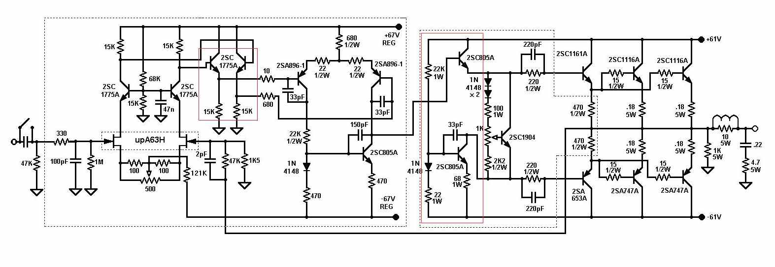

Now let's go back to the inspiration.
Before anybody asks me: the only difference between models 5M20 and 5M21 was that the latter had VU-meters.
Most of the LTP parts were assembled separately on a discrete IC, which I won't be using on the Shadow. As you can see, no active part made it.
The parts inside the red lines will have to go on two piggy backs.

Another important thing I won't be able to keep on the Shadow is that the original amp was pure-DC, with no capacitor on the feedback.
Of course I will add a DC protection and I will try to see if that is possible on the Shadow. But I don't think it will. So the options are a feedback capacitor or a DC servo. I will try both ways and see which sounds better. Or at least more similar to the original Luxman.
Perhaps what we are calling the pre-driver is just a buffer stage, like they used after the LTP. They used a similar configuration on the B12 and M12. But not on the L10.

The L10 sims very very well, with very low THD at 1KHz and 20KHz. The only thing I could not tame, as I did in the 5M20, was a glitch in the sinusoidal in the LTP. The curve comes clean after the VAS. Someone told me that was on purpose, to increase linearity in later stages.

If you ran the sine input signal, have a look at the spikes on the LTP. I wonder if it's something that can and/or should be corrected.
I tried several ways but I could not tame the spikes. But as I said, they disappear after the VAS stage.

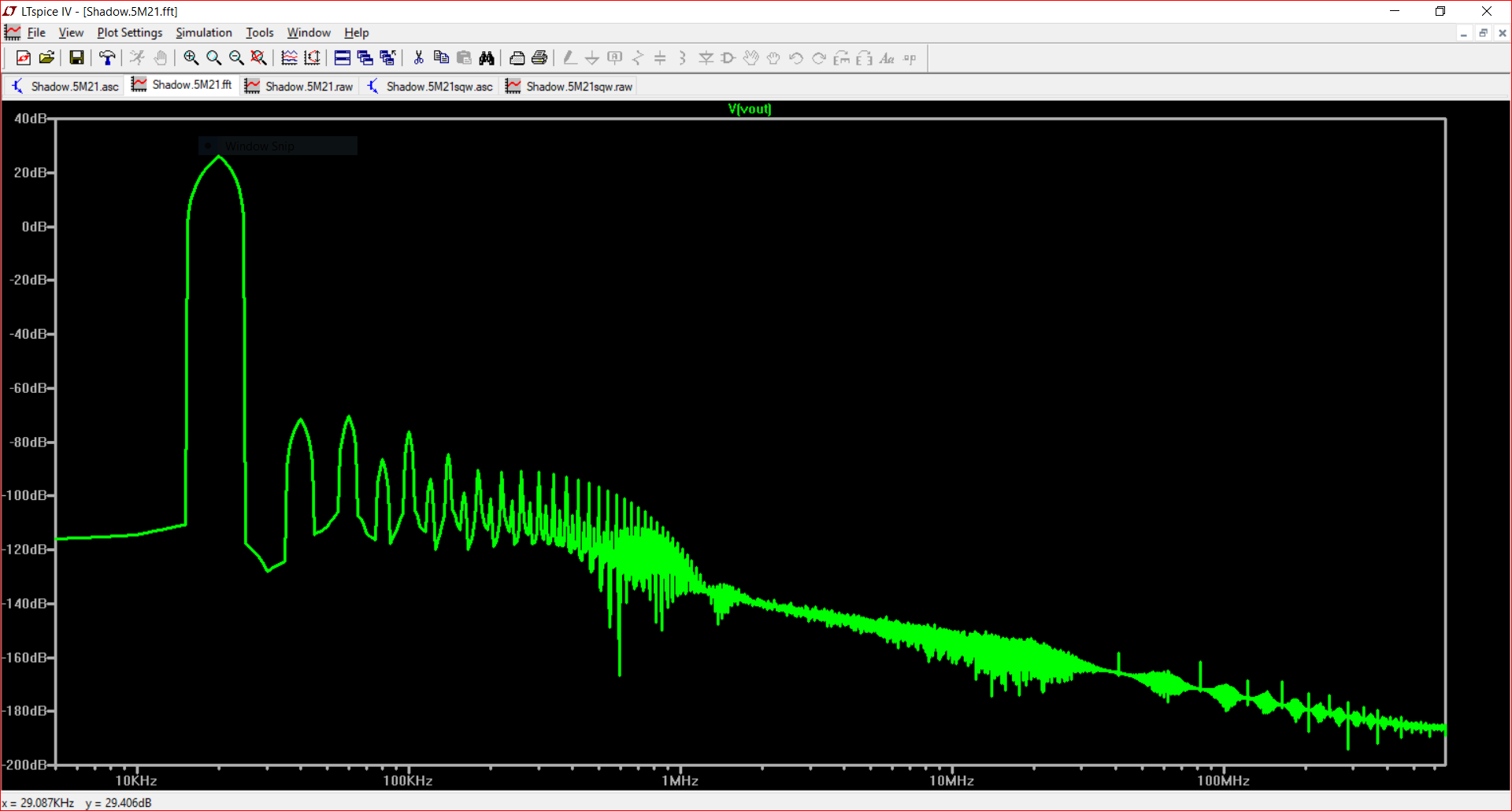

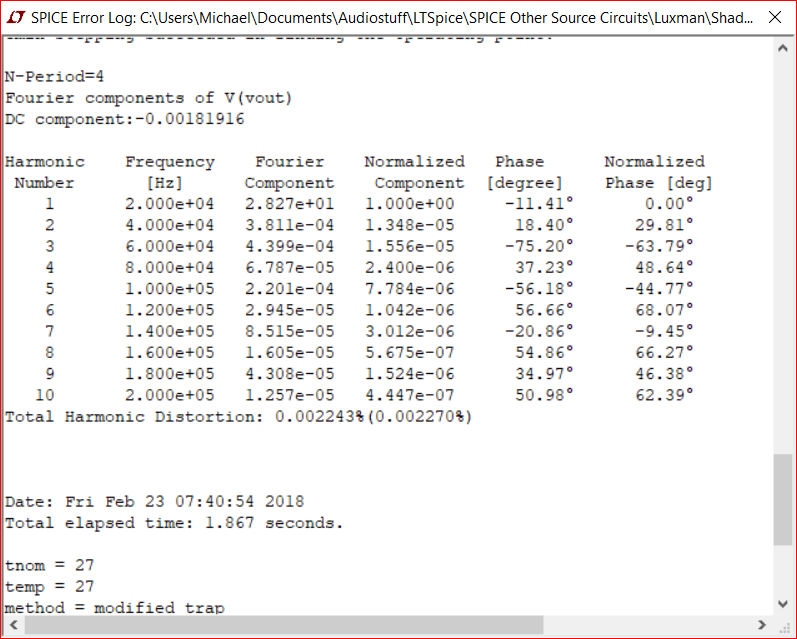

You mentioned fitting C306 and C307 both 270 pF to the back of the pcb - testing the THD with a 2uF parallel cap and 8R on 20 kHz sine wave there was no real difference with 0.89 volts input.
By the very finest of margins leaving them out was better under those conditions - but the situation could be reversed at a lower signal input and a lower frequency although I have not looked.

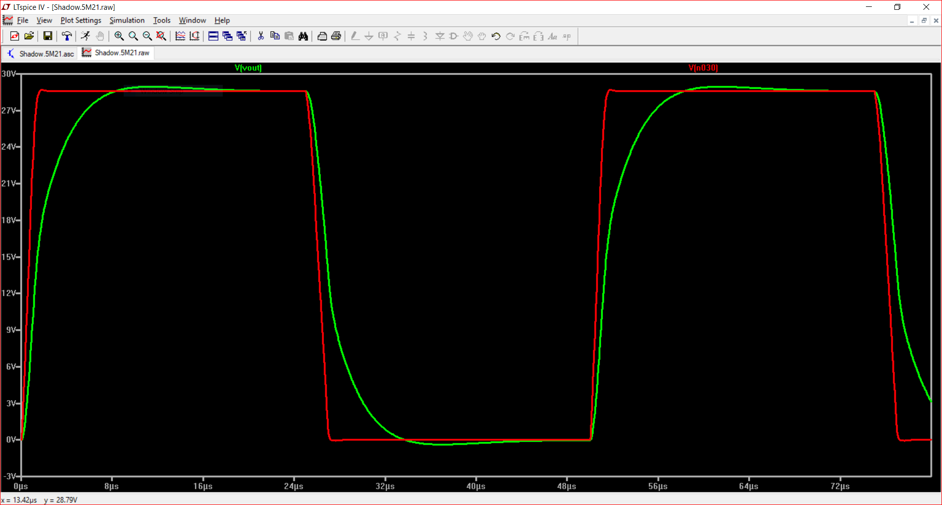

I also looked at the 10 kHz square wave test - the circuit holds up well with a 2uF parallel with 8 R showing the feedback loop is stable.

Congratulations on these fine results - I'm impressed here are some screen shots to bear witness.

There is an extremely fine margin in the THD simulation when the 270 pF capacitors are in circuit or not.
You are using higher performance output devices with 30 MHz unity gain capability against original types with 10 MHz and 15 MHz specification while the circuit still uses compensation capacitor values around the voltage gain stage appropriate to the older devices.
The simulation says your amplifier will deliver high power low distortion at 20 kHz into 8R//2uF - no small achievement.
270 pF capacitors may have been useful as insurance in the early development of this circuit but there has been one small but significant change where C207 - a 33pF Miller capacitor in the original circuit was increased to 150 pF.
In my view that change makes the 270 pF ones redundant.
