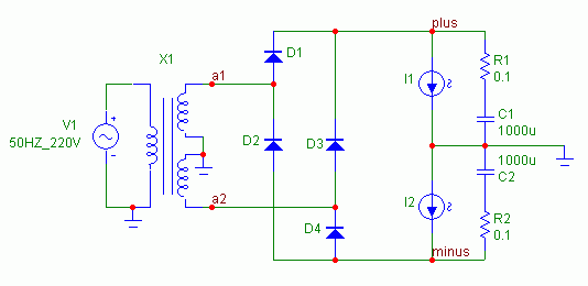

I tried to interprete the graphs by Pedja, and I come to the following conclusions:
Extra ESR (or extra wiring resistance in the xformer, which leads to the same) makes the current pulse "flatter" and thus reduces hf content;
All other things being the same, increased load increases the rippel (of course) and from the fft's I think this increases the hf contents. In the graphs the carrier level drops but the harmonics stay about the same which means relatively more harmonic content.
Do you agree Pedja? How about those graphs with log vertical scales?
Jan Didden
Here they come, logarithmic Y axis. Cap’s ESR is 0.1 Ohm.
1000uF and 100mA:
1000uF and 350mA (certain troubles begin):
And yes, finally that interesting fact can be seen below: higher capacitance can make higher noise floor at HF. Explanation goes like “it is made by those short duration pulses (which have wide bandwidth in the freq domain)”.
10000uF and 100mA:
10000uF and 350mA:
So, as seen above, the second interesting thing is, excluding the bottom end, this 10000uF likes better 350mA than 100mA load.
Again this might not be the technical answer on “why low capacitance supply works?” question. Oh yes, it works. But IMHO it is not the answer. At least, not the whole answer. YAMV*.

Jan,
Extra ESR of the cap makes current pulses lower in amplitude and longer in time. Difference is bigger as it is bigger the drawn current. As you pointed out, added series resistance has similar (though not exactly the same) effect. But generally, noise floor is higher with higher ESR or added series resistance (I am not talking about the noise suppression, it is still only about the noise generation).
I think we all can agree that the career has lower amplitude in the case of the bigger caps and less drawn current. Generally speaking you were right claiming that the excessive large caps can cause HF problems. But as with all the problems in this world, it is the question how serious they are.
Pedja

Well said Jan,
From my point of view, i agree with every word, and not taking in consideration pedja's modeling or testing myself, just as an understanding of this efects on my humble mind.
Christer, I actually made these graphs having the transformer (.subckt) in circuit but values used shouldn’t relate to any real transformer. As about the transformers, generally their R is pretty low, L is pretty high but AFAIK you always have some pitfall. As about the diodes, I tried some others in this circuit and yes they do interfere into the look of these graphs. Gen Semi’s models of SB560 Schottky which I in fact use make these graphs looking very nervous (like the left half of the two later graphs). Hence the simulations I posted here should be understood more like the orientation of what happens, no more than that. My impression is that a lot will depend on the actual implementation and used parts. I like SPICE to model the filters, to determine operating points, to estimate the stability and even to estimate the distortion (yes) and some other things as well, but this is the area where I don’t believe entirely that the right thing can be easily made. Finally, my original intention wasn’t to get the insight about the whole circuit but about one partial phenomenon – influence of the capacitance value on the noise generation. If I had success trying to isolate that phenomenon then I done something.
So Jeremy, whatever I posted here, only the measurement will be the right thing. Can’t wait to hear your results.
Pedja
(circuit used for sims below)
Pedja

First, again the graph without the superimposed signal (as the first graph in the post # 82) but, for the convenience, here showing somewhat higher bandwidth. 1000uF cap, 0.1 Ohm ESR, 100mA
AC voltage source 10kHz/10mV put in series after the rectifier
With higher drawn current, as the noise level starts to become higher anyway the differences between these two graphs at the HF start to become smaller but, of course, base freqs (10k and first harmonics) of the injected signal remain.
However, note that this is more serious problem than it could seem at the first sight. The simplest answer is: such signal will make problems. But the source of such signal shouldn’t be a voltage source in series after the rectifier, in reality it is rather a current source in parallel with the cap (a second device plugged to the same supply). Anyway, a lot will depend on the cap’s AC properties. And diodes are definitely important here.
Of course, the source of the external noise can be also at the transformer’s primary side, right at the secondary, between the secondary and the rectifier… Seems to me like a huge topic.
Pedja
