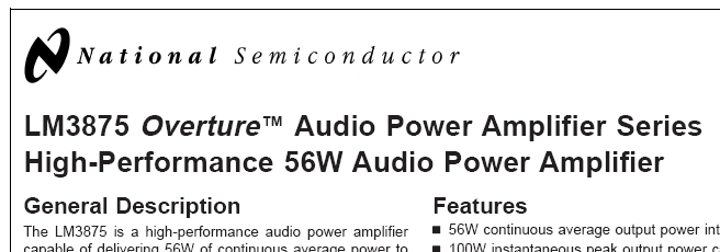

Mesh said:When ever i have built power amps, ive always used large filter caps. How come the gainclone only has 1000uF per channel?
What happens if you use lots of uF's in a gainclone
yup , that was the original question 🙂
well Mesh,
did u ever think why a simple op amp circuit doesnt need a 10000uf filter caps ?
thats because the size of the filter caps is depended on power output .Most chip ams are rated at < 50W so less capacitance needed , plus chip amps got good psrr and low "on" current .
One more reason : those chip amps are intended for applications that require small space ,thats why in the application notes u see small filter caps , this is the minimum size required .
there is nothing wrong with using large filter caps for any amp but too much wount do any good eather .
