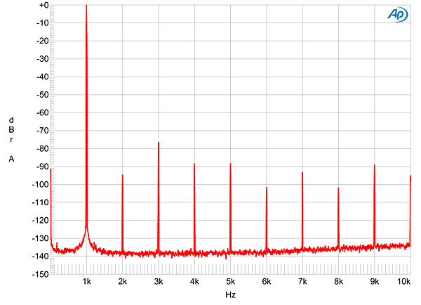

Further to the Anthem -- JA posted this chart of a 1kHz 100W FFT in the measurements section:

... JA posted this chart of a 1kHz 100W FFT in the measurements section...
Granted those are high levels, the harmonic content is still remarkably nasty. It reminds me - 100x scaled -of a Mullard 3-3 that didn't last long in my system.
