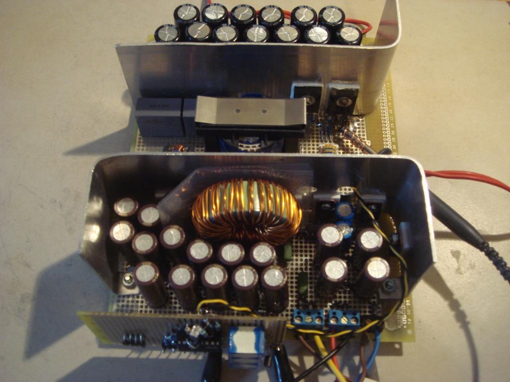

Hi Roberto,
you did not look seriously to my posted screen shot.
It shows multiple dynamic load steps.
The 900W are applied for 1.8ms, then 3ms no load, then again 900W for 1.8ms...
The red line is showing the AC-voltage of the rail with 200mV/grid, in order to magnify the load step response.
The loop gain structure is PD, no integrating portion. Consequently the rail saggs a little bit (less than 500mV) and remains there.
As you can see the regulation reaches the stable situation within few hundret us almost free of regulation over shoots.
If you are asking for more measurements - I cannot serve. I just designed and built a single proto for a friend and handed it over.
In any case I cannot involve deeply into public discussions about SMPS any more. My work has drifted more and more into this direction, so I must limit my contributions to a very basic level.
..to avoid misunderstandings.
At the beginning of the screen shot there is no load.
The dips of the red trace are the times when the smps is loaded with 900W.
The dip stabilizes fast with moderate undershoot and remains stable until the load is switched off. When the load is turned off, the rail steps up back to the no load level without any overshoot.
