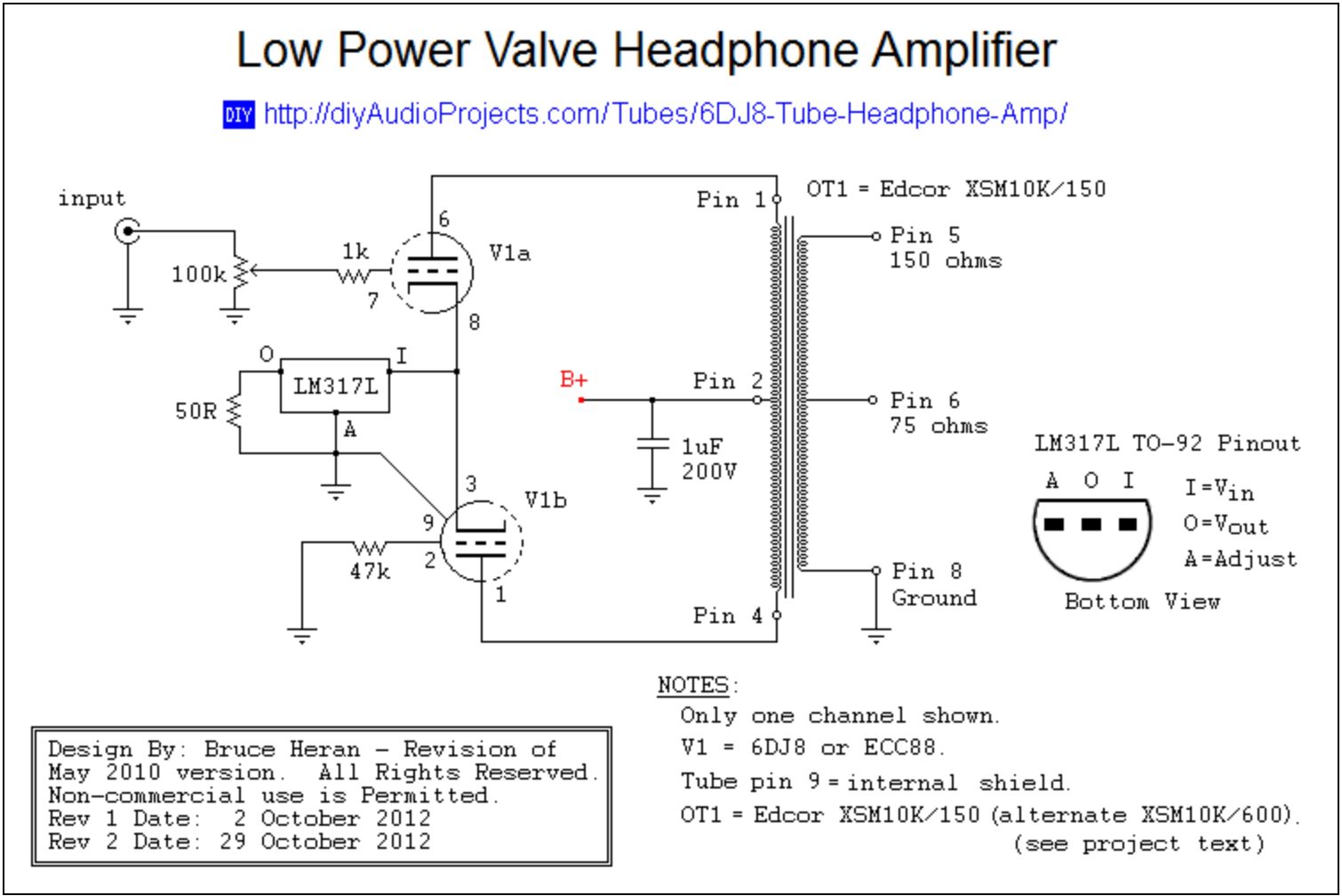

Nice design. LM317 delivers 1.25 V to 50 Ω ballast resistor, essentially independent of VIN, thus turning it into a constant-current source of 25 mA. The pair of valves are in charge of sharing that symmetrically a'tween 'em, resulting in near-perfect push-pull balance. The 10,000 to 150 Ω step-down transformer in turn has a √( 10,000 ÷ 150 ) = 8.16 to 1 ratio (on the 150 Ω tap. 11.5 to 1 on the 75 Ω tap.)
B+ not shown, but I'd assume it is 100 V, given 6DJ8 ( https://frank.pocnet.net/sheets/191/6/6DE4.pdf, midway down) has a 90 VA recommendation. Transconductance is 12,200 µ℧. 12.2 mA/V, translated from oblique units. Pretty sensitive to small input variations!
With a nominal plate dissipation of ²⁵⁄₂ mA × 90 V = 1,100 mW per valve, it is a bit of a pipsqueak, isn't it? Output power … maybe ½ to ⅓ W total? Cool!

I seem to remember using the LM317 in that manner and finding that its varying impedance with frequency was a little problematic.
I'd run the plate voltage about at maximum to allow for the most possible input voltage.
The O/P needs a very different transformer than the Edcor specified. I suggested a 10K:16 guitar output transformer, even better if it has a 4 and 8 ohm tap on that 16 ohm winding.

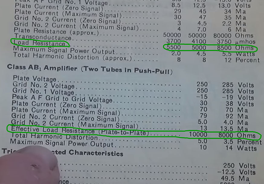

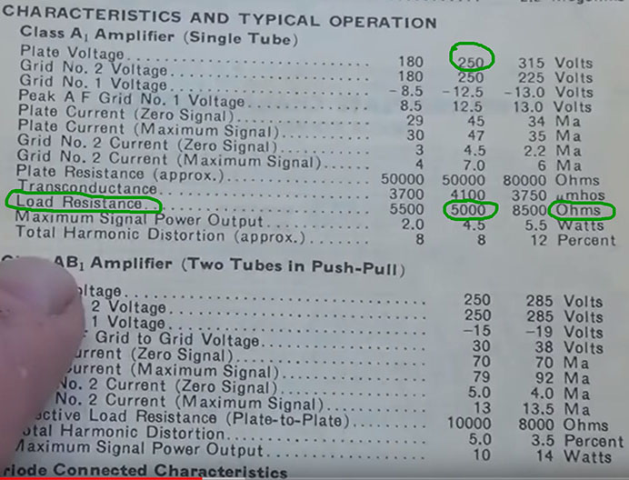

GoatGuy you've answered my question so clearly. Thank you so much. But that leads to the next question
What then is the "Load Resistance" of the 6DJ8 (or ECC88) ? The attached images. That is technical data of a different tube I saw in a youtube video but I've been searching for the same data for the 6DJ8 (or ECC88).
In other words, can I assume that the "load resistance" is the ohms that the tube prefers to see ...in other words, the optimal ohms that I want the primary side of the output transformer to present to the output pins of the tube?

attached is the data sheet which says something about 20,000 ohm
but It looks like the optimal ohms that the tube wants to be presented with depends on the voltage supplied to the tube, right?
Attached is the schematic which says the tube will be fed 135 to 150 volts. Based on that, what is the ideal ohms rating of the primary of the output transformer?
I know the schematic calls of an output transformer with primary of 10,000R and secondary of 150R but I'm trying to not buy another set of headphones due to budget. I really like my Senheisers anyway. So i'm going to go search for the right output transformers.

For triode at a given operating point, you have mu/amplification factor (volts into the grid gives volts out at the plate), Gm/transconductance(volts into the grid gives current out at the plate), and Rp/plate impedance (internal impedance of the tube).
Ideally a triode is loaded with at least 3x the plate impedance to provide a healthy balance between distortion and power.
The data sheet you posted shows a pentode operating as a pentode, and that's a bit more complicated than loading a triode and not all that applicable to the differential 6DJ8 headphone amp (thankfully!).
rp is 2.6k if Vp is 90 vdc....
so if you are using this tube in single ended, it wants to see 2.6 x 3 or 7.8k of primary impedance...
now, i f you are running push pull class A, then that is 16k primary impedance, and these guidelines are not written in stone...

I'm guessing he's running a lot higher B+, probably 150-200v. At 90v, there's only 1.3v between the cathode and ground. The LM317 requires a 1.25v drop to even work. In practical terms, it really requires at least 3-5v to account for internal transistor drops and feedback, depending on the in-out voltage difference. The 317 also has an equivalent internal impedance that drops with frequency, so some don't like to use it as a CCS. There are other ways to skin the cat - LM134 works at slightly lower voltages and has a slightly more consistent internal impedance, but has a lower current limit so you need to parallel several. Or several J510s in parallel would work.
