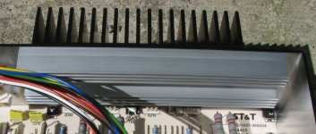

Heat Sink Details
4.25" wide x 2" high fins x 1" deep fins -- 19 total Black unit
[around 67 sq. in.]
plus
5.25" x 1" x 1/2" sub fin Silver unit
I've run the unit bridged mono into 32 ohms at 56 V (98W) fins were
untouchable so ran a high capacity fan to keep it cool. No bad smells
and still works. Undersized heatsink it is - - TIPs, Vbe transistors, and thermistor
all mounted (TIPs with screws and pads, Vbe pushed close with compound, and
thermistor pressed between heatsink and PCB with compound and foam.
65W max per TIP transistor = 260W total max needed to dissipate.

replace r118 & r218 with a 5k multi turn pot, wired as a variable resistor.
Change the heatsink for one with 4times the dissipation capacity.
try turning up the bias voltage by reducing the VR value (start at 5k). Monitor the Vre and the output device temperatures.
Nothing. . . .no change in voltage across emitter resistors! Ran it up to max.
Less is better - 1.8k created rising voltage
2K is around 5mV
2K is around 5mV
Installed 2 kohms (two 1 kohm) instead of 2.7 kohms.
Bias was 0 at 2.7 kohms.
Now bias is less than 7.5 mV (34 mA through 0.22 ohms).
Thank-you Andrew!
PS - will have to fan cool instead of bigger heatsink . . . the TIPs are just too close together!

I tried 1950 ohms which gave around 10mV, but the undersized heatsink was
around 100 F instead of 82 F at 7.5mV(68 F room temp). Once I set up the
forced air cooling I can up the bias. . . 15mV (68mA).
Why 15mV may I ask. . . seems there is a diminishing return. . . is this the point
between high quality reproduction and "I don't want to listen to this crap any more."

Checked bias - Room Temp 61 F (16 C)
Right - 4.5mV
Left - 4.3mV
Last Night the room was up to 71 F (22 C) and the right channel was
up to 9.1mV and left was 8.6mV.
The bias was double with a 10 degree F change (6 C change). Will the bias
continue to change - 18mV at 81 F (27 C) and 36mV at 91 F (33 C). At some
point the heatsink won't really be radiating the heat anymore.
Thermal runaway?
Maybe with the original value of 2.7k ohms will cause the bias
current at +100 F (38 C). to slightly rise.
Designed to not self-destruct due to the under-sized heatsink.
