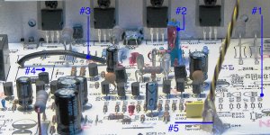

Here is version 6 of the mods. I have removed all 'extra' parts from
the board but left the outputs to the left channel. I think the drawing
speaks for itself. Testing for thermal runaway as I type. The physical
layout could be a problem; the bias transistor on the heatsink is between
the main channel NPN and PNP outputs; while the second pair of output transistors are off to the right. I will upload pics tomorrow. Currently the
bias is around 8mV to 9mV (36mA to 41mA on the 0.22 ohm output resistors). Room temp is about 68 degrees Fahrenheit (20 Celsius).
PS - the bridge version 5 didn't work as well as planned.
#1 removed components from unused channel
#2 bias 15-turn adjustment pot addition
#3 unused channel output paralleled into main output
#4 removed unused channel output relay RY2
#5 unbalanced input
Two jumper wires soldered under board to connect
the paralleled output transistors to the main outputs.
Protection circuit still operating.
Bias transistor Q111 is between the two main outputs (Q109,Q110).
The paralleled outputs Q109 and Q210 are sharing the bias transistor Q111.
Bias is set to 10mV +/-1mV (45.4mA) for each output. Total bias current for all output devices is 182mA.
#5 unbalanced input
