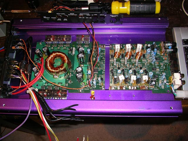

I've just managed to pull apart another broken car amp, and I've pretty much struck gold as I can use the SPMS from it.
Now, I've tested it at different voltages...
12v in = 26v out
13v in = 28v out
14v in = 30v out
15v in = 32v out
16v in = 34v out
I've rounded the values a little but you get the idea...
Now the amp module I want to power (41Hz AMP9) says the max voltage is 26v... So I'm guessing the 30v will be too high for it...
Now, I may try a diode or two on the input to bring the voltage down a little, or even lose a turn on the secondary windings, but I need to know if my car's electrical system is ever going to go over 14v at all?

It looks pretty cheap and nasty, but the rails are pretty ripple free, and the toroid has rather thick cables, meaning it should give a good amount of current...
Anyway, I simply took 1 winding of both of the secondary windings, and now I got 28V at 16v input, and 26v at 15v. This is perfect! 🙂

God knows what make it is...Perry Babin said:What make/model amp is it?
You may be able to regulate the power supply to limit it to 26v.
It's big and purple, and says on the front:
MOSFET | AMP-600
AMPLIFIER | 150W X 4CH
| 600W MAX

When you connected it to a load, did the pulses on the center legs of the power supply FETs go to straight DC (no pulses) equal to the B+ voltage?
They stay exactly the same on both sets power supply FETs, squarewave at 14v (B+ voltage) at 27KHz, weather load is connected or now.Perry Babin said:When you connected it to a load, did the pulses on the center legs of the power supply FETs go to straight DC (no pulses) equal to the B+ voltage?
I remeasured the output voltage again tho, it doesn't drop to 0v anymore, it drops to 6v when I connected a small load... 😕 I'm not sure whats causing this, but it probably explains why the amp didn't output anything thru the speakers...
The load I connected was a 24v fan rated at 750mA.
I couldn't really find anything with a lower load...
The secondary may be completely isolated from the primary. When you measure the voltage on the secondary, you need to use the secondary center tap as the reference (black meter lead in sec center tap).
Using the secondary center tap as the reference, do the pulses on the outer legs of the rectifiers maintain the same amplitude when you connect the fan?
Damn, I totally forgot about the grounds being isolated... I was using the ground on the input all along. 😱Perry Babin said:The secondary may be completely isolated from the primary. When you measure the voltage on the secondary, you need to use the secondary center tap as the reference (black meter lead in sec center tap).
The blob of solder in the middle of the output caps is actually the secondary ground. So I simply wired the fan up to secondary ground instead of the primary ground, and it starting whizzing away at 26v. 🙂
This was definitely a eureka moment for me, thank you! 🙂 I can now get around to squeezing the amp9 into the amp case.
